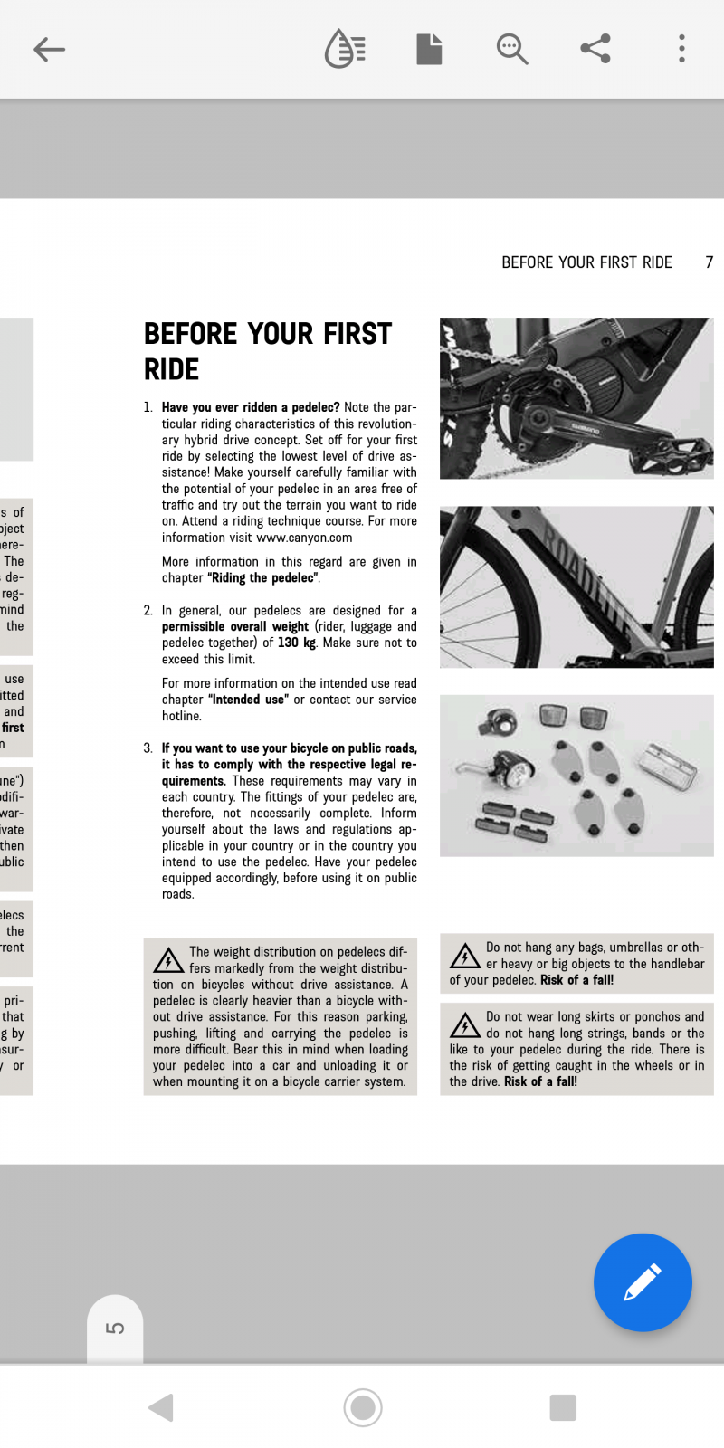

Get a Canyon instead ?.
Seriously though clarify with the manufacturer as you will find the general advice does not apply to all models / types of bike.

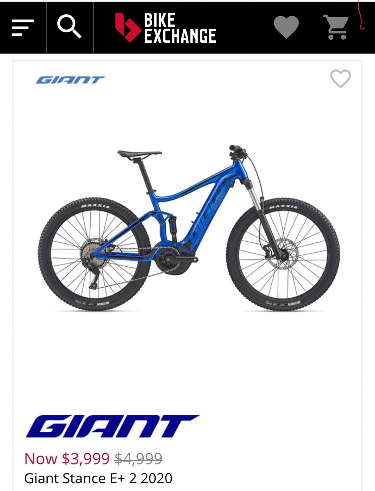

Entry level Haibike 120mm travel. Then look at Giant Stance. $2665USD here in Australia on Special
Well, unfortunately something like this would never happen here, and if it did they would disappear as soon as they were posted on stores websites. Sweden is notoriously expensive, so even if I were to say order one from Australia I would still end up paying almost 3500 to 3800 USD. And all because of import VAT.
