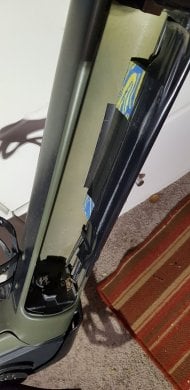

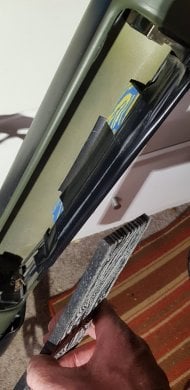

Shane(NZ)
Sep 4, 2019
179
140
NewZealand
Can you post up some pics of this Shane? Thanks.
A bit late I know but here is a pic of how i stopped my battery rattling. I have a strip both sides so battery is heald firm, cant m

Mine does't look like it will move in any direction.

It will very slightly it's all you need I put a post up on here about mine when the battery was in place there was a slightly bigger gap from the frame at the top on the battery cover than the bottom when I jiggled the lock about tightened it back up it closed the gap up so it was even all the way down the frame and the bike was fine after that
can you show me in my photo exactly what screws I need to take out? The two silver screws on each side?
MsO
Dec 11, 2018
265
195
swindon
Yes just loosen them off a bit there is only a small amount of movement but that all it takes tightened them back up and all was good but you might need to try it a few times it doesn't need much moving
