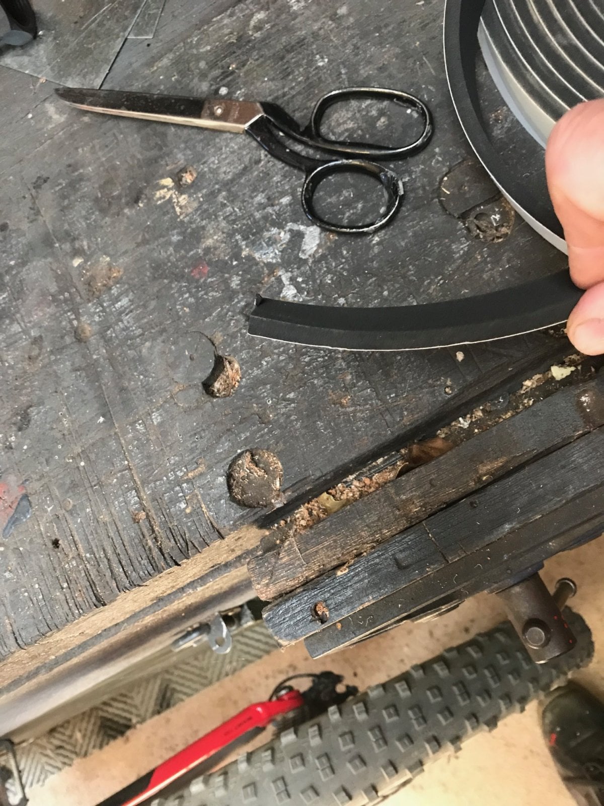

Trek Battery Rattle - how i fixed it .
My Bosch battery rattles like a bastard - i thought it was the forks , the front pads , the headset a brake lever ...No it was the battery giving me resonance on chattery ground .
So , heres how i ( hopefully ) solved it .
Couple of strips of foam tape on the inside of frame - sticking down the black plastic liner at top as it seems to wriggle about a bit .
Bit firmer to lock in but works well , so far .
trying to attach a couple of pics ...

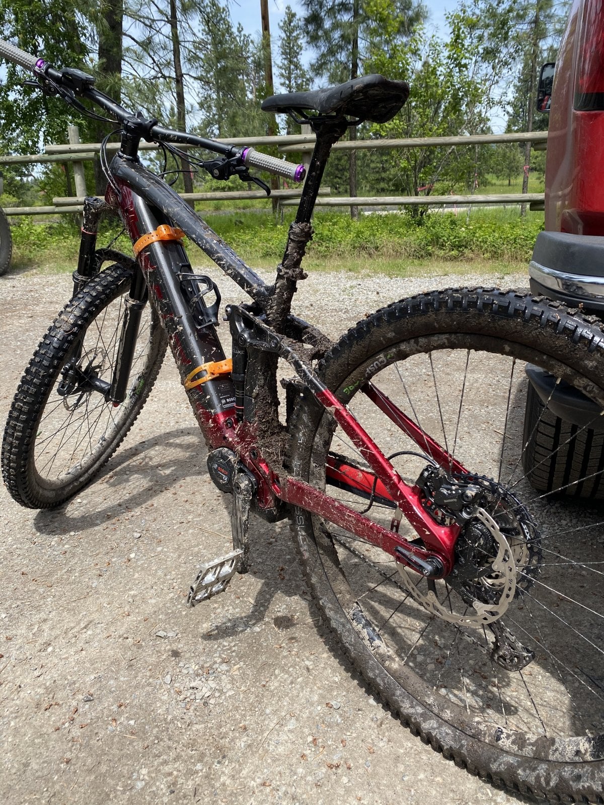

I like this idea better than velcro, where did you get the straps?
Random bike shop in ID on vacation. But all they are, are black diamond straps. Any ski shop in the country will have them. I did get my keyhole allinged properly. I did have a friend who's batter flew out on his rail 9.7
Thanks for that, I'm going to do the alignment thing too, but still don't really trust it, I'll be fitting those straps as well for peace of mind. It's a terrible issue to be having on an expensive bike, so many people on here have had the same problem or know someone who has. Also going to address the chainring issue as discussed in other threads...:rolleyes:
You need 2 specific tools.
1. Park tool cwp-7
2. Park tool bbt-18
