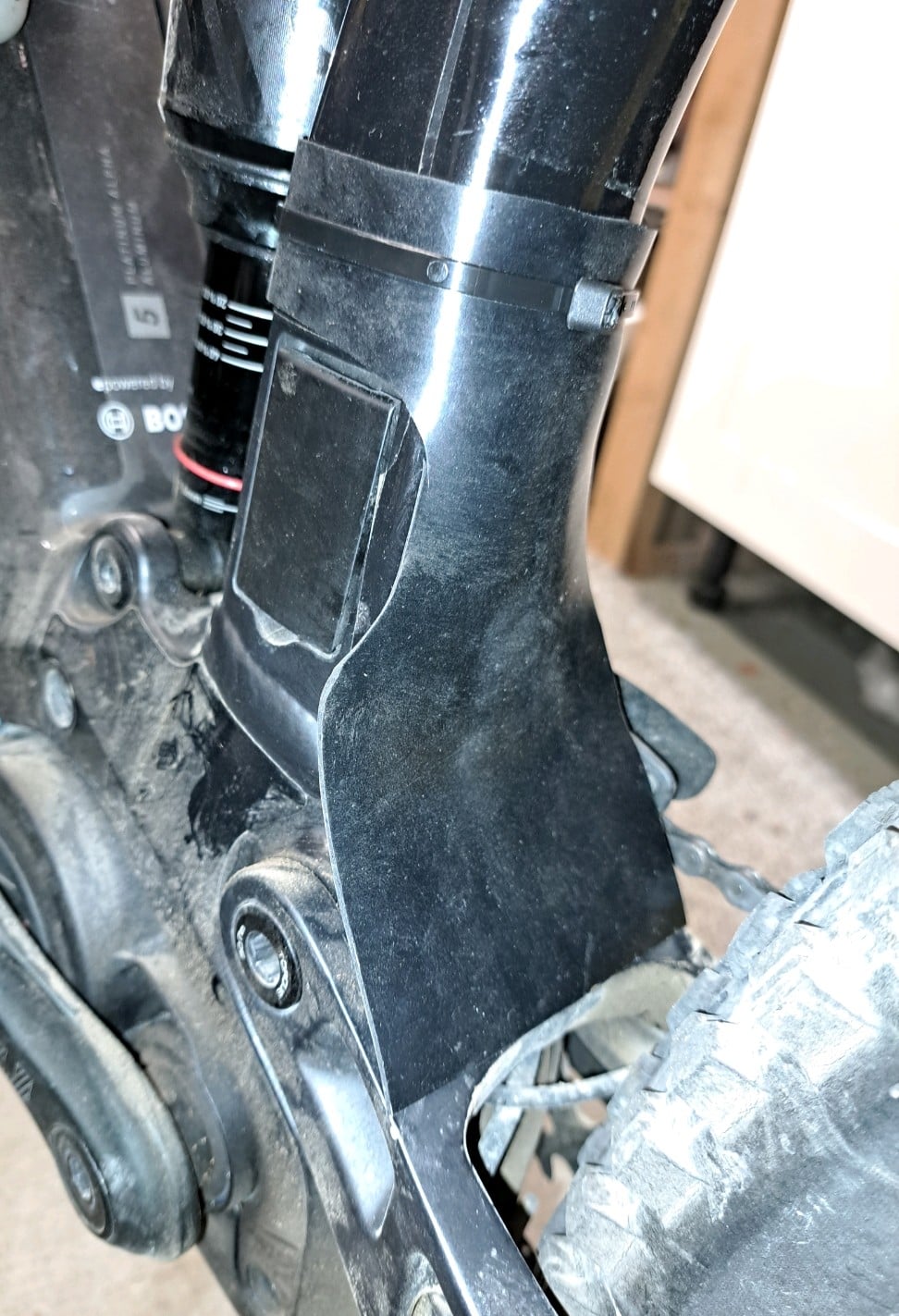

Cut a flap from 1mm neoprene to protect the rear pivots and fix it with a cable tie just above the charging port (obviously). Been posted before but worth reposting ...
