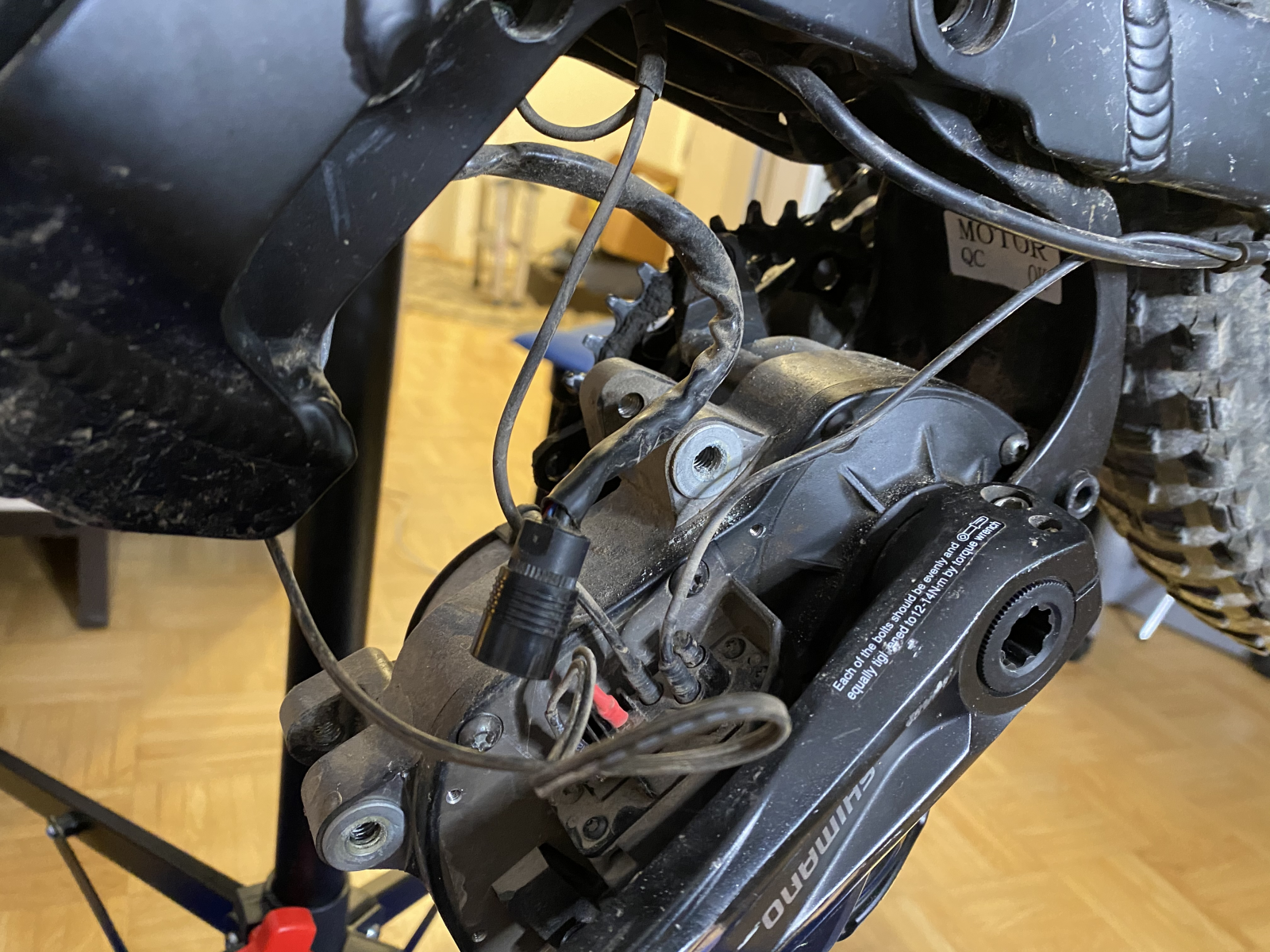

i have some good news,
the external 630Wh battery fits into the Spectral:ON without any problems.
I had to change the battery holder because the nose of the old holder was too big for the new battery.

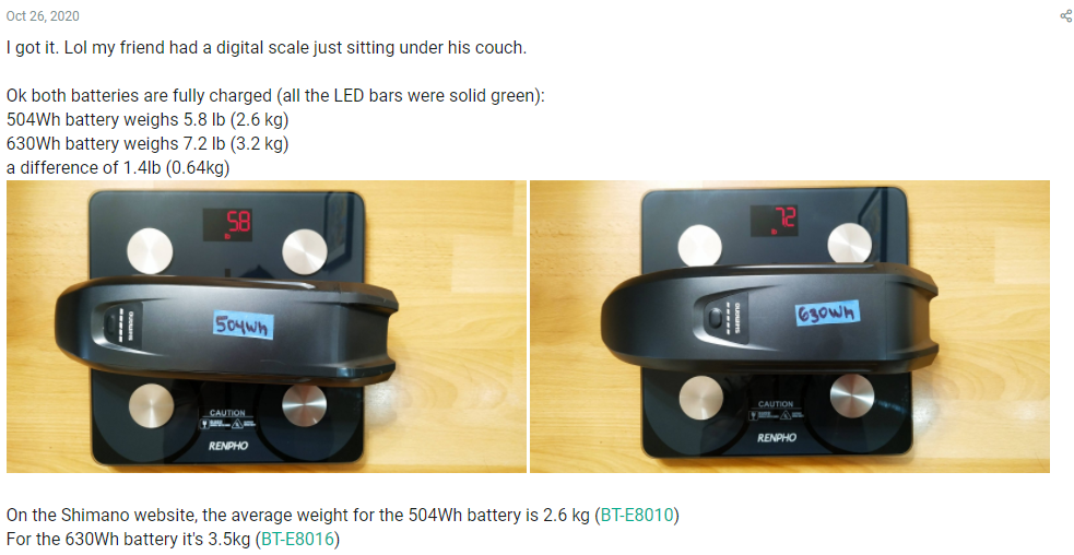

The new bracket is now partly made of metal, this was probably necessary because the 630Wh battery is 1kg heavier.
The 504Wh battery also fits into the new holder, can now drive very long tours with 1134Wh ;-)
norrit
Aug 11, 2020
30
18
Austria

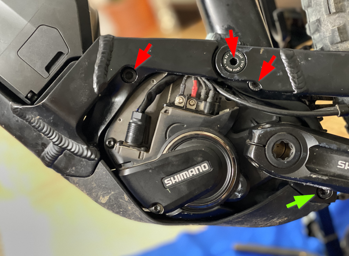

The conversion was a bit tricky, because you have to loosen the engine mount (remove 4 screws and loosen 2 screws) in order to be able to pass the cable of the new bracket behind engine.
The engine screws are partially covered by the swing arm and the chainring, so you also have to remove the rear axle ... that took me a lot of time because I made a mistake while assembling it and had to start all over again ;-)

Well that's very interesting news, thanks for the update! How does the extra 1kg affect the handling, if you've had a chance to ride it yet?
norrit
Aug 11, 2020
30
18
Austria
to be honest, I didn't notice any difference ... I don't think 1kg more weight at the center will have a negative impact on driving behavior either and it seems to be only 0,64 kg more weight

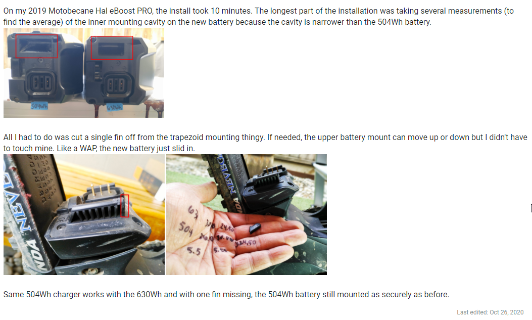

did you consider the option to mod the old battery holder as BikeTrailsAndWaggingTails did (pls. see the "Simano release new 630Wh batteries" post)?

I wasn't sure, but I also thought it would work ... if I had seen the post, I would have tried it too ;-)
the only difference is, the new lower Holder partly made of metal and therefore more stable

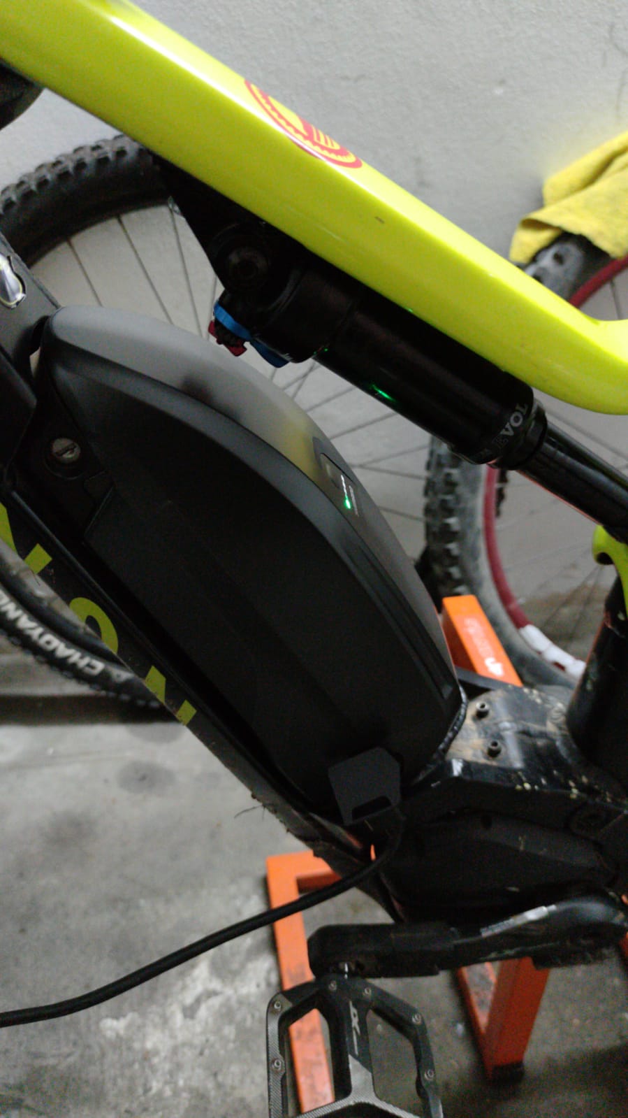

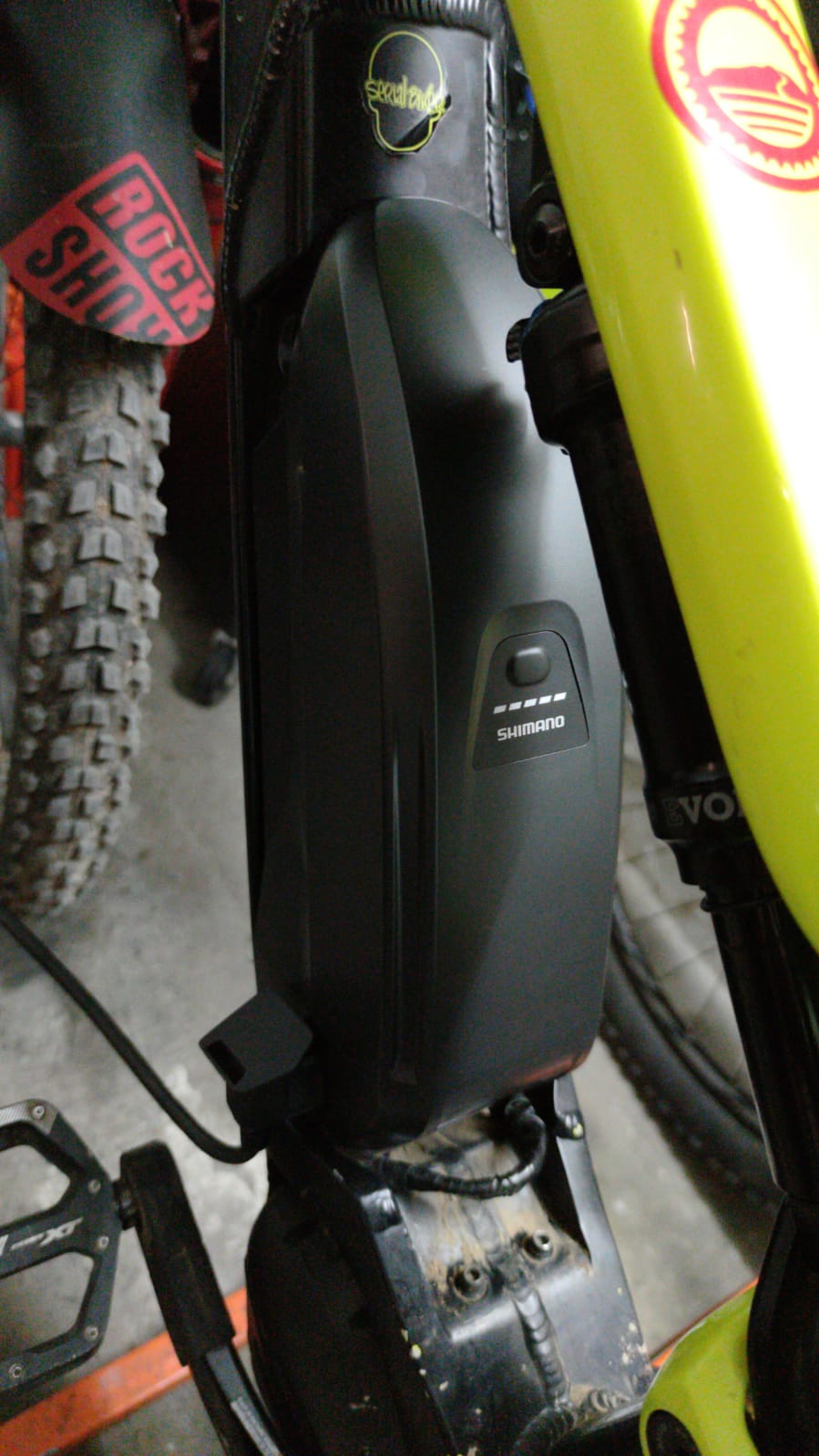

salve ragazzi, ecco il mio spettrale con la batteria 630 wah ho fatto la modifica in 5 minuti tagliando un pin dal vecchio portabatteria confermo che non ci sono problemi con la vecchia batteria 504 wah quindi potete usarli entrambi.
Devi togliere il porta borraccia e usare il mono originale ho dovuto togliere quello con il piggy back perchè la batteria è più grande

Thanks for the pictures Gofrank.
What Size is your bike?
