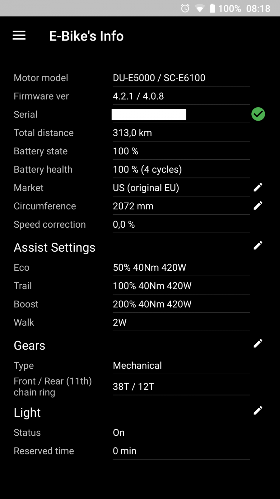

I recently got an electric city bike (Merida eSpresso City 300 EQ Electric Hybrid 2020) and immediately got STunlocker (I'm not a warranty-keeping-kind-of-guy) and it's great!
Having a bike that cuts out in a crossing is right out dangerous!
The bike shop claimed it was updated to the latest firmware, but I guess they don't know what's what (they also claimed it had no Bluetooth).
So, I'm on an older FW, which explains why I could derestrict most settings.
To my questions; I can't increase the torque levels more than 40 Nm and boost resets to 191% every time I turn of the power.
Is that expected or do I need to up/downgrade to a more derestrict-friendly FW?

That's the Max torque for that motor, you may be able to remove the max motor assist cut out speed but you'll never be able to get more than 40nm of torque

1. Your e-bike has a Shimano E500 drive unit, which is rated at 40Nm maximum. The app won't magically add more torque, it just manipulates the power curves and limits.
2. FYI the app isn't "officially" compatible with both the drive unit you have and the firmware you have, so you're on your own there in terms of upgrading/downgrading firmware.
