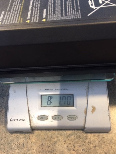

The current battery is just over 8 lbs … adding a 10lb battery (assuming here) is where I am struggling a bit :cool:

Review on PB for the new Kenevo may shed some light …. looks like Rusty and Doomanic may be correct that the batteries should be interchangeable and about 2 lbs heavier. Referencing the current weight of the 540 may put it just over (or close to) 9 lbs for the 700wh version.
"Apart from the Specialized 700Wh M2-series custom battery that the Kenevo Expert comes with, a 500Wh battery is also available. Both use the same amount of cells, but different types, with the larger battery extending your bike’s range by about 40%. The 700Wh battery uses the 21700 type, weighing in a 3,840g, and the 500Wh model uses 18650 cells and is said to weigh 750 grams less. It’s possible to swap between both batteries."
Albeit 3840 grams (the 700wh specialized battery) equals 8.45 lbs. I am assuming the extra weight in the YT battery is due to the mounting bracket ??
If they can redesign the mounts, perhaps they can bring the latest battery in a bit lighter and close to the Levo weight ... hoping (y)
