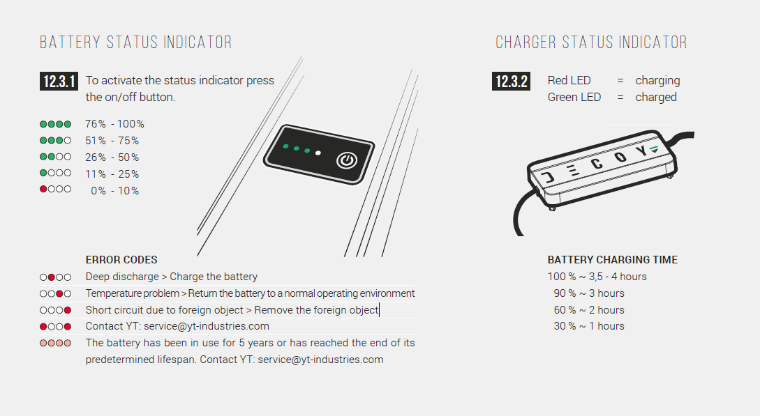

Hi Guys, I'm having problems with my Decoy. The Shimano Steps logo flashes on & off but it never gets to the main screen and won't start.
My LBS think it's the battery to motor connection. However, I've just noticed that the charge level lights on the battery flash on & off too. This has me wondering if the battery is at fault.
Here's a link to a video showing my flashing battery lights:
YT Decoy Battery - does yours flash?
Please can someone kindly check if their battery flashes like this too?
Thank you!!

My battery does not flash. In the Decoy manual there is this note for error codes:
