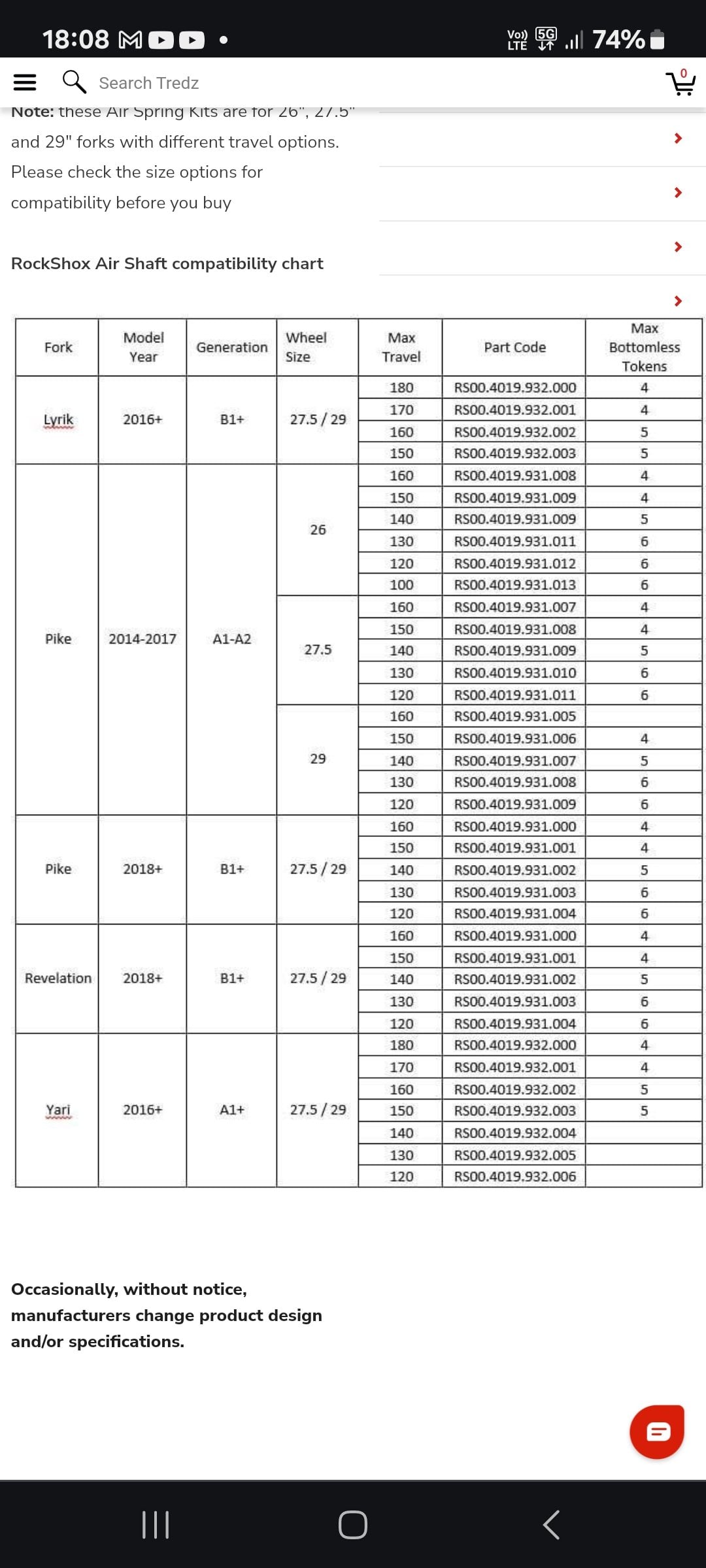

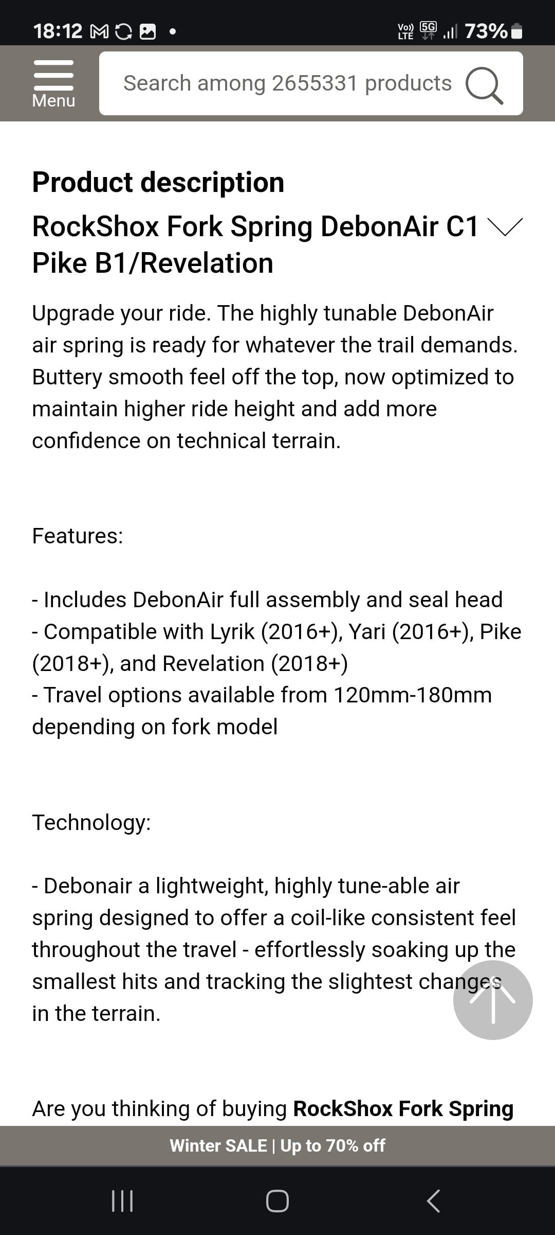

Thanks for the info. The air shafts are cross compatable between lyrik and pike, but I don't know if the damper units are the same.
