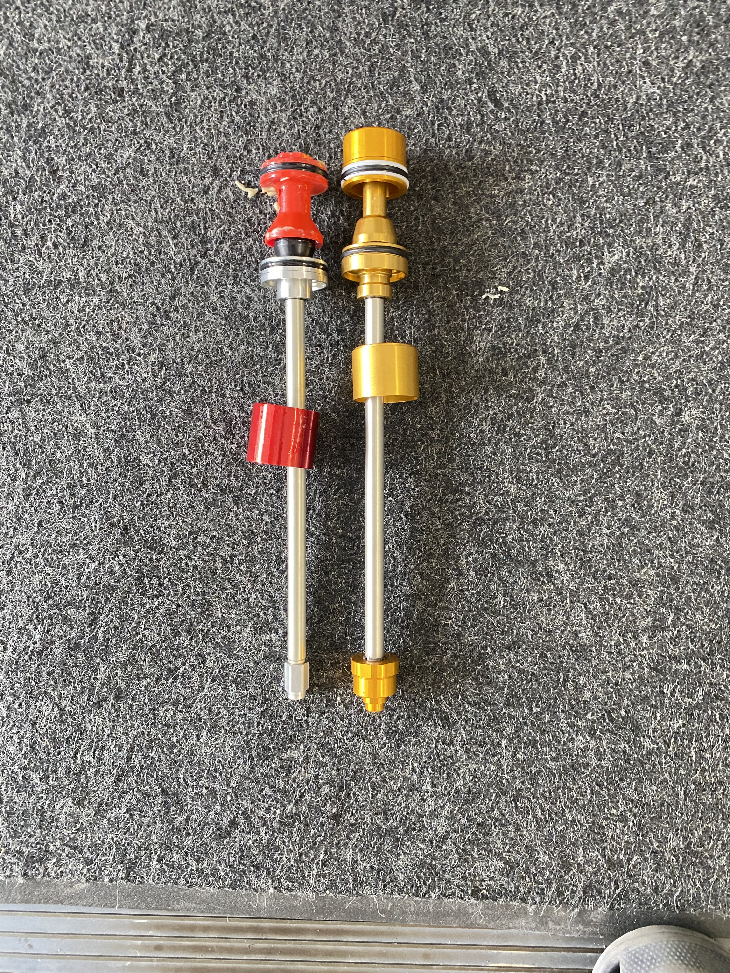

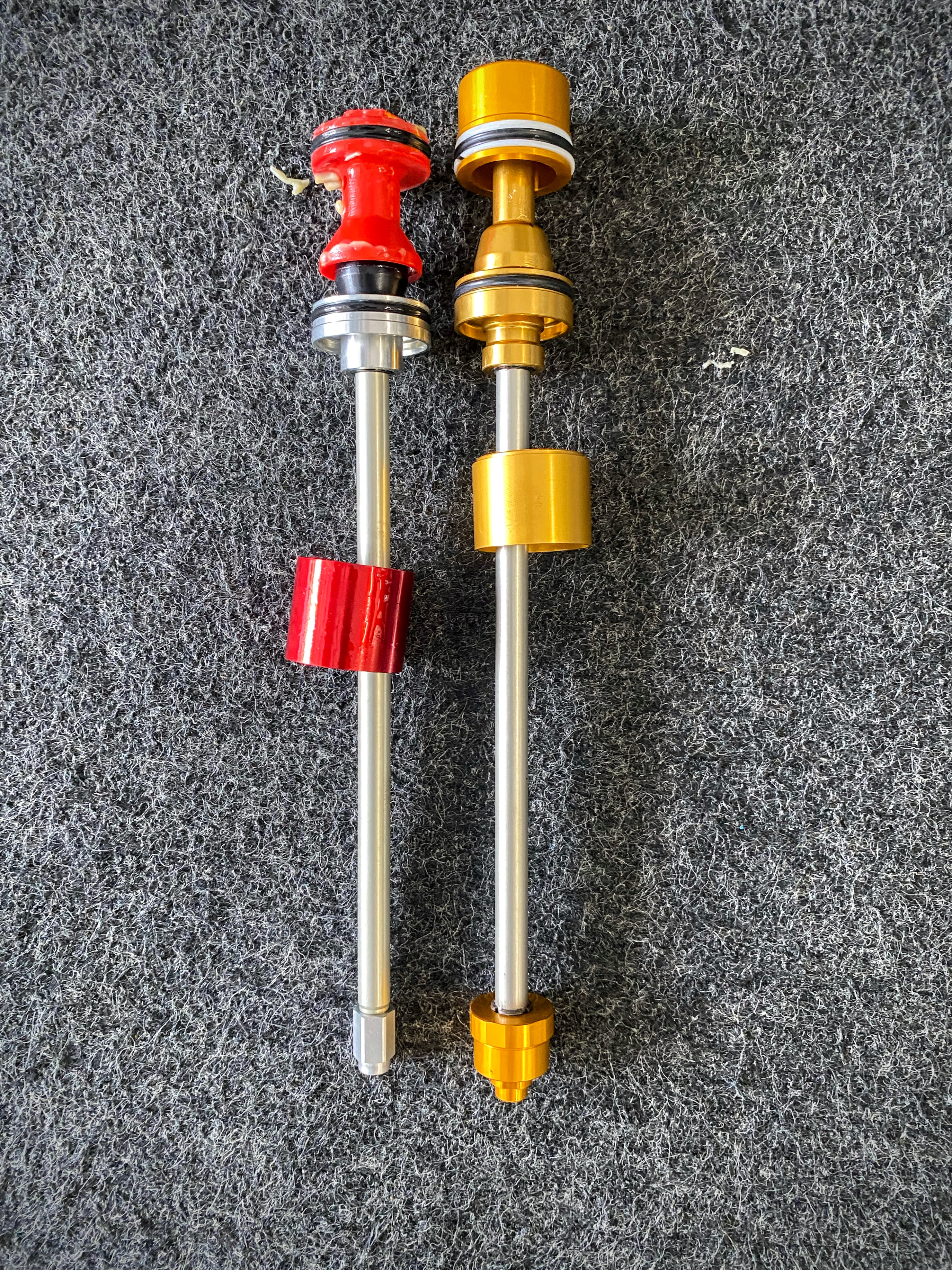

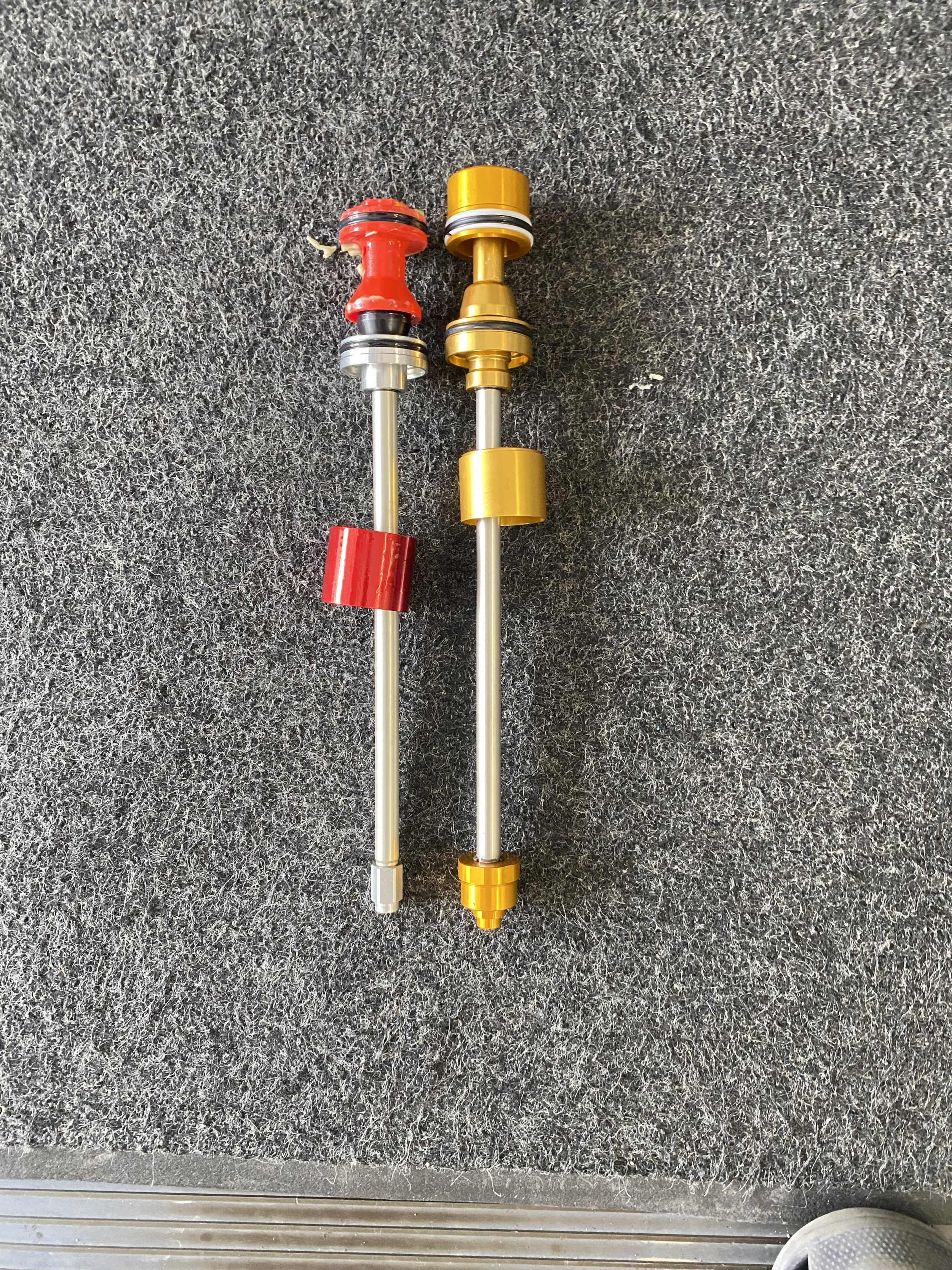

Swapped out my 180 mm Lyrik for a “new” but 2021 MY Zeb over Labor Day Sale. Love/Hate relationship so far. Tracks so much better through ruts and everything BUT even at much lower psi that recommend I have migraine and arm and wrist pain after every ride.
Lowered PSI from 60 to 50 to 40 then added 1, 2 then 3 tokens to not bottom out. Somewhat better.
Gen 1 Kenevo has 180mm Ohlins coil with 30% sag, so even at 40 psi Zeb was only at 15% sag and the bike feels very unbalanced. So….
Installed a new 190mm Airspring with Buttercup and running 38 psi, 3 tokens and the new airspring seems to add a metallic 4th. It is still very stiff but much more plush. Probably mostly just due to lower psi not the new airspring but it was just hard to wrap my head around going that low. But looking inside the positive air chamber, it is massive even with tokens and has to accommodate so many travel lengths. On my first few test rides my hands and arms are sore but severe migriane after every ride is gone. Love the 190mm so far too. Slackens it out a tad and I prefer a more upright stance. May bite me a bit on extreme steep climbs but I probably have no business trying that anyway. My rule generally is if I can roll down I can attempt to climb it.

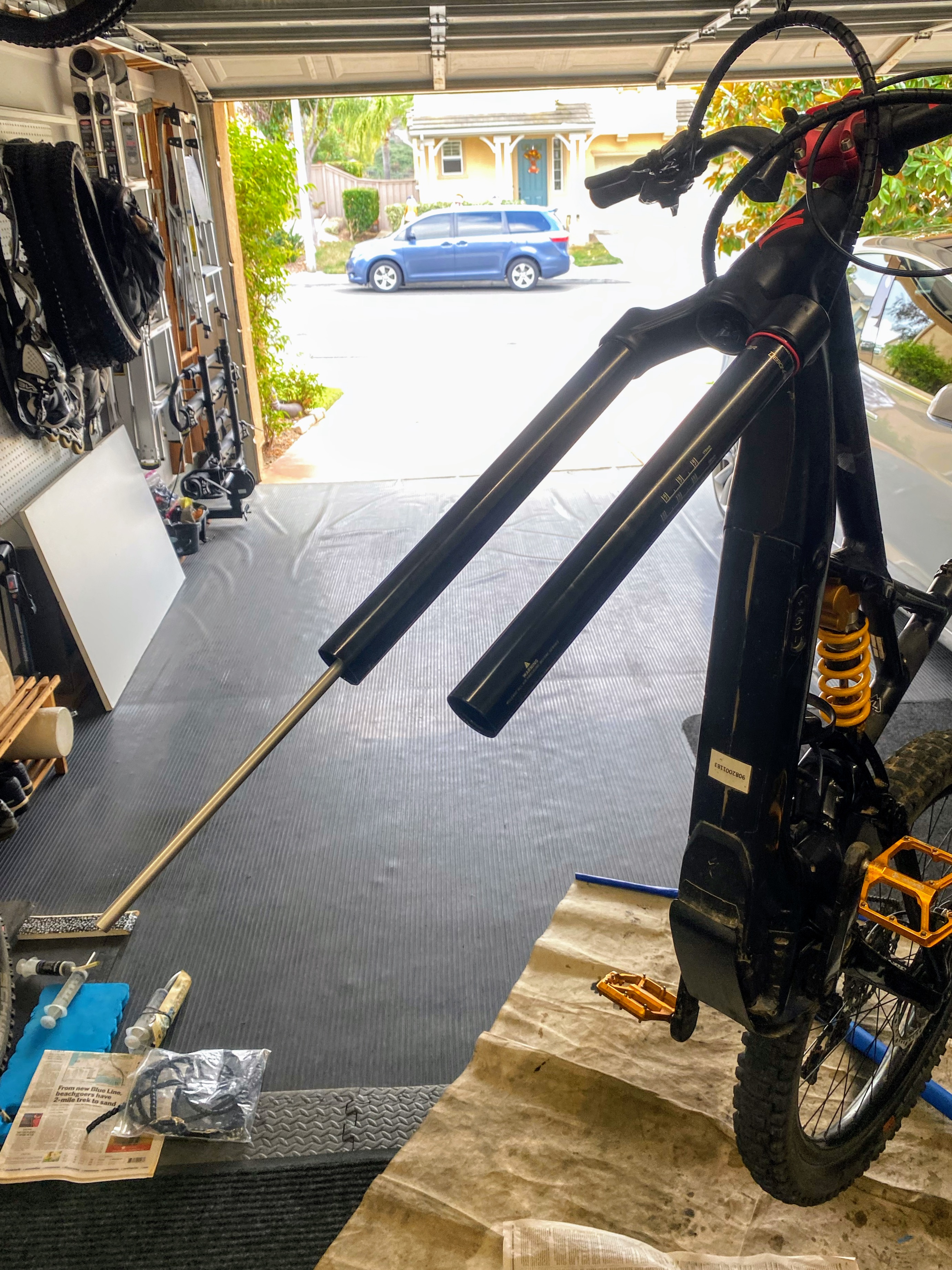

I was struggling with my fork, running lower air pressure and still not bottoming out and not feeling as plush in the first part of the travel. I went on You Tube and found a video of a guy that would push his fork about 20mm into the travel before tightening the shaft bolts so it would have a bit of negative pressure in the lower legs. I did it with my 23 Ultimates before realizing I could do the same thing with the lower leg air bleeders, made a difference in the way the first part of the travel felt and was closer to the recommended air pressure settings in Trail forks. With the Debonair + you don’t go off sag settings as per the manual.

The bolts that attach the air shaft and damper shaft to the lower legs. You could also just use a tie strap between the seals and stanchions.
