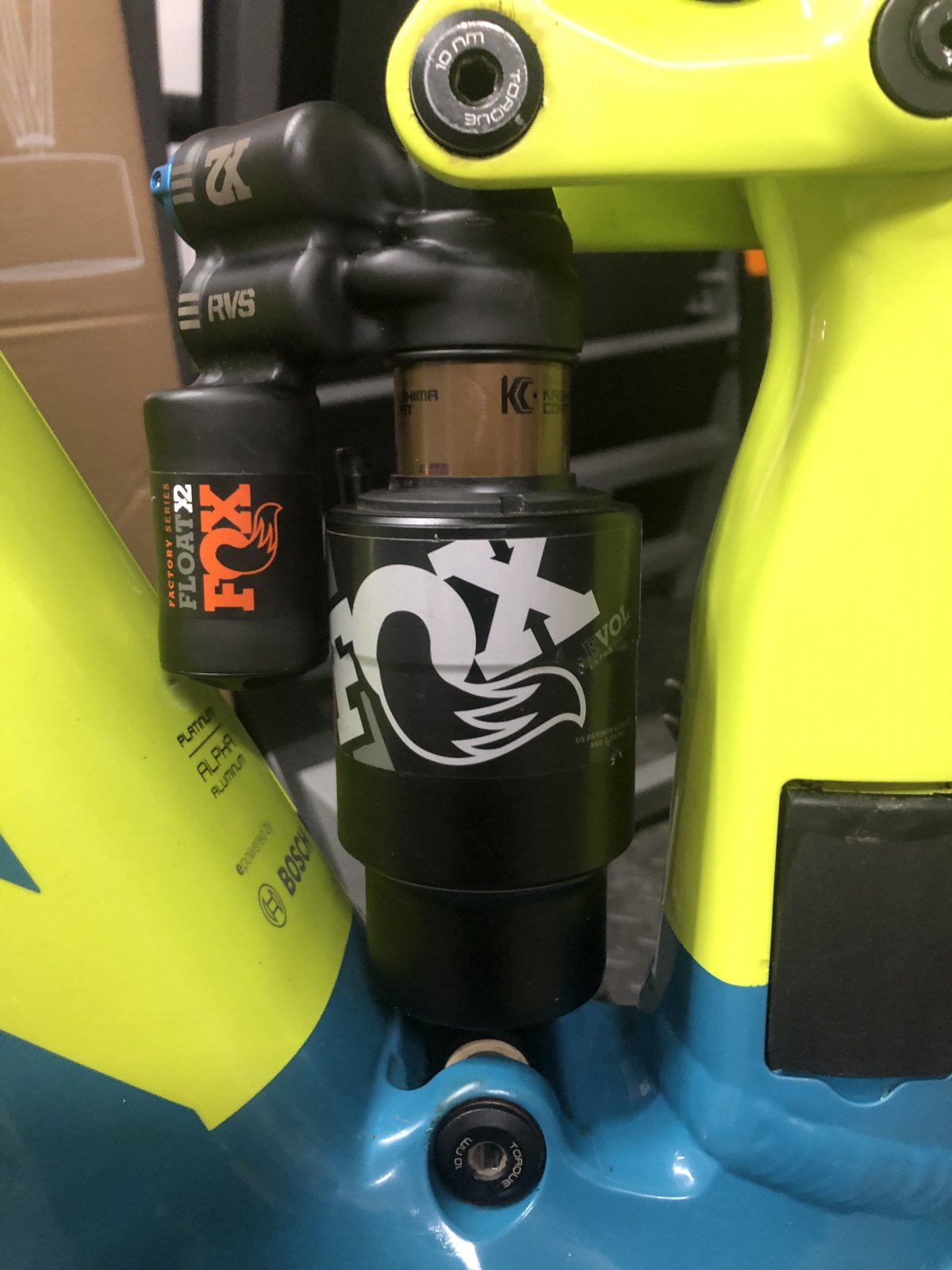

I tried a 230x65 2019 X2 on my large rail knowing it wouldn’t fit but to try and work out how close it would be so i could get the stroke reduced accordingly.
conclusion was i needed about 7.5mm to come off the stroke so would take it back down to the prescribed 57.5 stroke, but in the end even at that it felt a fraction too close for comfort.
now have a 2021 230x60 X2 due to arrive next week which i believe will fit with the 21’s shorter reservoir. We’ll see!!

Cheers @Jamo Very useful to know.... on the X2 Clearance of lack of it.. ? just wish they fit hassle free....

keep us updated on the 2021 x2 fitment.
I may consider one for my XL rail.
