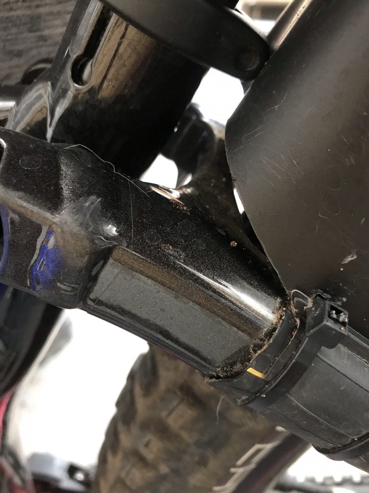

Marzocchi Bomber CR & Z1 Coil. There’s been some talk about whether the Bomber CR coil fits the Rail
I just made the conversion & got the Z1 Coil as well….it fits & there are no issues w/ it hitting the DT at full compression on a Size XL…it’s really close but doesn’t hit. I’m 220lbs and did a full WWE jumping from the ropes move on it w/o the coil installed and it didn’t hit
4 rides on it in the real world so far and no issues w/ it hitting the DT
Huge upgrade to how the bike (2022 Rail 7) feels on & handles the terrain compared to the RS Deluxe Select + and Domain.
So pumped to be riding like it’s 1997!

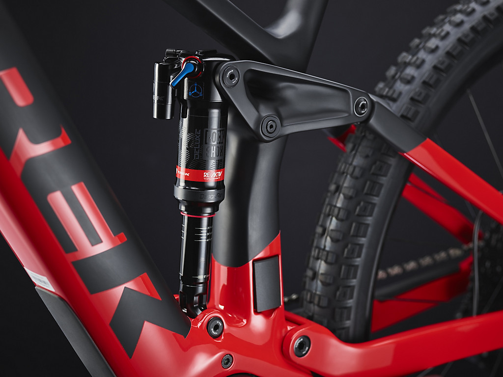

Just installed a super delux ultimate coil 230x65 on my 2021 9.8 with a SAR 600lb SAR spring.
It feels a little stiff. I need to ride more. I’m coming off a 2021 dhx2 with the same spring it felt softer.
Anyone try the new rockshox ultimate coil yet? Btw it clears fine on my large.
