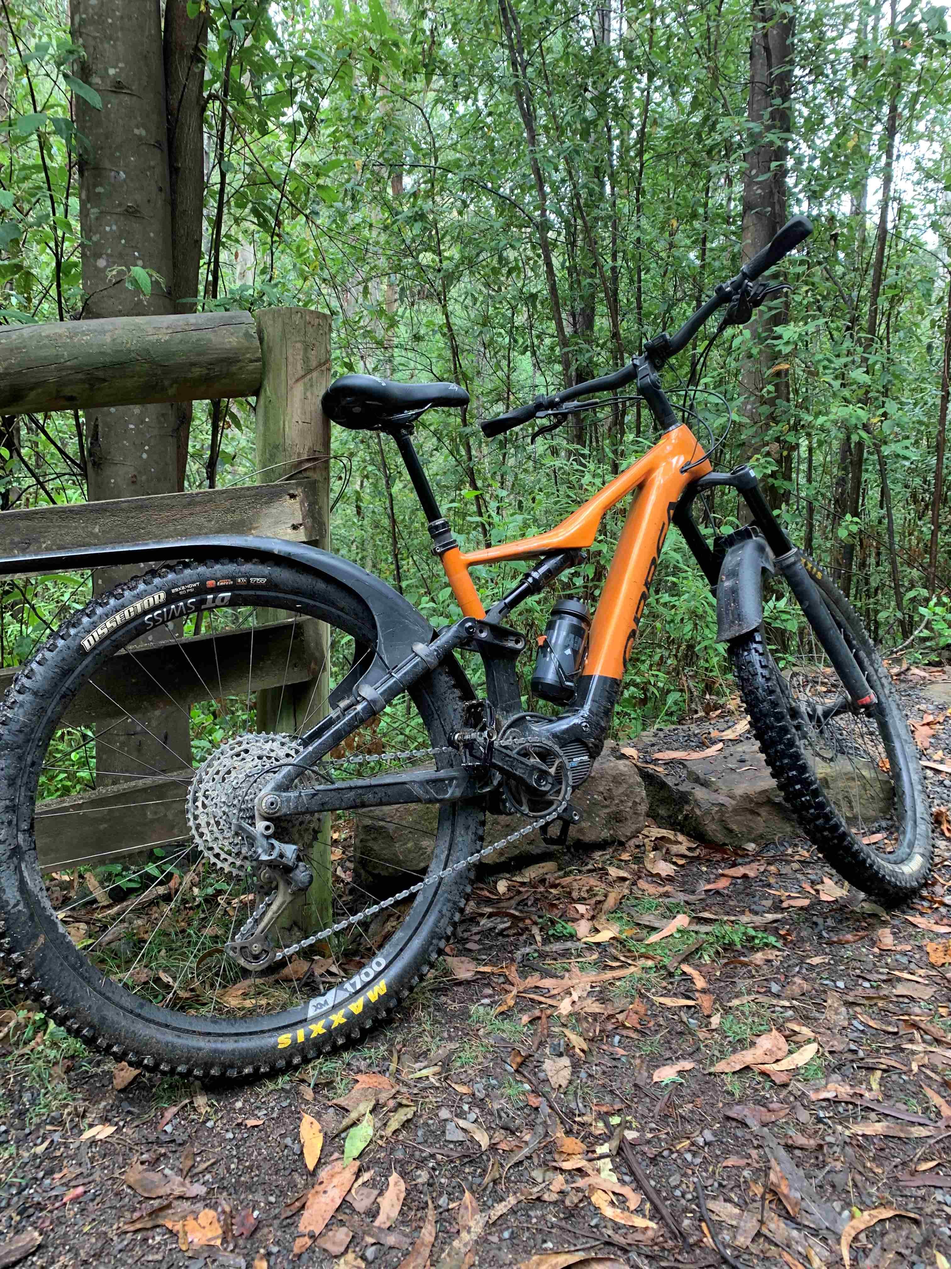

I like my 2022 H30, 21kg as pictured (minus the bottle) and has had the standard EP8 firmware installed from new. For a reasonably light trail bike there's not really a better deal than a heavily discounted Rise H30.
The only problem I've had was the unbranded rear hub failure - replace it within 200km to avoid getting stuck if you get the unbranded hub.
