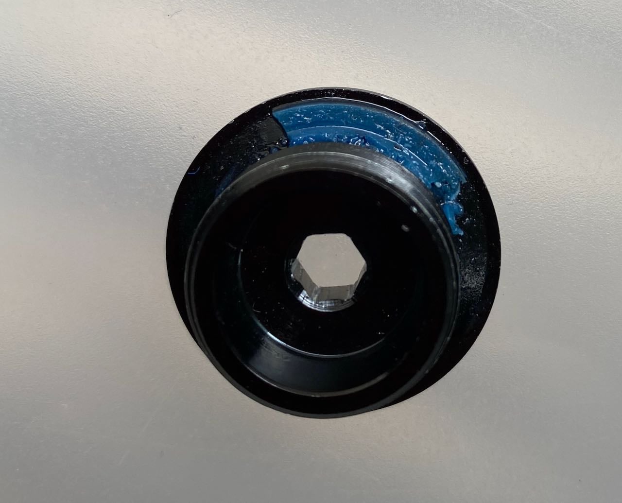

This is beyond a joke now @e*thirteen Components . Stripping parts of our new his'n'hers Rises to invisiframe and swap out brakes. First one had a *lot* of blue thread lock on the cap (enough that I had to pick it out of the edges of the crank and splines to get the crank off. Second bike, undid pinch bolts first and that cap should come out easily but so much thread lock and cheese like aluminium the hex hole just completely rounded.
Obviously I'm going to need a replacement cap but in the short term *&*( knows how I'm going to get it out of there. Any suggestions anyone?
Every thread lock I've had says you only need a small drop on the threads - on the one I've got off so far there was thread lock covering almost the entire flat surface of the cap underneath - basically supergluing the cap and the cranks to the axle is NOT the answer.
Looking at the non-drive side whoever fitted the caps pretty much rounded off the hex when they installed it. must be massively over torque spec - a 6mm hex key is rattling around in it.
Where did you buy it from? I'd expect them to be the ones who assembled it, not e-thirteen. Also saw you mention the red threadlock in another post ...

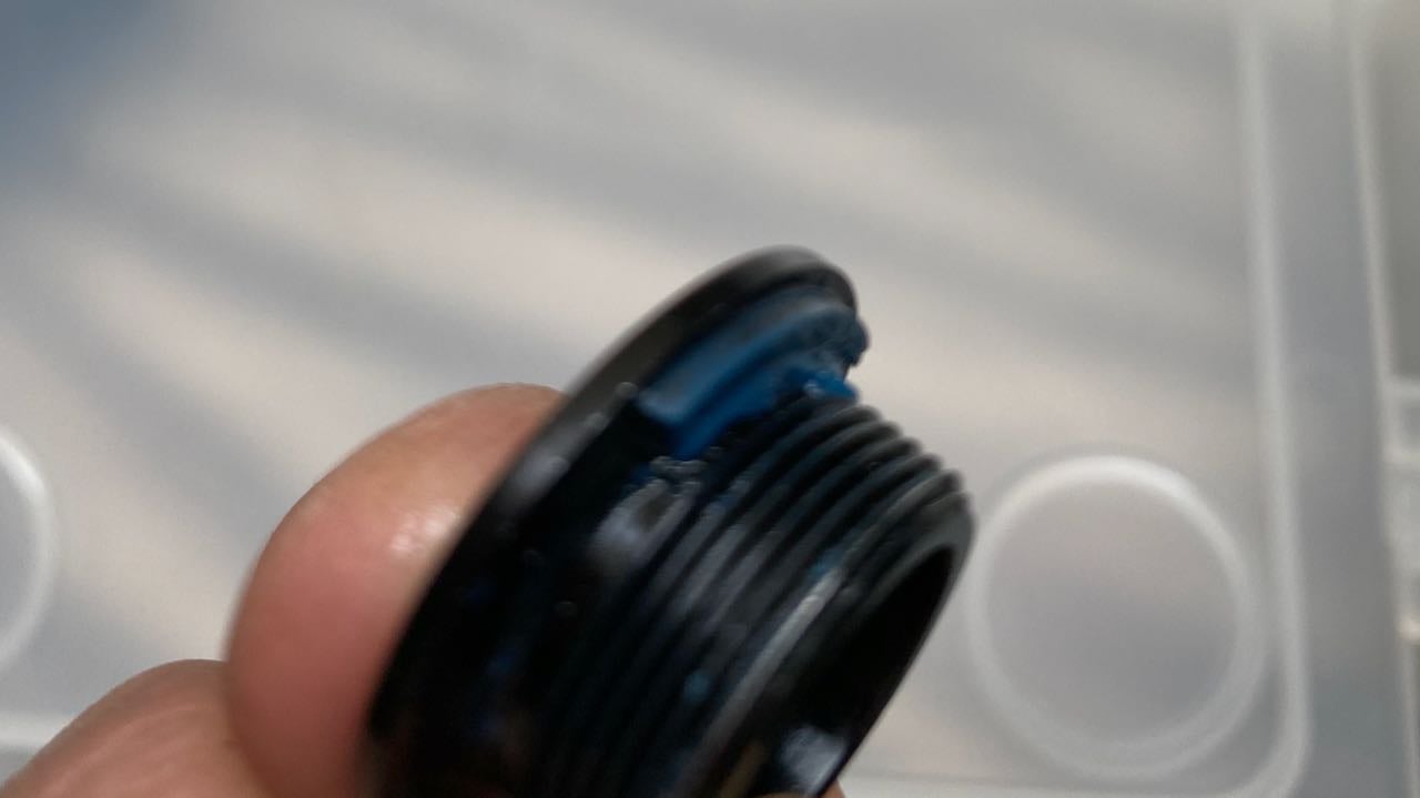

This is the one of 4 caps I've actually manage dot removed, and I only thought to take a pic AFTER I'd chipped off some of the thread lock that was on there.
Drilled out the centre of another one, tapped it, and have red-Loctite'd a bolt into it. Will see if that gets it to shift (and will then do the same to the remaining two.
That indeed looks like ham-fisted installation, but as others have pointed out, e*thirteen should not be the subject of your ire on this. The first place to complain is the shop you bought the bikes from, which is more than likely where the over enthusiastic application of thread locker and excessive tightening torque occurred.
