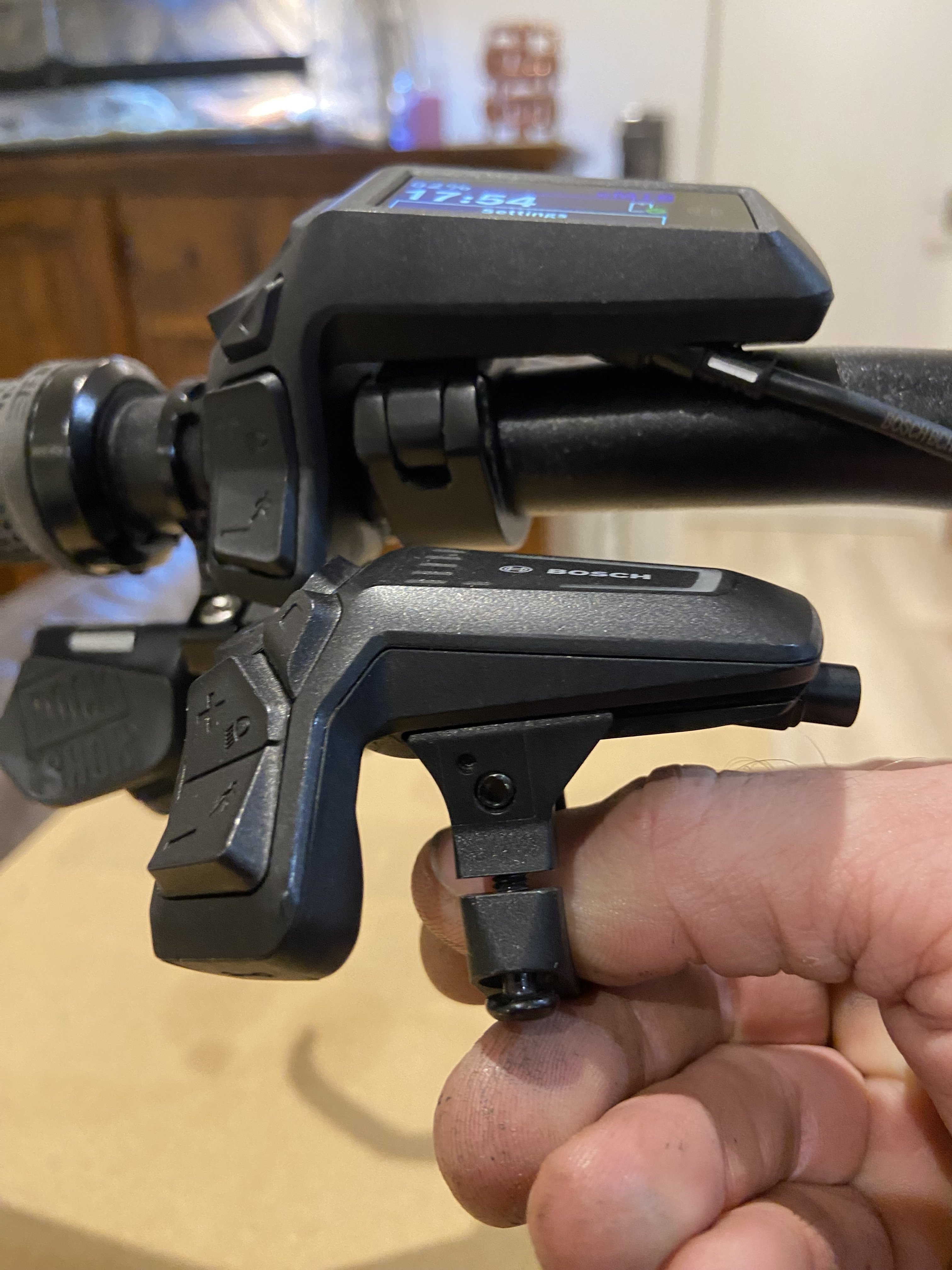

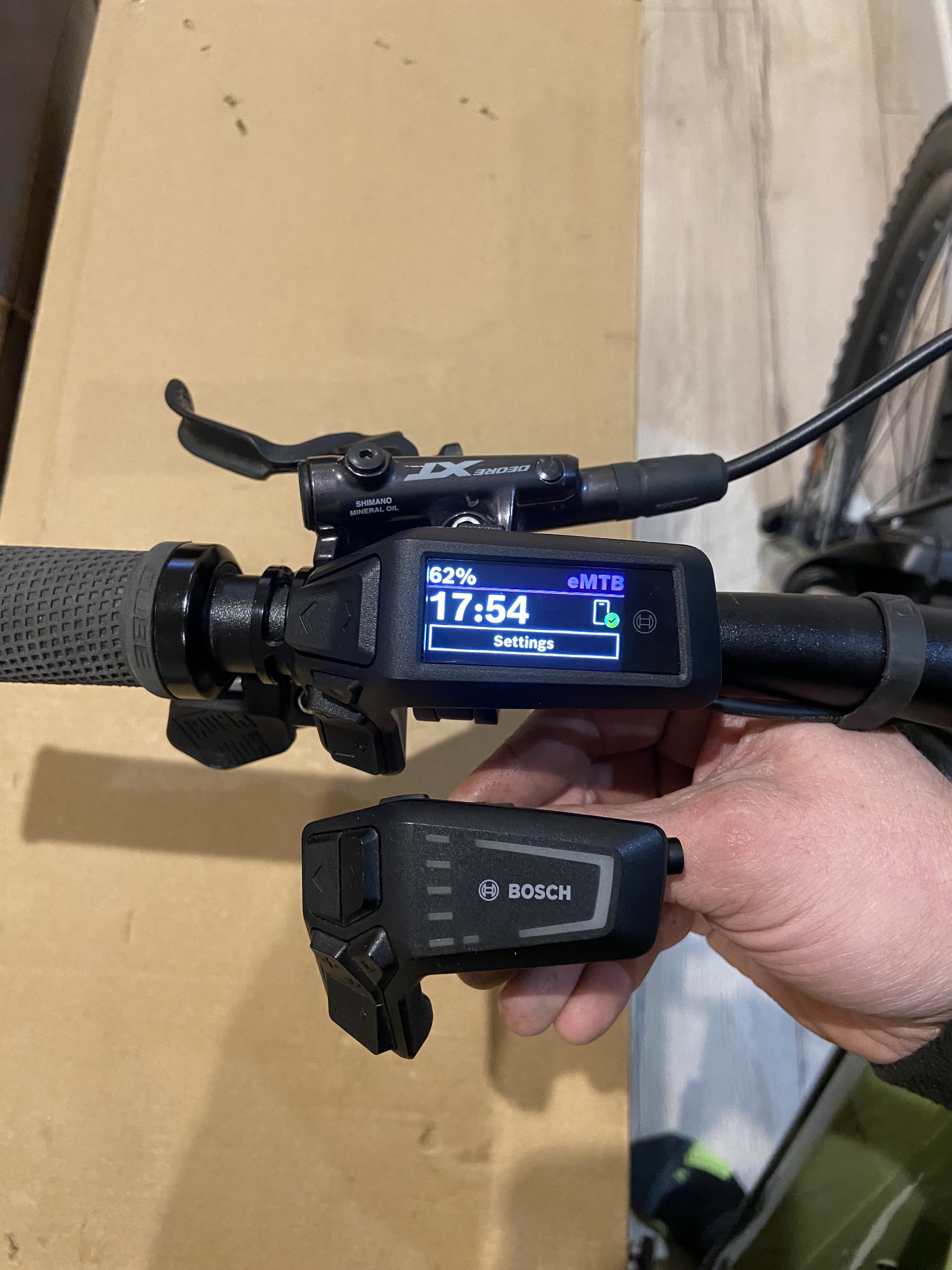

Just had mine fitted today. It’s a little chunkier than the led controller and doesn’t have any adjustability for mounting. Seems to do everything the led controller/kiox combo does other than navigation.
The motor ID has to be transferred to the purion. At this point the controllers can be swapped out and the bike will work. But only one controller can be registered to the flow app at one time. You have to reset and remove the bike from the app and reconnect with new controller. Kiox 300 can be linked in and out whenever you want.

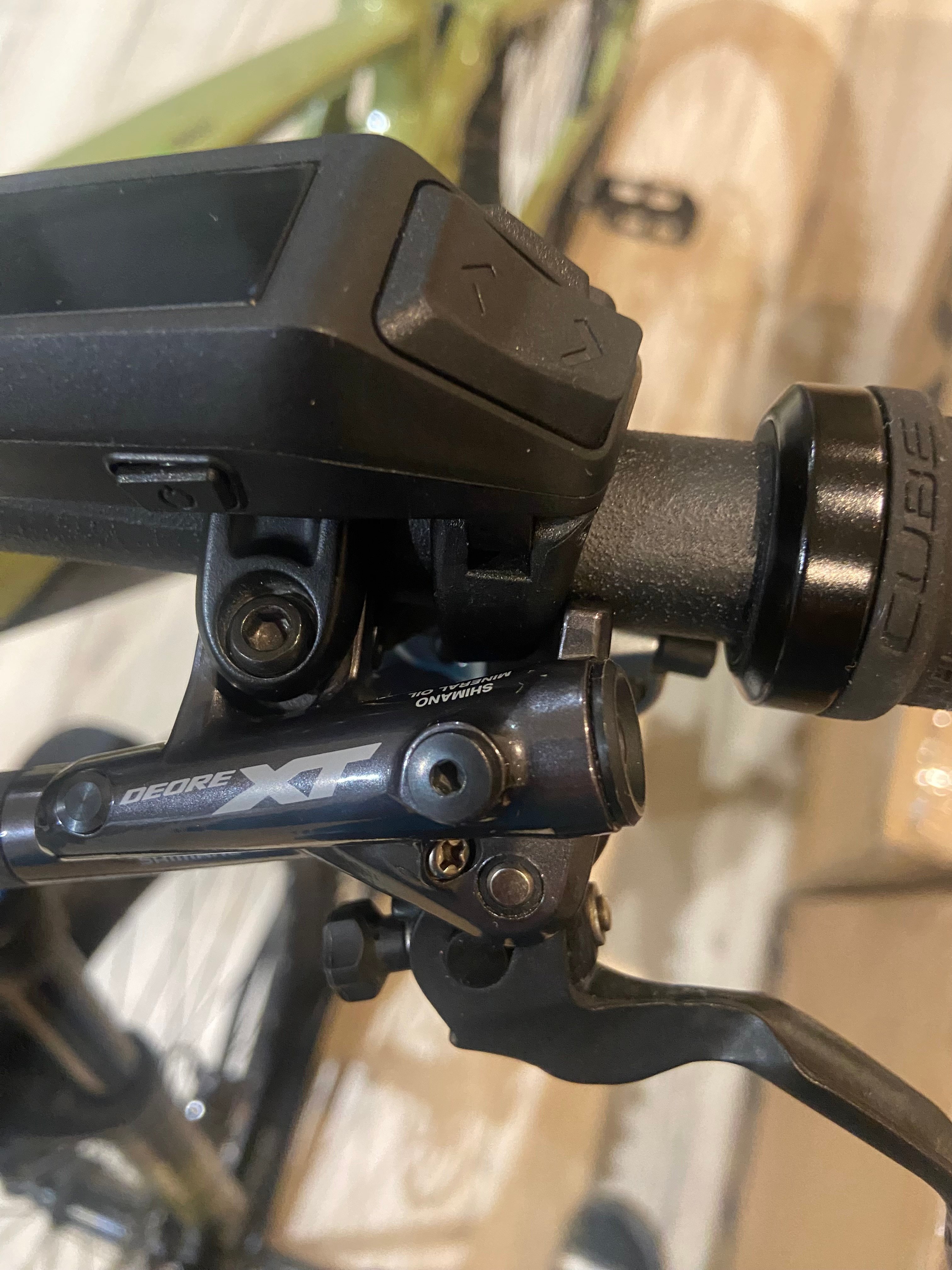

Question on the Purion 200.. can the mount be narrowed to fit in the xt brake gap? Either by filing or milling the width so it will fit in the brake gap.
Thanks

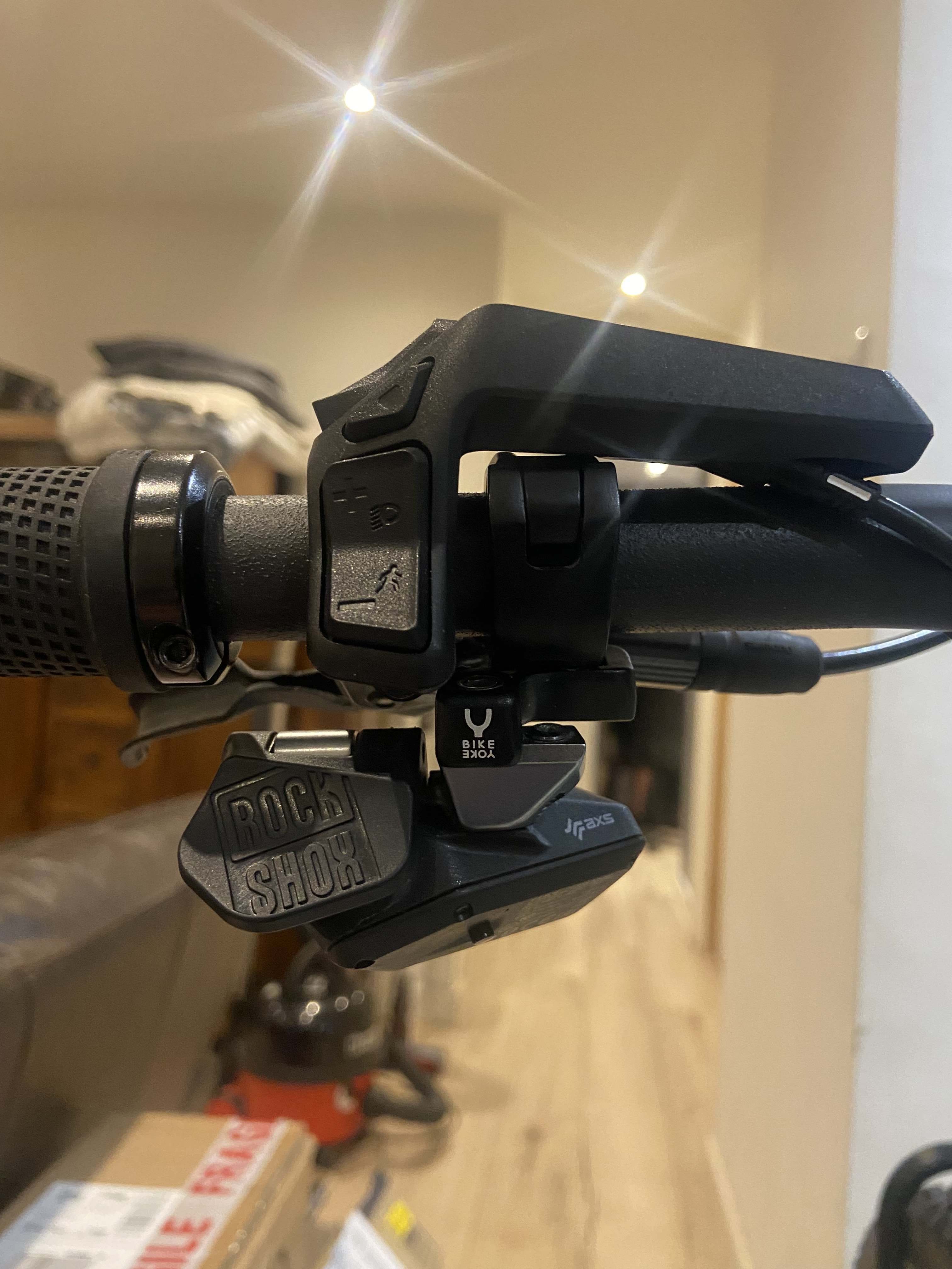

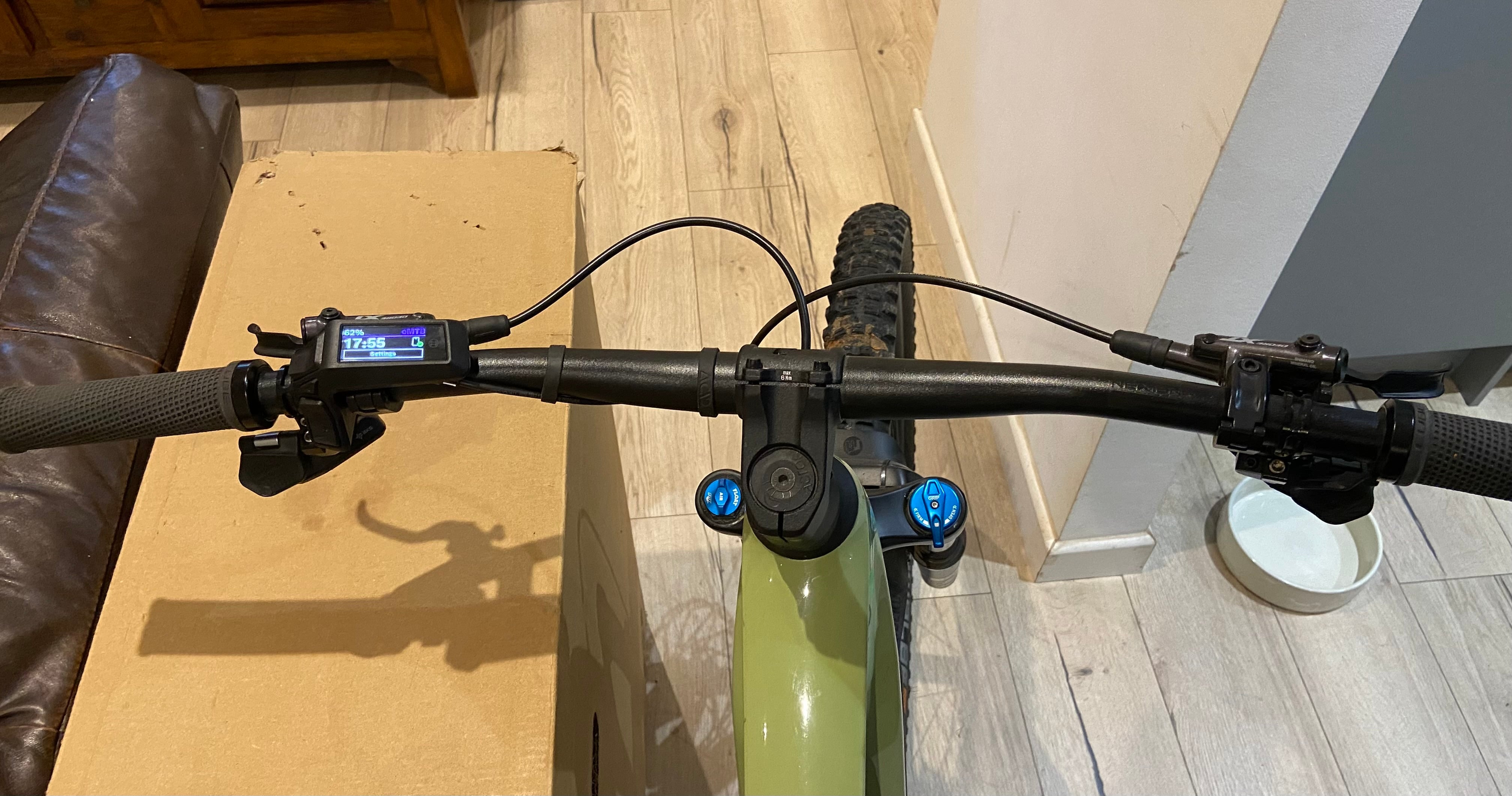

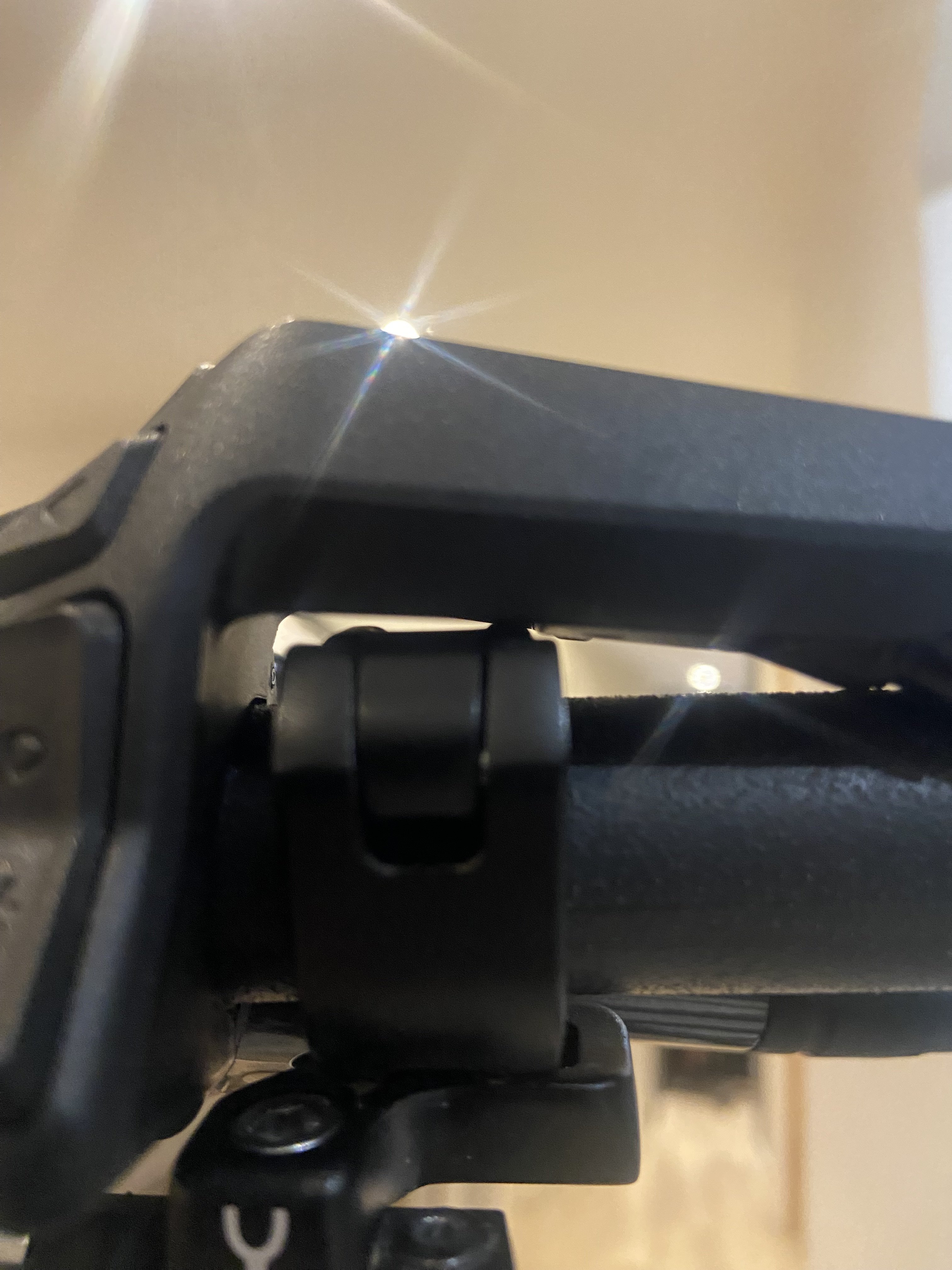

If you mean the gap between the clamp and the little brace, it does fit as shown in my picture above. Pretty sure it’s designed to sit right next to the clamp with the little dip it has in the back of it. You cant really sit it anywhere else. It is a faff to get it on though. You have to fit the brake and controller simultaneously. I’ve also got a matchmaker for dropper lever which makes things easier.
