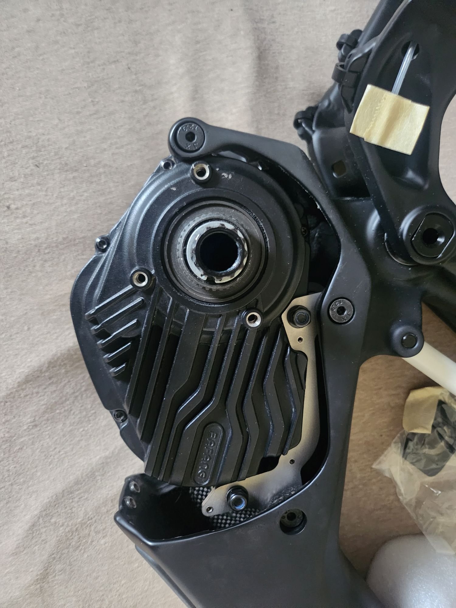

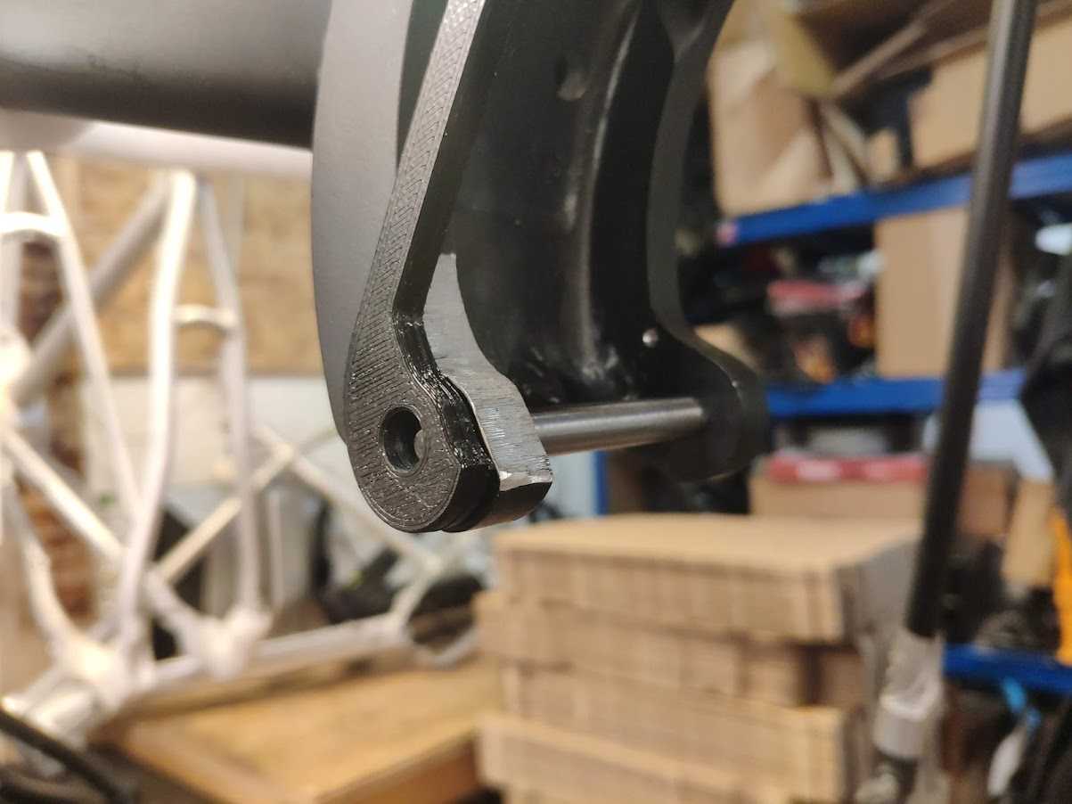

I have a '21 SC Bullit, with an EP8 that is no longer functional (E010 error). Seems like shimano has a massive quality problem, as I'm far from the only one with a drive unit failure due to a faulty torque sensor. Anyway, the motor died and Shimano can't replace it until November which is ridiculous. Searching for other solutions and I came across this thread. I can't send Private Messages yet (too new to the forum). But I'm very interested in your kit.
Tomblarom
Feb 3, 2021
116
178

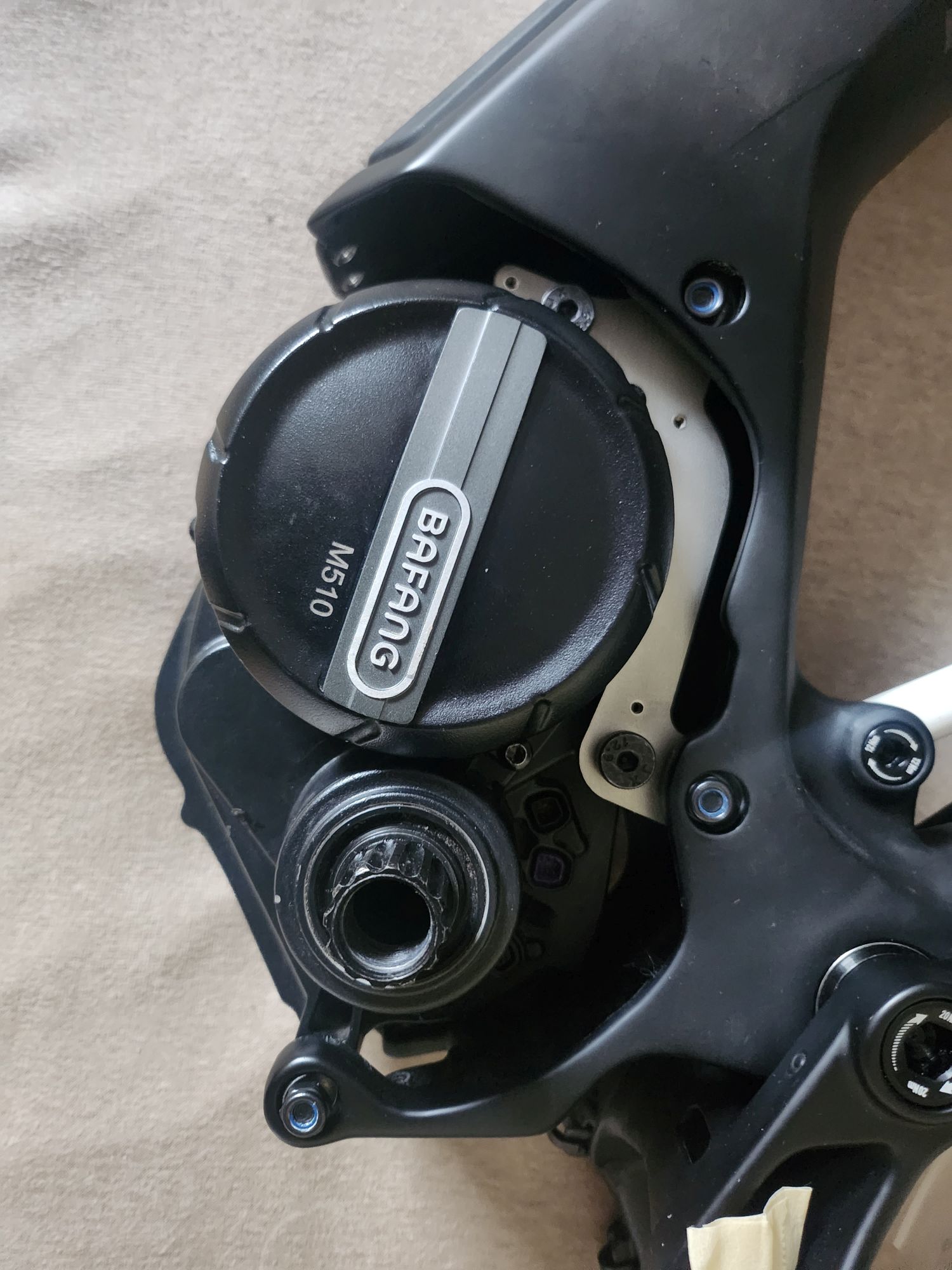

@futurestan I sent you a message. Your frame is lit! 😦 Added to my list of considerable eMTB frames with Shimano motors. 😉 Should be possible! The wide open intube-battery and big frame-triangle are excellent if you wanna put some extra cells in. However it's carbon and my kit requires you to cut away a small part, like here:
Tomblarom
Feb 3, 2021
116
178
By now I only 3D-printed the connecting parts (that hold Skidplate and Cover) and want to move on to something like "Resin Casting" before making this publicly for sale. However I'm open about inquiries from people that are willing to thinker and use 3D-printed parts. They work as well, as casted ones. It's just a cosmetic thing. 😉

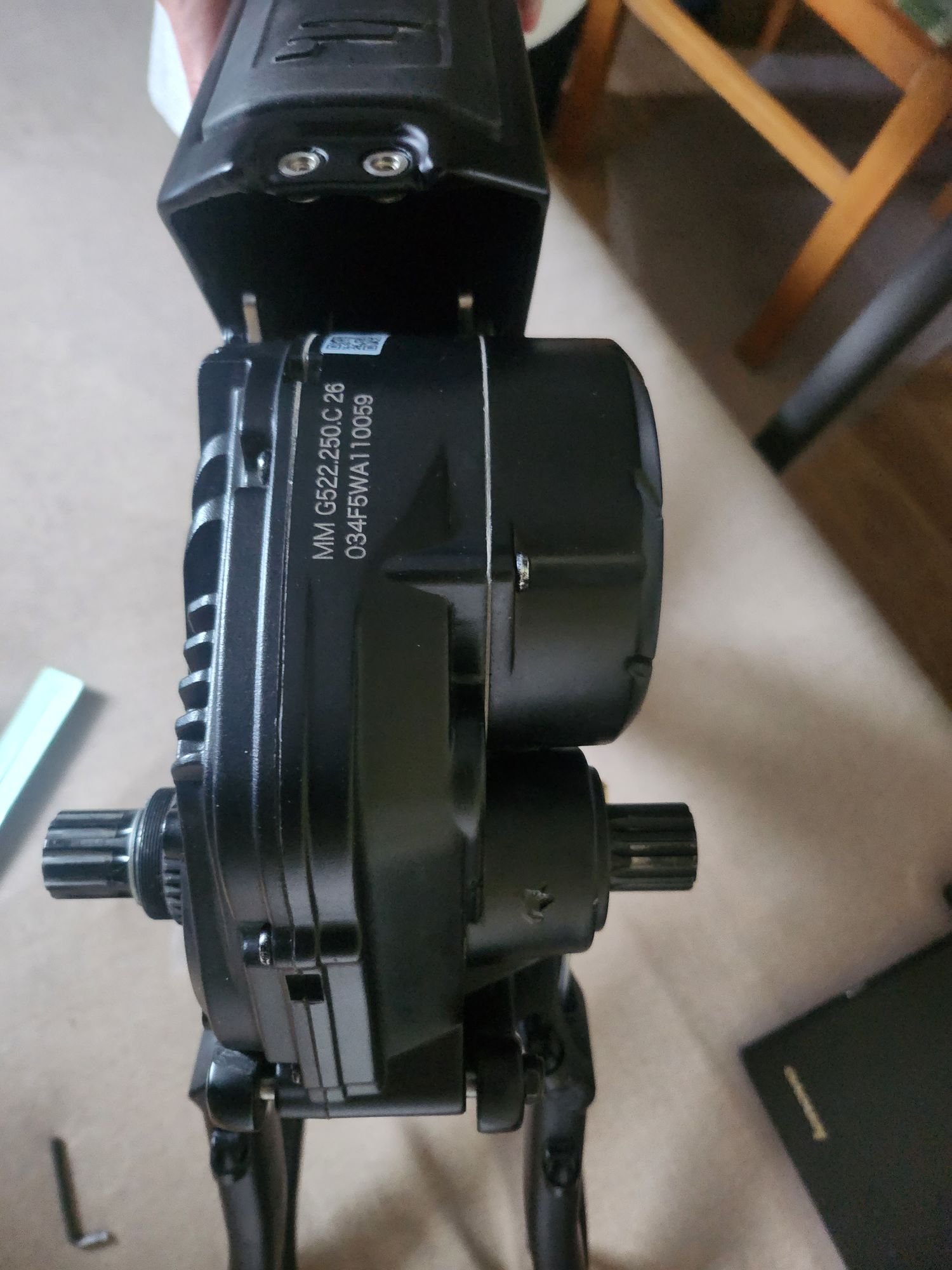

l´m working in a similar proyect, to adapt a shimano e8000 frame ( mondraker crusher) to a Bosch gen 4 motor.
I have jet resolve the battery and cables; but i need a more accurate 3d models of the engine.
Someone could sent me it ??
