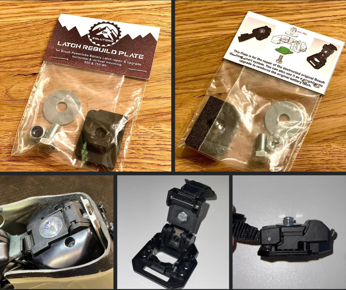

A guy on the strive on owners Facebook page (ran by rob rides emtb) has developed a new latch support and is selling them
I have ordered one myself so will see if it does the trick
I´m not so sure this fix will work in the long run. It might keep the latch alive for longer but it does not adress the small movements of the battery. My biggest worry would not be the latch breaking but the wear and tear on the battery and connector terminals in the future, which will be a lot harder and more costly to fix.

I think with shipping it was about £13 so not exactly breaking the bank. I am looking at it as a put me on until canyon and Bosch bring out their update

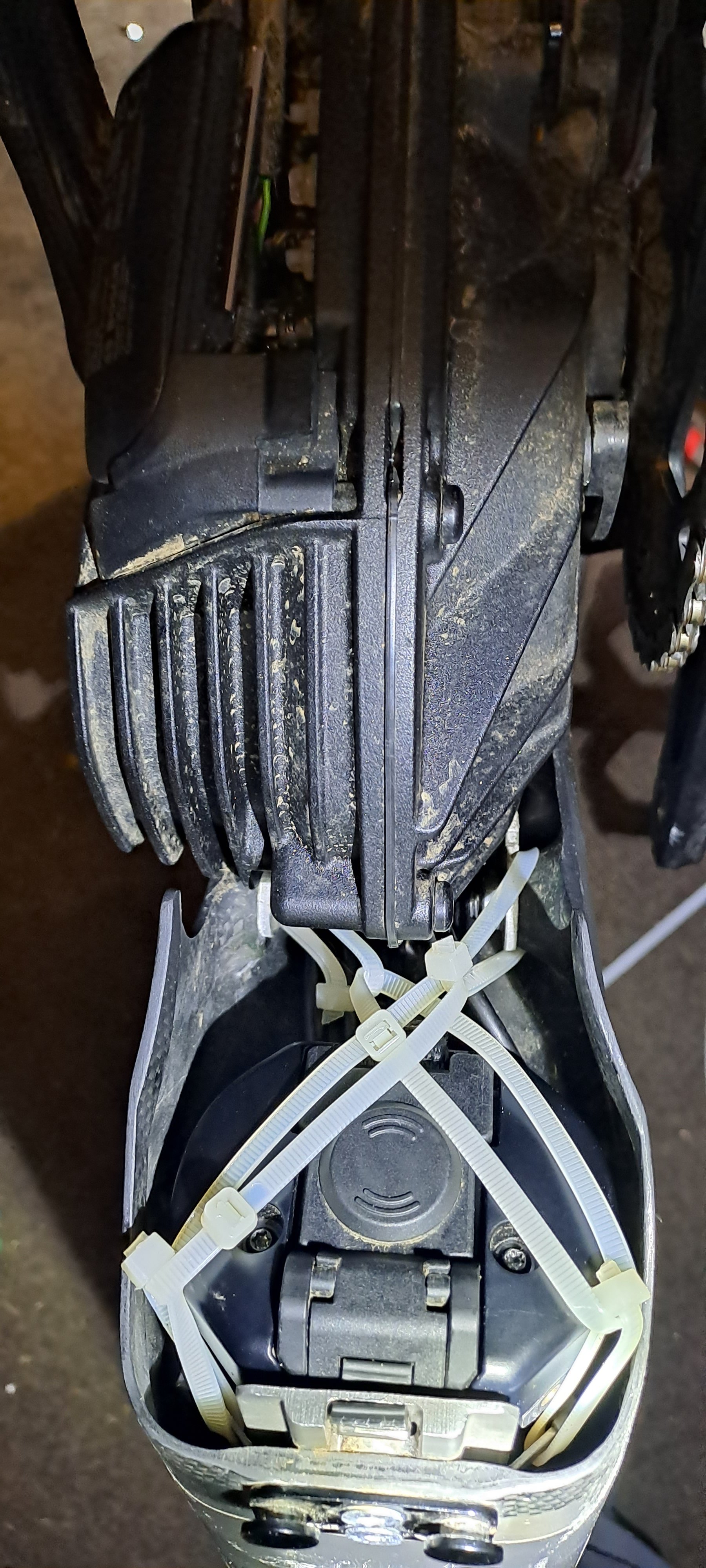

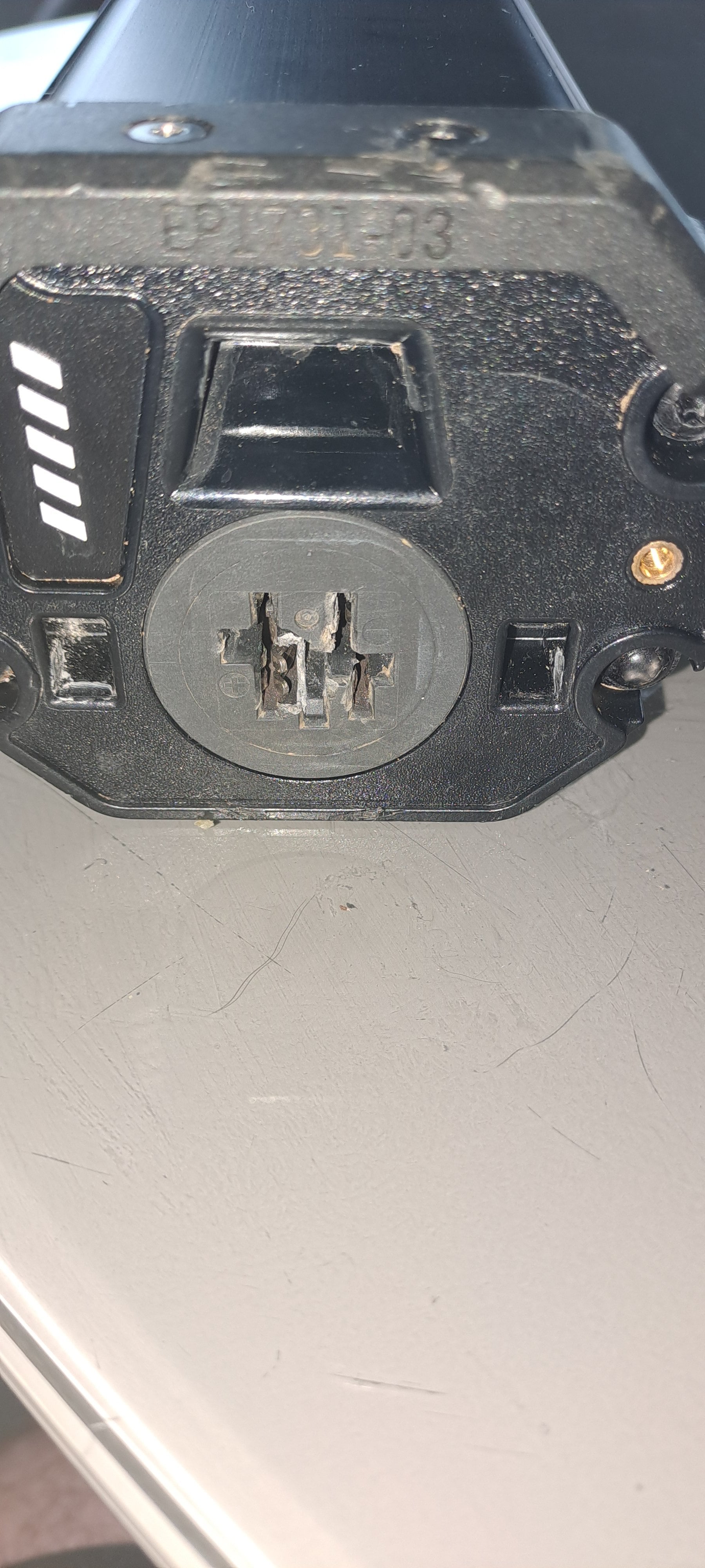

This is how I've fixed my battery in place for now as I'm currently waiting on a warranty replacement battery arriving from Germany due to the terminal damage....far from ideal but seems to be holding up so far with no more cutting out or orange lights on the display 🤞
