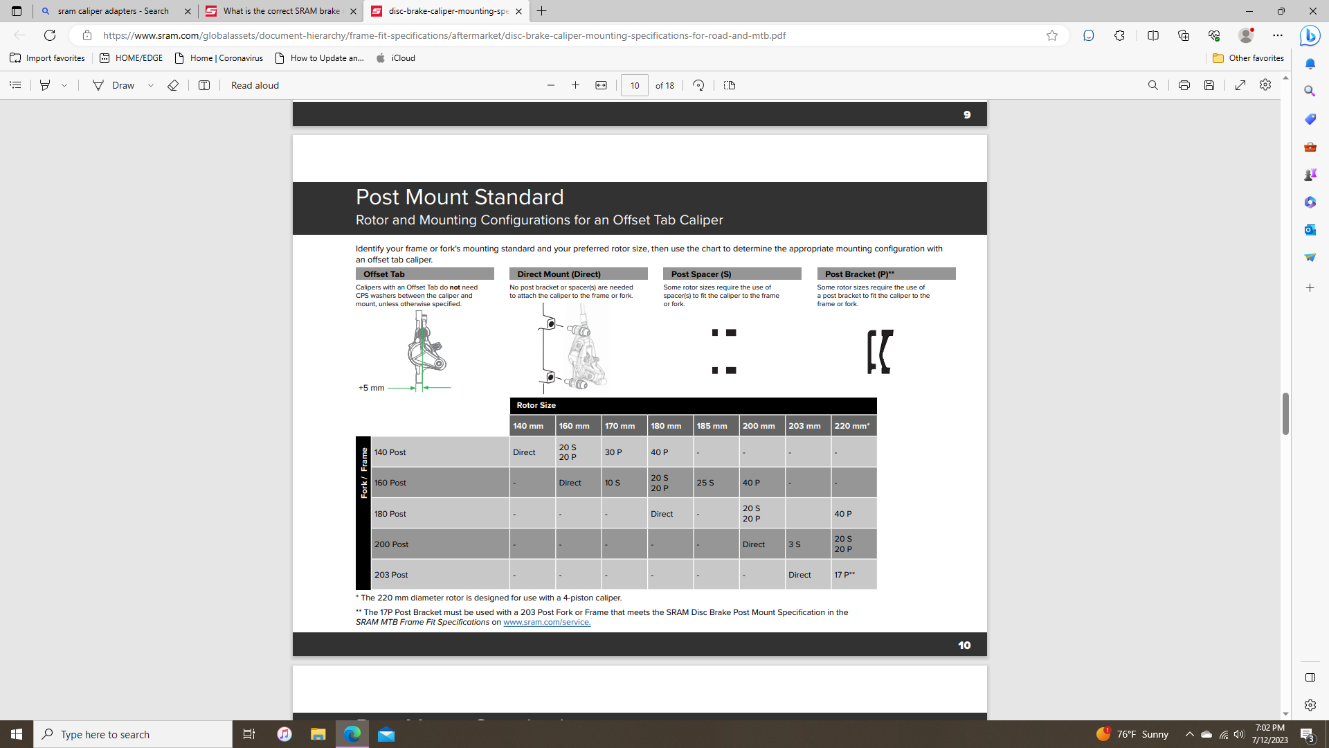

Fork is bomber 58. Brake caliper is XT 8120. Using 203 to 220 shimano adaptor ESMMAF220PPL. The rotor is the 220 sram hs2.
The issue I am encountering is that the rotor does not sit quite deep enough into the caliper and there is a small lip of brake pad at the periphery which is not engaging with the rotor.
Anyone have any idea what the issue may be? Is the rotor not sized as stated?
I notice this rotor has different part #, don't know if that means anything or not. (it does sound like a caliper alignment issue although I cant speak to it personally since I use SRAM Codes and their caliper spacers).
what is the sram 203-220 adapter for fork? like part is it? i will give that a shot
