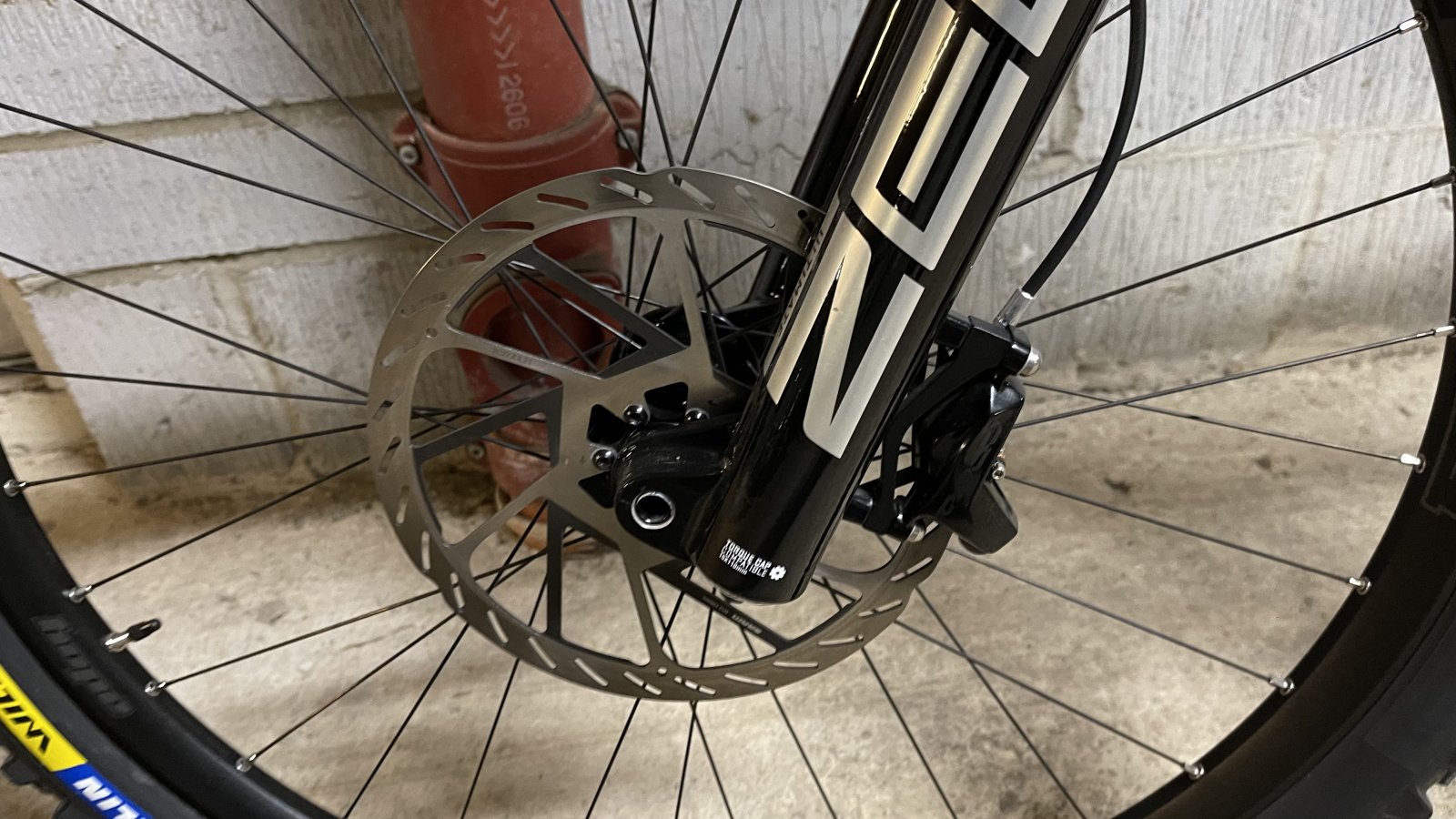

Few weeks ago got a Sram HS2 220mm rotor. When it arrived I checked it by laying it flat on both sides on a dead flat piece of plate glass. The rotor was and still is absolutely true.
Broke it in (front brake) carefully with Discobrakes semi-metallic pads. As said elsewhere, didn't like the noise and performance of the pads.
Cleaned the rotor, cleaned then put Shimano D03S resin pads back into my MT420 caliper, broke it in again, and all good.
* reason I wanted a larger rotor is not because I'm a riding god, but to reduce finger pressure because I have arthritis in my hands :(
