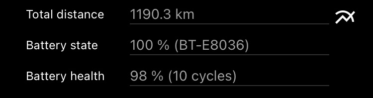

Fine and gr8, but your battery is BT-E8036 and this thread is about a different model. BT-E8035 drops down to 90% when you have 10 cycles.
Slightly off-topic… my E8036 battery dropped to 98% health after 10 cycles and 1190km… I can live with that.
