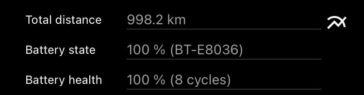

I do get the desire to measure degradation of battery, and charging cycles is accepted unit of measure, however…
I am more interested how many km I can travel on the bike and battery charge.
Here are my numbers:
998km, 8 cycles, 100% health
Fine and gr8, but your battery is BT-E8036 and this thread is about a different model. BT-E8035 drops down to 90% when you have 10 cycles.
