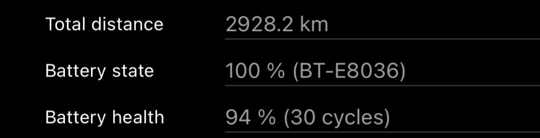

Interestingly, after 2928km and 30 cycles, my battery health ticked-over to 94% (NB. at 29 cycles it still showed 96%).
So my average full battery range is ~100km, however…
If I ride in Eco (36% assist) at 20°C my theoretical range is 170km, and I am confident I could do 150km, based on my L2B OR experience
If I ride in Trail (63% assist) at 2°C my range drops to ~50km, based on my observation, as after 41km hard riding in Surrey Hills, I had 20% batt left, and at that rate I would probably do 50km.
In conclusion, the same rider, diff conditions and vastly different effective range. You need to get to know your bike and your style, so that you can use it effectively.

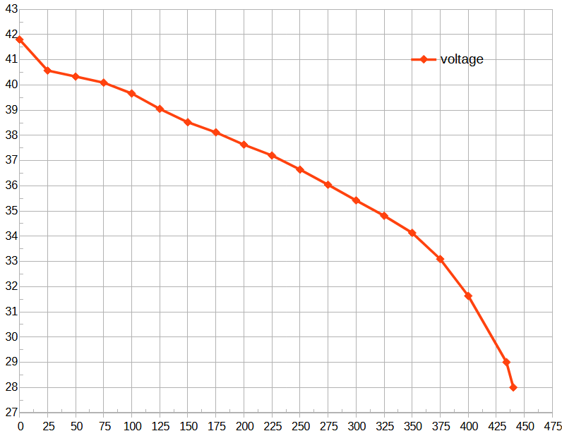

i used a 1 amp load to discharge the battery. surely enough, the shimano folks designed the battery to brick itself when not recognizing a movement of power.
after replacing the SFK-4030A "battery insurance" fuse, the battery internally bricked itself with a code.
[/MEDIA]
How did you apply the 1 amp charge?
I have discharged mine (8010) in the lab, down to 28V with up to 6 amps and had no problem. It´s is still alive
DC load was connected internally in the power pack with the battery off
