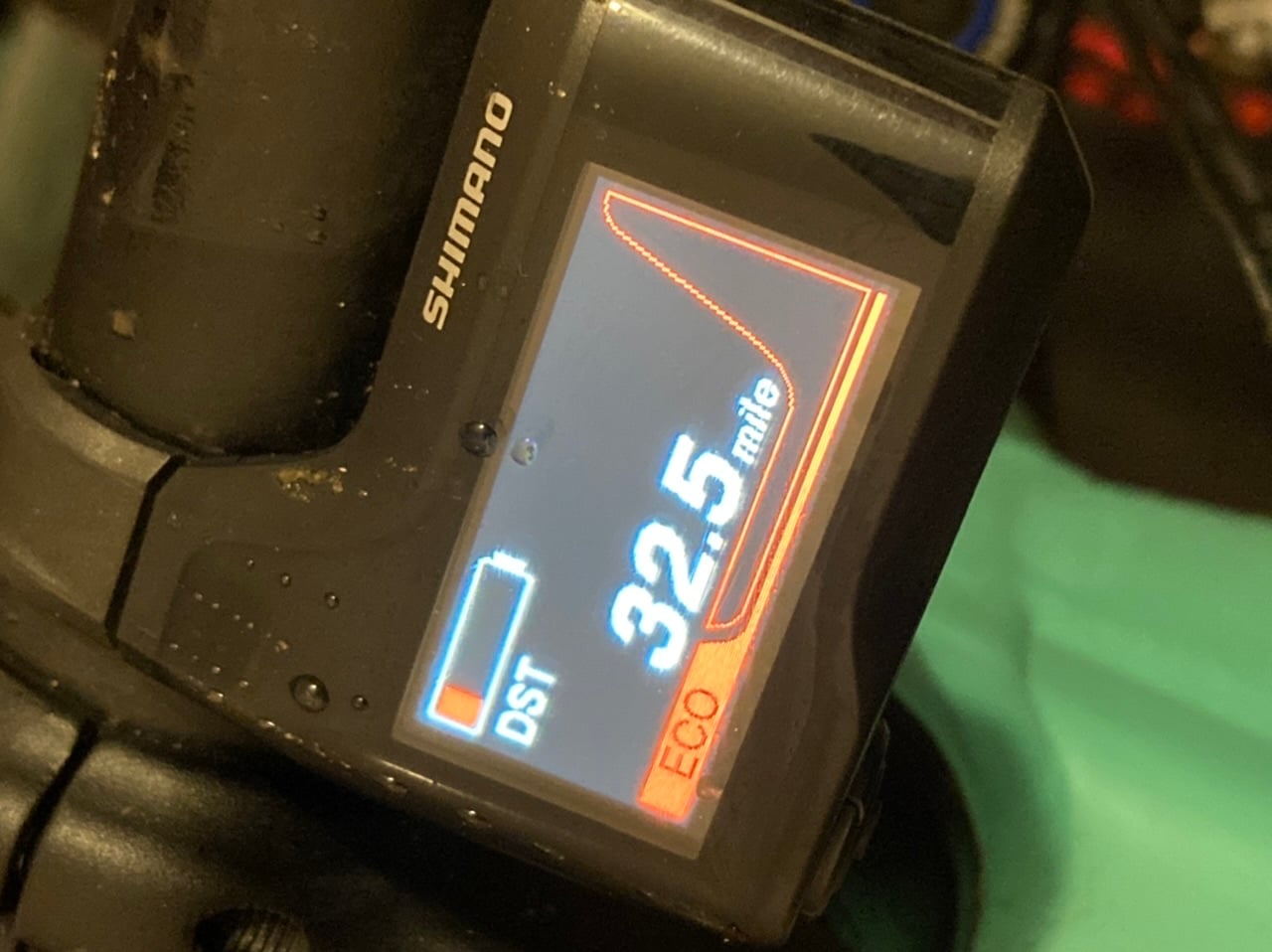

l've fitted the new battery and been out, the range isn't much more than the old battery which had a "health" of 79% according to Stunlocker
lt's certainly not 20% better. l was getting around 30 miles from my old battery and the brand new one was rinsed at 33 miles

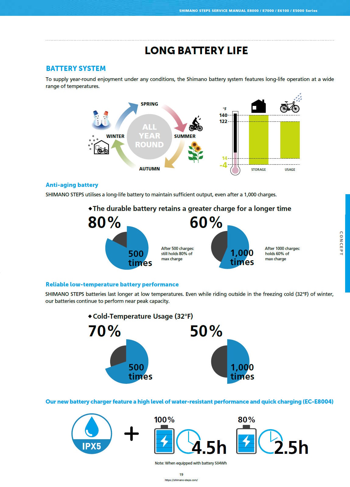

Shimano documentation states that specification is 80% at 500 cycles. May be we should start to lawyer up.
