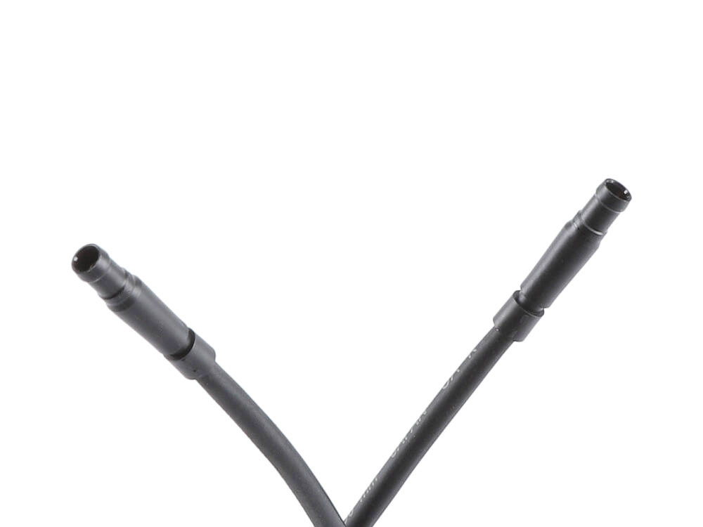

Shimano uses several types of electronic cables for it's eBike control systems. The EW-SD50 cable and the EW-SD300 cable. The EW-SD50 is an older cable version and identified by it's thicker housing. The EW-SD300 is a newer version and identified by a thin housing. The two cables are not compatible with each other. That's because each cable type uses a different style of connection lead.
Shimano computer displays will only accept one type of connection lead or the other, but not both. As an example, the SC-E7000 will only accept EW-SD50 cable connections. The SC-EM800 will only accept EW-SD300 cable connections. There are other display options which will work with the EP8 motor, however I did not research them. Be sure to check the compatibility chart before making a purchase.
Shimano EW-SD50 Cable. Compare the leads of the SD50 against that of the SD300 cable depicted below.
Shimano Ew-SD300 Cable

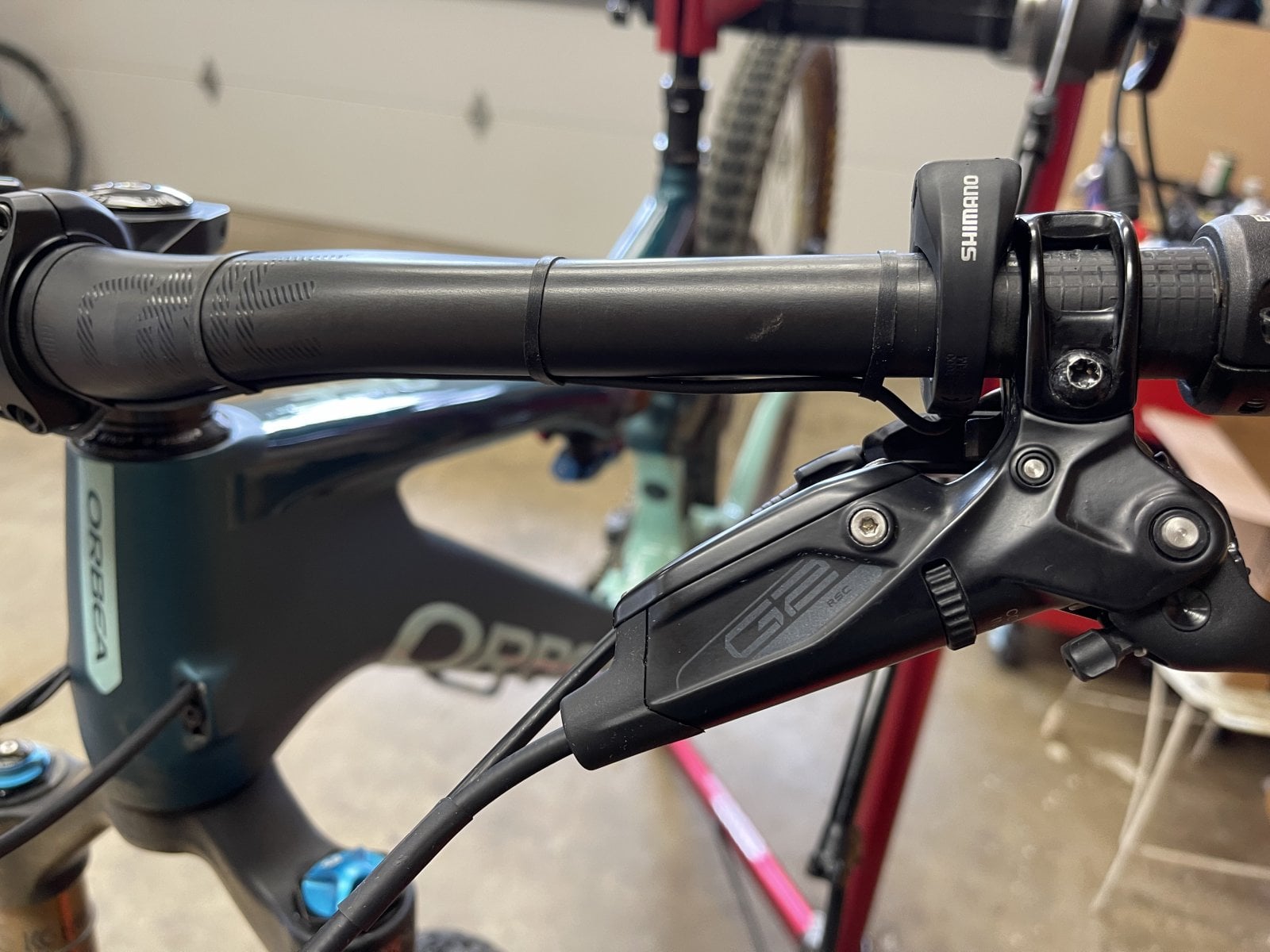

My bicycle and most 2021 Rise bicycles came from the factory with a SW-EM7000L handlebar mount mode controller switch. A picture of the SW-E7000 mode controller is seen depicted below. Note that the controller is hard wired with EW-SD50 cable. Because the controller is hardwired with EW-SD50 cable, you will need to use the Shimano SC-E7000 display which accepts EW-SD50 cable connections.
SW-EM7000 L Mode Controller Switch

The SC-E7000 display installation:
The SC-E7000 computer runs approximately $150. It comes with two handlebar adapters for use with standard and 35mm handlebar diameters. The display screen on the SC-E7000 computer is black and white. On the main screen, the computer will tell you your battery level, mode you are in and speed. There are several other sub screens you can go to and will give you accumulated bike mileage, ride mileage, etc. Interestingly, I'd ridden my Rise about 200 miles before switching to the SC-E7000 display. The previous miles were automatically downloaded from the motor to the display.

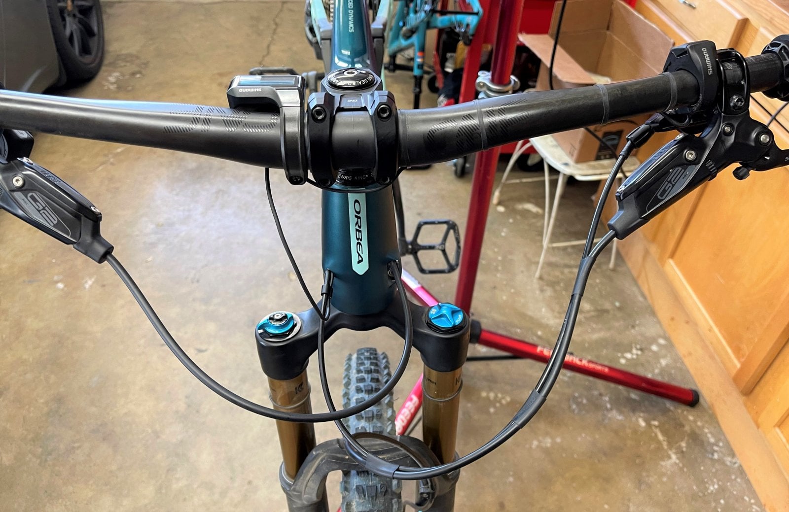

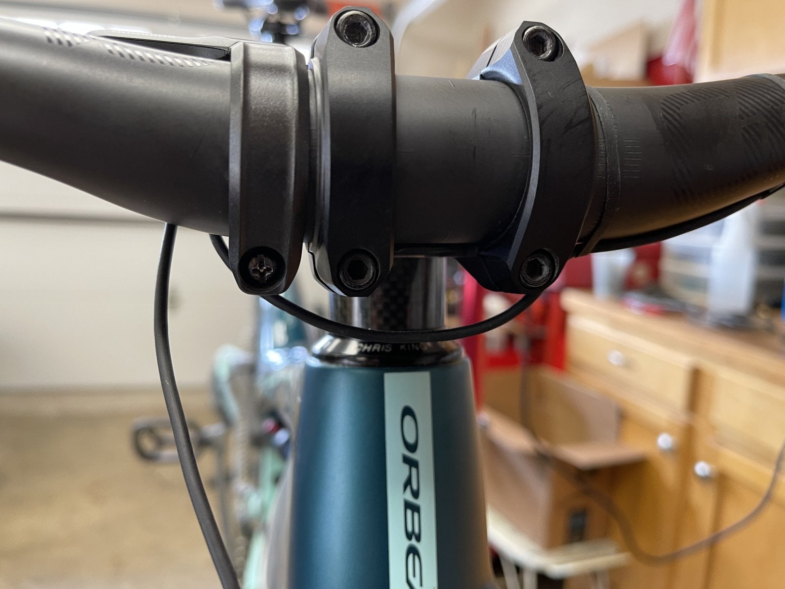

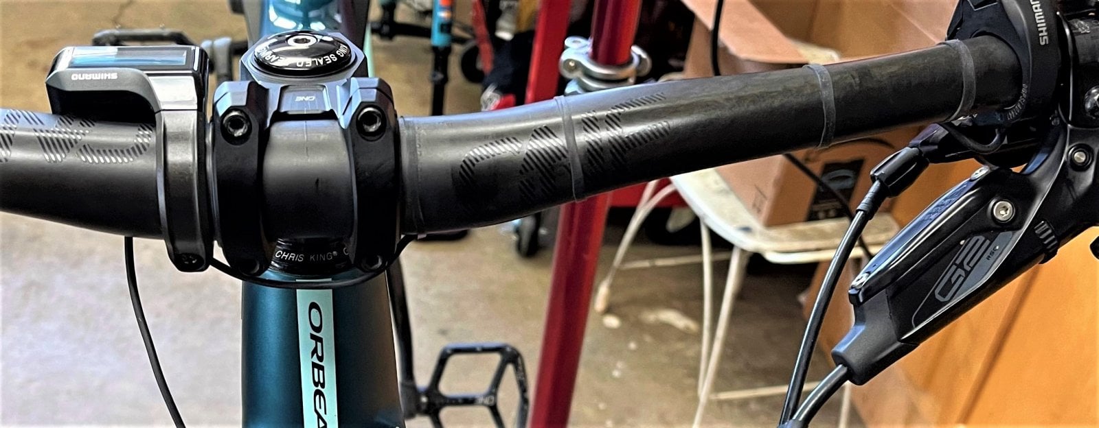

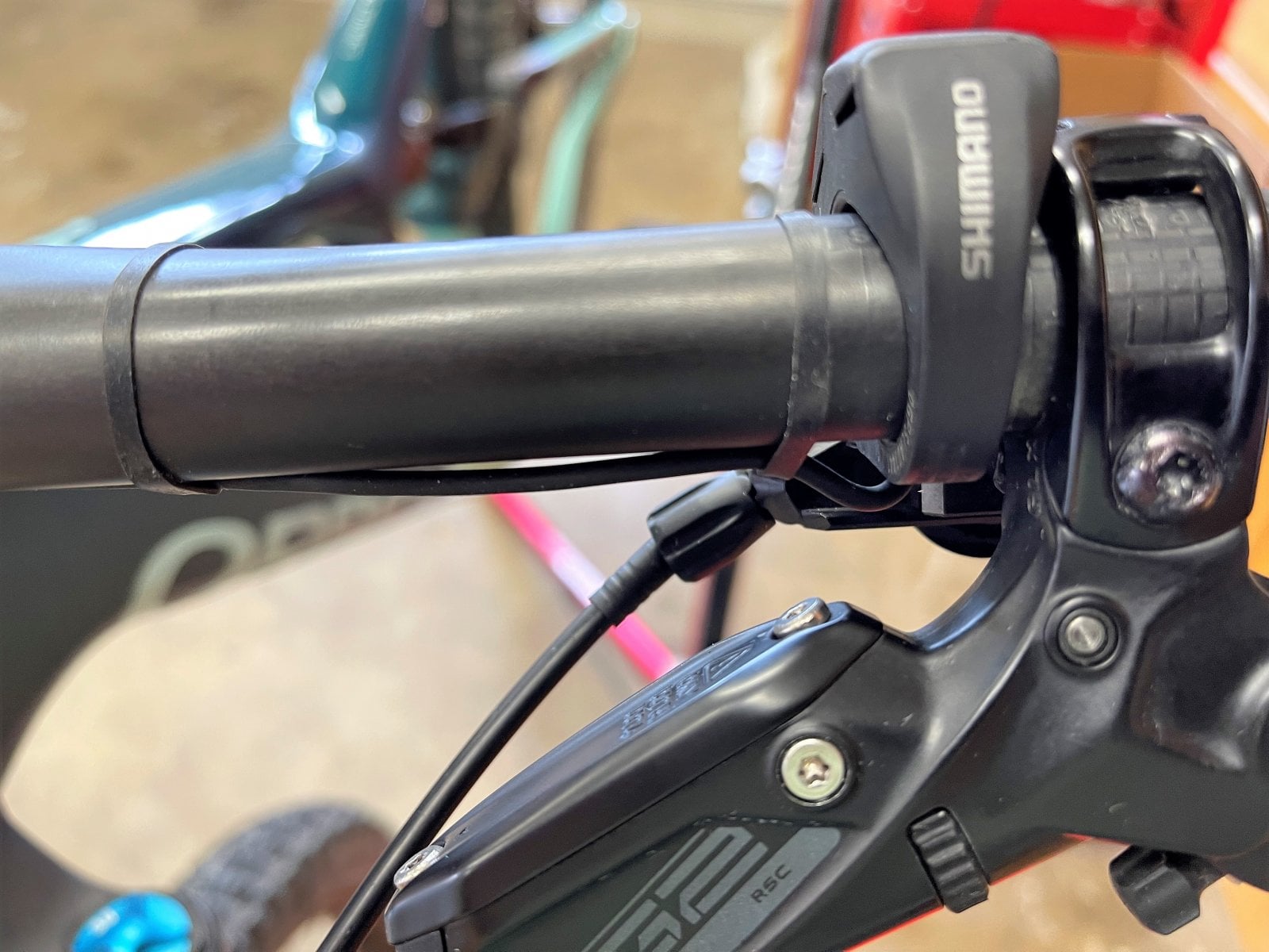

To install the SC-E7000 display requires nothing other than mounting the display on the handlebar, removing the EW-EN100 junction and plugging the EW-SD50 wires from the mode controller and the wire coming out of the head tube into the computer display ports. You will need to pair the display to your bike via Bluetooth.
Use one of the cable clips or a small zip tie to attach the EW-SD50 cable where it exits the head tube port to the dropper cable housing. This will help minimize chaffing.

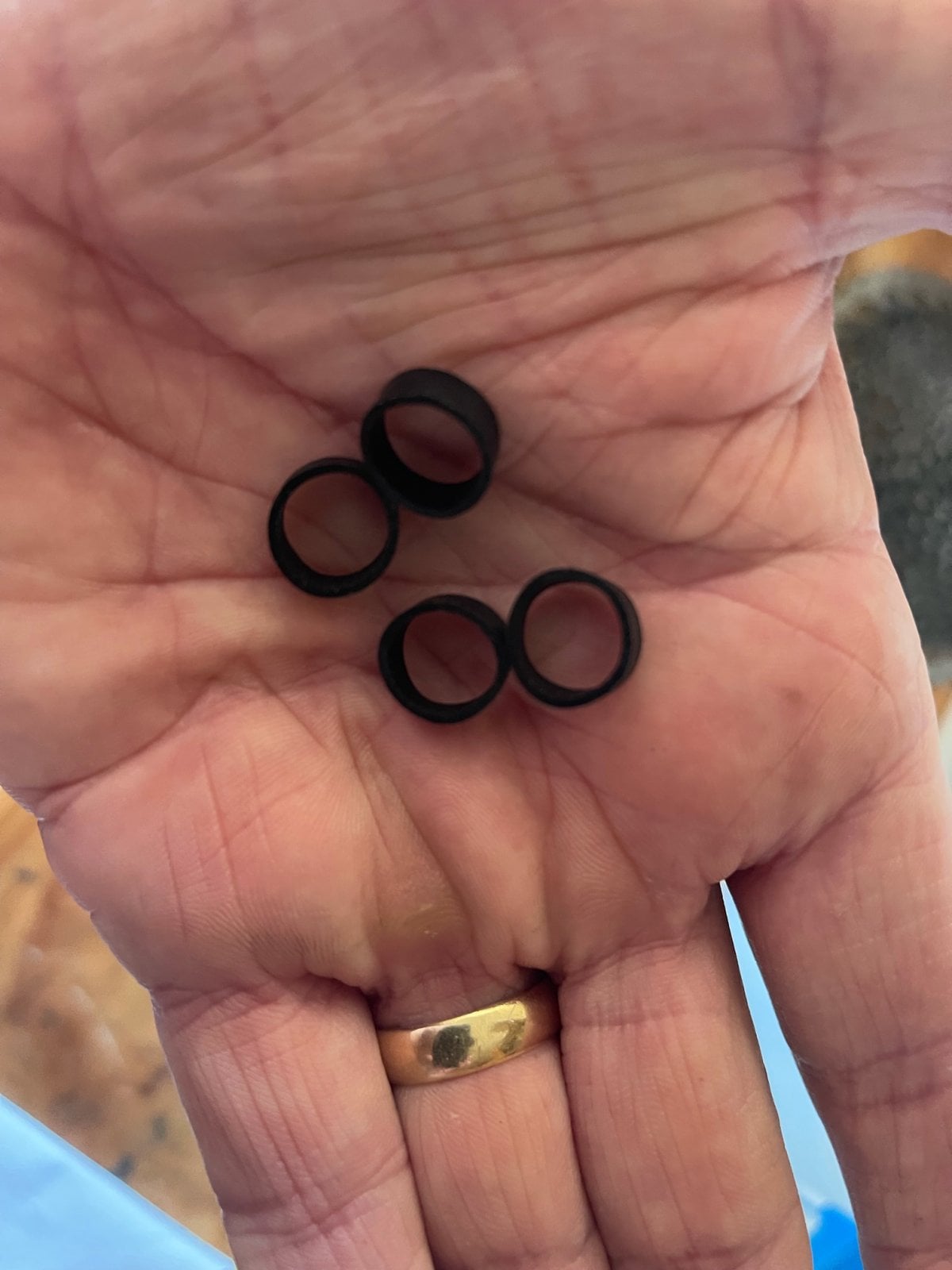

I purchased small black silicone bands on Amazon and used them to secure the cable to the handlebar. The wire running from the mode controller switch will barely reach the display mounted to the right of the stem. The EW-SD50 cable coming out of the headtube isn't a problem. Make sure enough cable exits the head tube to loop up into the display's connection port. The cable does not need to be fastened to anything. Refer to my pictures below.
Shimano does make silicone rubber bands specifically designed to attach cables to handlebar or frame tubes. Unfortunately, you cannot buy them separately. They only come in a package with the mode controller. I have seen them sold separately on eBay, however they are pricey. I imagine if you checked with your local bike shop, they might have some spares available for sale. I found the black silicone bands on Amazon, work equally as well and are unobtrusive on the handlebar.

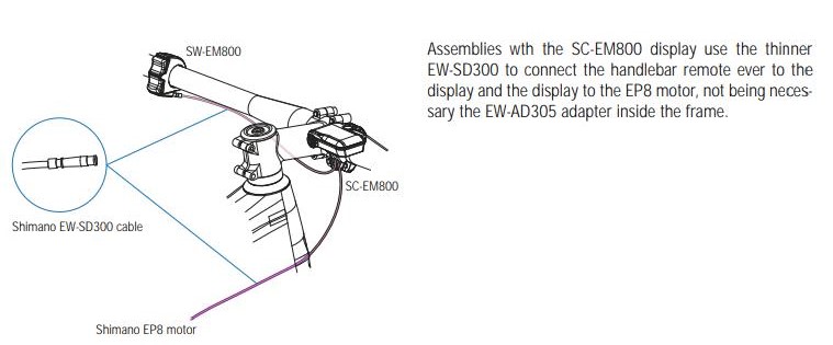

As I've previously mentioned, the SC-EM800 display is only setup to accept only the newer EW-SD300 cable connection. The ports will not accept a EW-SD50 cable connection. Your Rise comes from the factory with a Shimano SW-EM7000 controller which is hardwired with a EW-SD50 cable. To the best of my knowledge, Shimano does not make an adapter which will allow you to plug a EW-SD50 cable into a EW-SD300 port and allow you to use the SW-EM7000 controller. You will need to buy a SW-EM800 mode controller switch which has a EW-SD300 wired connection and will plug into the SC-EM800 display connection ports.
The Orbea Rise "Bluebook" manual has a diagram which depicts the SW-EM800 controller in relation to the SC-EM800 display.
Installing the SC-EM800 display requires a bit more work to install. You will need to drop your fork steerer tube out of the headtube in order to gain access to the EW-SD300 cable and EW-AD305 adapter on the end of the EW-SD300 cable.
Once you have removed your fork steerer tube, reach into the downtube/headtube junction and gently pull the EW-SD300 cable bundle out of the down tube. Do not yank and damage the cable, they are delicate. When the EW-SD300 cable comes out of the tube, it will be wrapped in foam and zip tied. Cut the zip tie and untangle the EW-SD300 cable. Remove the adapter from the end of the cable, you will no longer need it.
Measure out approximately eight to ten inches or so of free EW-SD300 cable. The length depends on handlebar, stack height, etc. It doesn't have to be exact. The remainder EW-SD300 cable you must re-wrap in the foam and zip tie. Tuck it back into the downtube so it won't rub on the steerer tube. Feed the remaining loose end of the EW-SD300 cable through the head tube port. Re-install your fork steerer tube, stem and handlebar.
Plug the end of the EW-SD300 cable coming out of the head tube and into one of display's four ports. Save the port farthest to the left for the mode controller switch cable which will come in from the left side of the handlebar. Remove your handlebar grip on the left side and slide the new SW-EM800 controller onto the bar. I use a 800mm OneUp carbon bar. In order for the mode controller cable to reach the display, I had to mount the controller to the right of my SRAM G2 brake lever. I have fairly large hands, so it isn't an issue to reach the controller with my thumb. If you run a smaller bar, it shouldn't be an issue to run the mode controller to the left of the brake lever and still reach the display with the cable. You should experiment with moving the controller to various spots on the bar and make sure the cable will reach the display before firmly attaching everything.
Reuse one of the cable clips or a small zip tie to attach the EW-SD300 cable where it exits the head tube port to the dropper cable housing. This will help minimize chaffing.

May I ask you the link of amazon where you have found the small black silicone bands ?

Here is the Amazon link. The silicone bands are about 1/4 inch wide, or 6mm wide as seen in the picture. They will thin out when stretched onto the handlebar. I like that they do this, because they are barely noticeable on my handlebar. They have worked our nicely so far and I have had no issues with my mode switch cable coming loose or a band breaking. To install the bands (I used four), I left my grip and mode switch in place. The bands will stretch over them. I did have to remove my brake lever at the clamp.

For some reason the Amazon link didn't remain attached when I posted my reply. I'll try again and also include the Amazon name. You can enter it in the Amazon search bar.
ONLYKXY 200 Pieces Silicone Cable Ties, Data Lines Silicone Cord Ties, Reusable Rubber Rings, Power Cable Tie Straps, Elasticity Coil Ring, Rubber bands

I got it. Thanks a lot for the detailed explanation.
