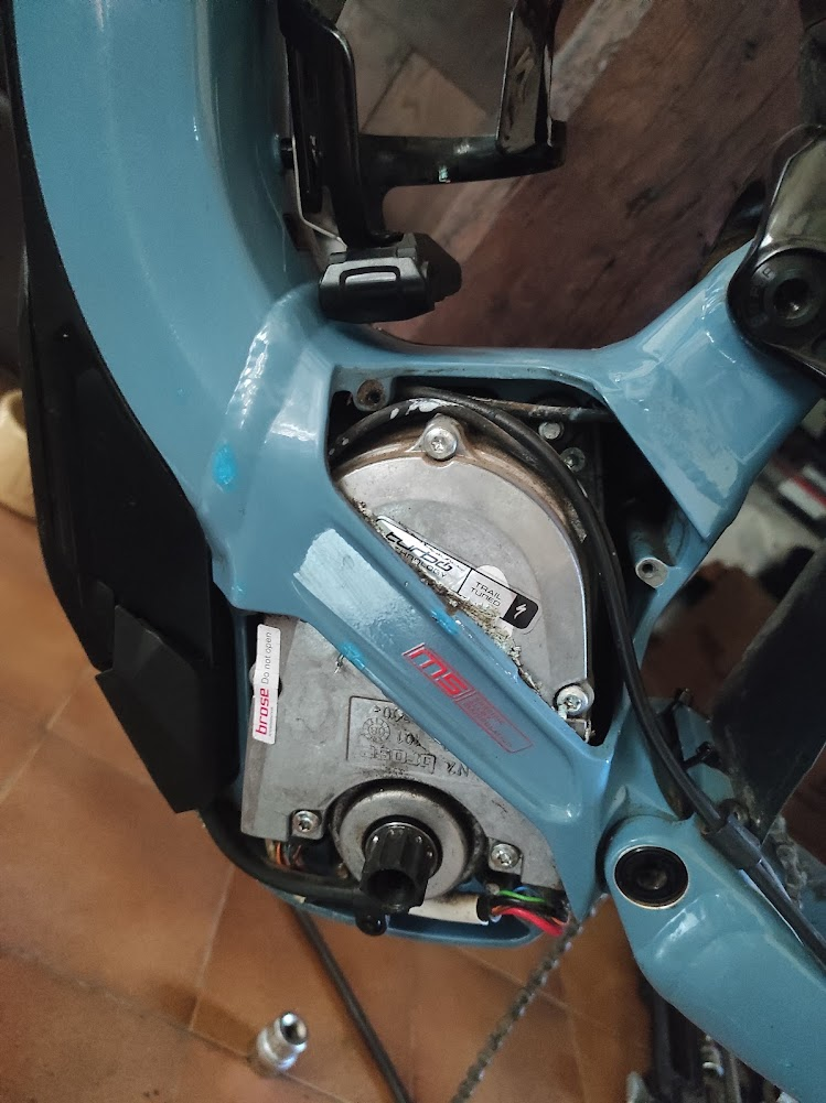

Found some time to do cover swaps .. it's alarmingly clean in there ! So the secret, if you submerse your bike - DRY IT ! lots !
2019 Kenevo. Original motor ! after years of absolutely awful performance (random range/power) , it's worn/fixed itself and now is pretty acceptable.
Incredibly, it's still faster than my other bikes on DH trails even though it feels slower.
I still consistently fall off it 10* more than other bikes ... ?!?! 29/27.5 ?

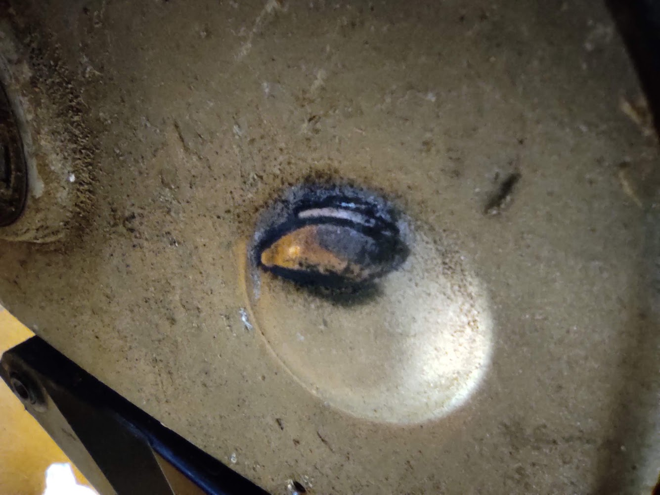

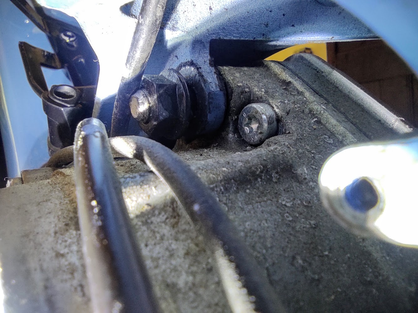

On the drive side, you can see where the cover's been rubbing against the motor ..

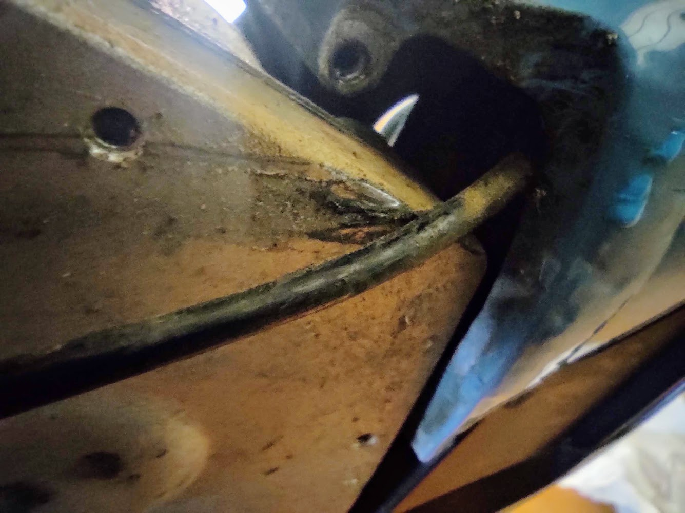

Likewise, the gear cable :
And the reason for the rubbing, the reason the cover eventually cracked and probably the reason it's always creaked like a pig since new - but I'd been too dumb to look at the motor bolts because it always seemed slightly better if you tightened the covers more :D🤪 :ROFLMAO: ! ..
