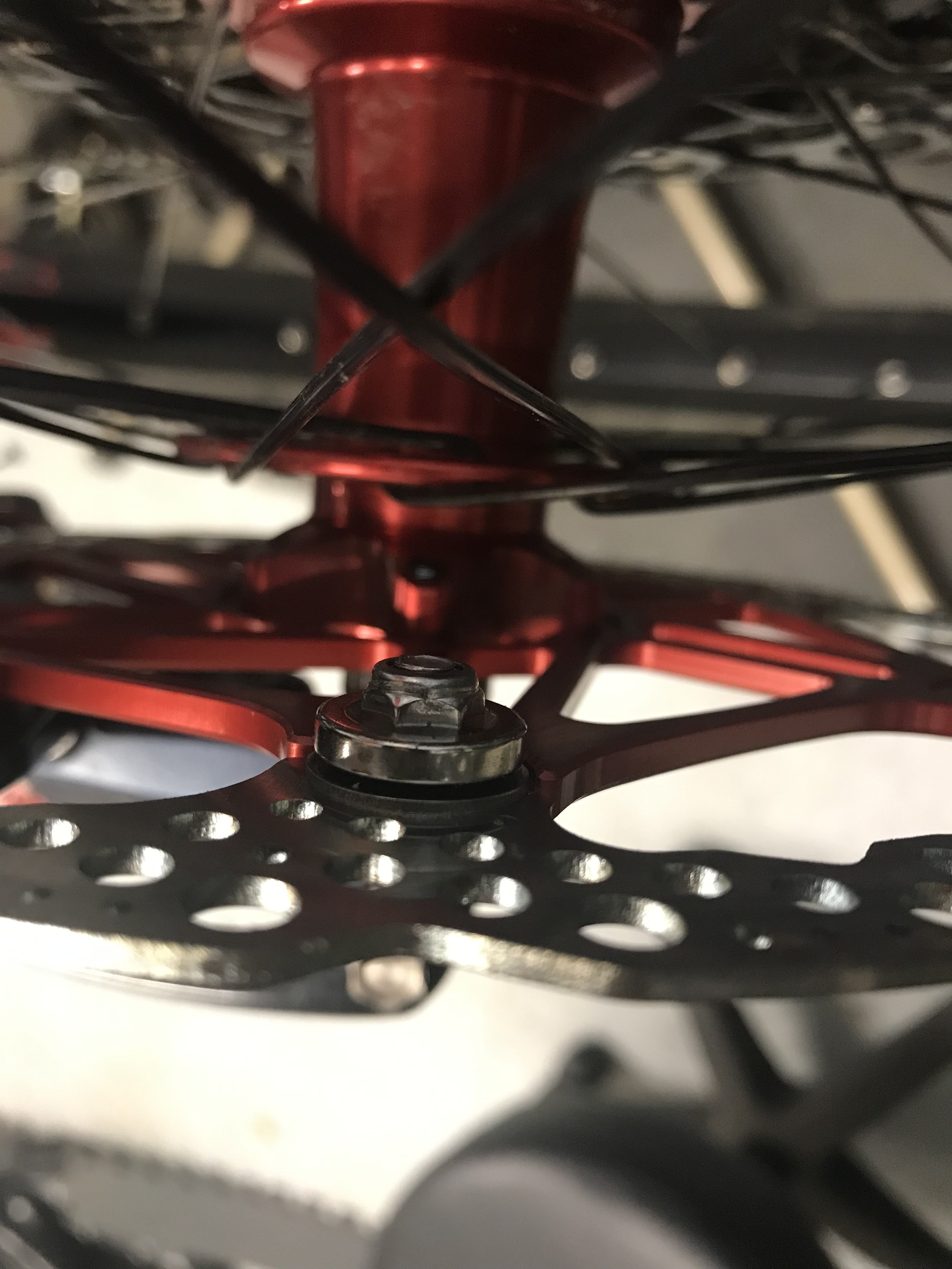

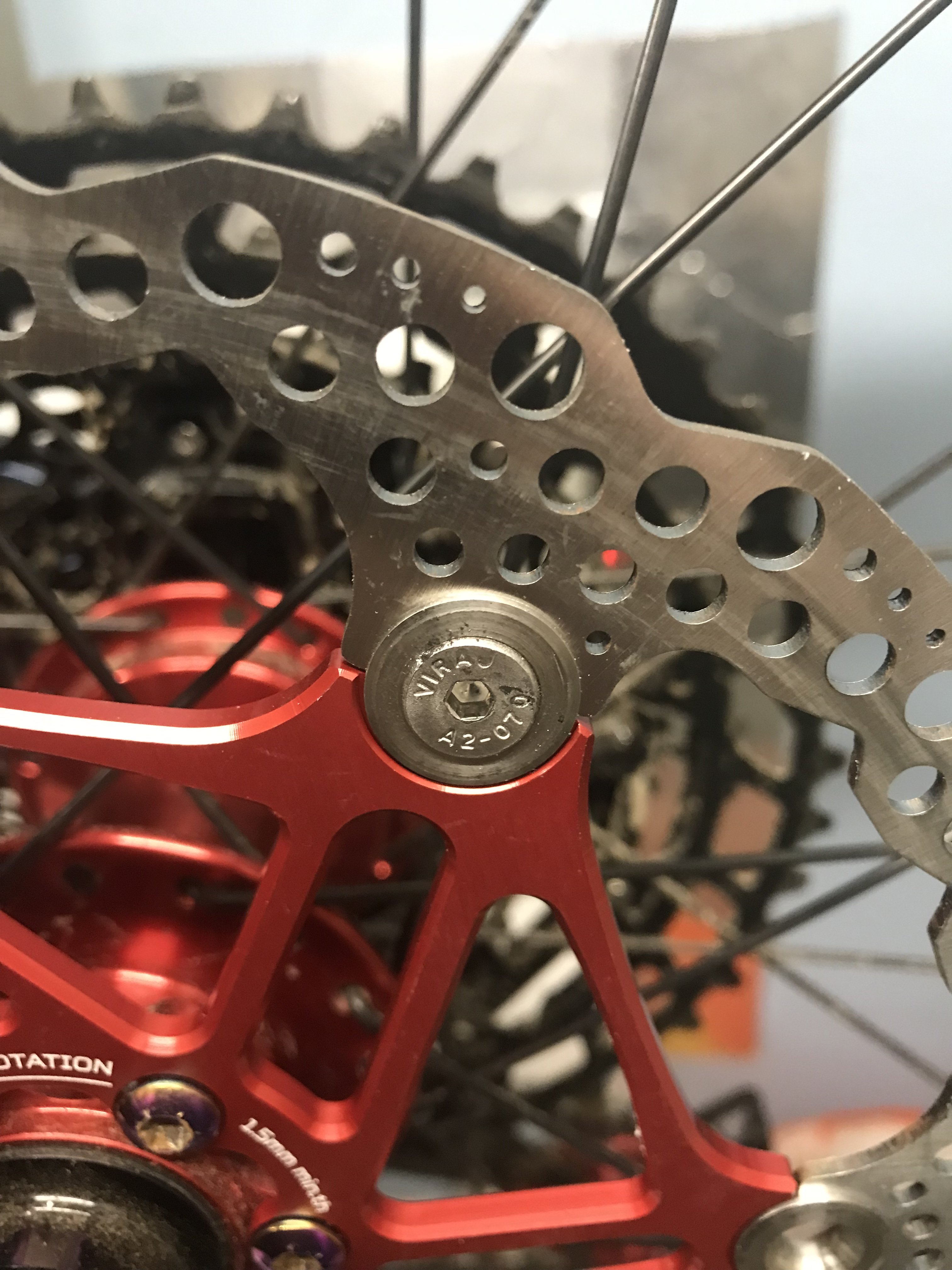

This is my method for rectifying the magnet issue on my Hope rotor, a 15mm x 3mm neodymium magnet with a 5mm hole through the middle, an A2 M5 countersunk stainless steel machine screw and an A2 stainless steel nyloc nut, all that can be seen is the head of the machine screw as the magnet is at the back of the rotor, anyway here’s a couple of pictures, I might change the machine screw and nut for an M4 but so far there seems to be no sign of the head of the machine screw fouling on the brake calliper, and the sensor is receiving the signal from the magnet and registering this on my Kiox, I think it’s a neat finish but that’s just me 😁

Thanks Mike 🙏I expect there could be even more clearance when I fit my new Hope calliper, there’s one thing I did forget to mention, if anyone else is going to do this modification, be cautious with the magnet as neodymium magnets are brittle and shatter if subjected to excessive pressure, this is my second magnet as I over tightened the first one and it did shatter into several pieces, this one is just nipped up 👍
