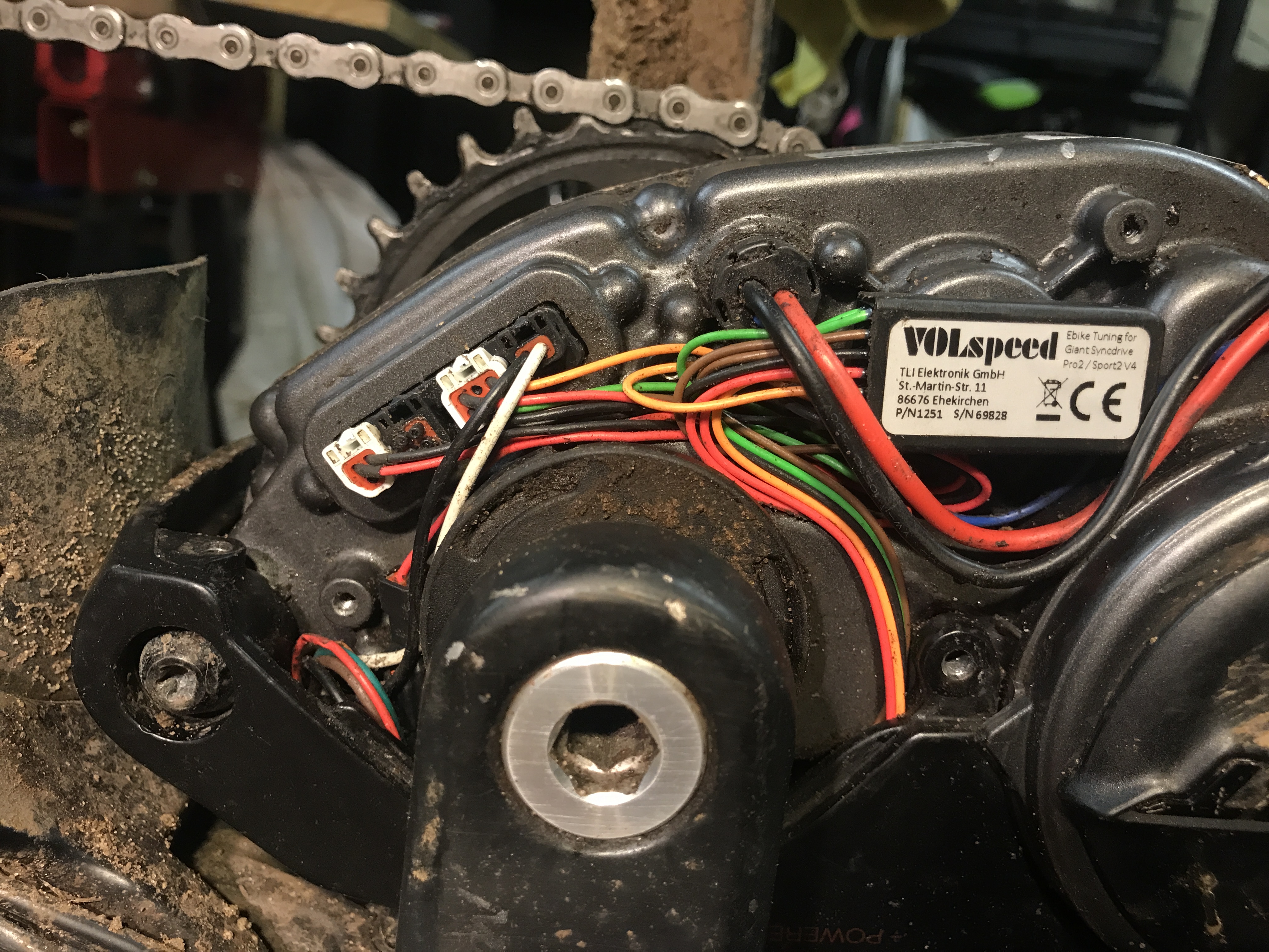

@goroncy - if I understand the information on the vendor site correctly, the VOLspeed needs to be activated each and every time when the bike is powered on. Can you confirm?
goroncy
May 1, 2020
273
345
Munich
I do confirm. And you can make your own combination of keys. I did. In case anybody stops you just power off the bike. After turning it on again it will work as the stock one.

Absolutely. The chip doesn't change a thing in the settings. Until you cast a spell (magic key combination) the chip just sits there and transmits the signal in unchanged form. When you switch it on all the tuning settings still apply. The only thing that was so so is that after I installed the chip all the settings were reverted to factory settings. 30 second later I had my settings back.
Are you still using the Volspeed and does it still work ok with the latest Yamaha Firmware with the Updates to the Power profiles ? Do you update the Firmware with the Volspeed in place or do you have to remove it ?
goroncy
May 1, 2020
273
345
Munich
I am still using Vollspeed. I didn't upgrade giant's software for a long time now (a year?). One. There is no need. Two. Rumors were enough for me not to upgrade. I don't want to brick the bike. Everything works. And going above 25kmh is absolutely my priority. So updating the software now doesn't seem to make any sense.

This is a message I got 60 seconds ago:
Dear Customer,
Due to current events, we would like to draw your attention to problems with our tuning products for Giant bikes.
The notice concerns the following products:
Article Description
1197 Ebike Tuning for Giant Syncdrive V3
1234 Ebike Tuning for Giant Syncdrive Sport / Pro / Life / Core V4
1251 Ebike Tuning for Giant Syncdrive Pro2 / Sport2 V4
A notice:
Not compatible with Smart Gateway software version 20240314000 or newer. Do not perform any software updates on the drive system. This could affect the functionality of the tuning and/or the bike. Also do not use the Ride Control app, as this app could force you to perform a software update.
For more information, see our blog:
DE: Kompatibilitätsproblem Giant Smart Gateway – VOLspeed
EN: Giant Smart Gateway compatibility issue – VOLspeed
We will update this entry as soon as we have new information.
Sincerely / Best regards
Tobias Lindermayr
TLI Electronics GmbH
goroncy
May 1, 2020
273
345
Munich
At least here you can see wich version is compatible and they are testing the new update Smart Gateway:V 20240329000
On VOLspeed page there is no chart but they clearly say above which version the dongle stops to work:
