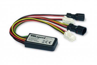

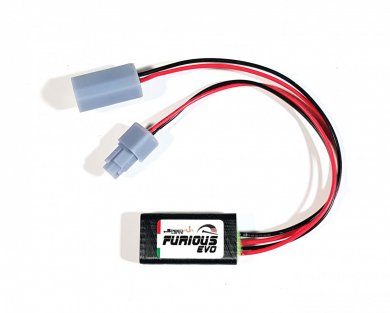

For anybody who is interested in tuning his/her Giant-Yamaha PW-X3 motor there is a tuning device from Italy. I contacted them and it will be available from tomorrow on. It seems it is a very basic model that allows only for turning it off and on. No max speed settings or anything. Installation seems to be trivial.
Tuning-ebike-SpeedFun-Furious-Evo-Giant-SyncDrive-Pro-2022-e-Yamaha-PW-X3_product.jpg
If anything else appears or gets tested lets add it to this thread.

New Far Cry is waiting so I'm gonna be quick. I bought this little bugger:
Directly from the maker:
VOLspeed E-Bike Tuning - Giant Syncdrive Pro2 V4
It works as described. You can change the max speed very easily. You can set up custom combination to switch it on (switching off is always the same). It integrates nicely with Giant's screens but I personally don't have any screen so I used the Ride Control app. Worked too.
To fit it I did all the things described in their YouTube video:
The thing they got a bit wrong in my opinion both in the video is the placement of the tuning device. They placed it behind the thick cables. I couldn't put the side cover back this way. Which caused the bottom motor cover to push against the misaligned side cover. The producer suggest on YouTube to place the device like this:
Thick cables are in front of the device here.
In their manual the placement is much better and allows the side cover to fit without any issues:
I did it my way :) :
So take your time with the cables. And be careful not to cross thread the bolts that hold the side and bottom cover. Frame's aluminum is much softer than steel bolts and you should be careful here.
When it comes to ride impressions I will write more because I did just a short test ride. Definitely no on-off behavior I had with some Bosch chips. The motor still feels very natural just like before. Super easy to switch off in case cops are around. So far so good.

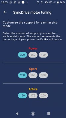

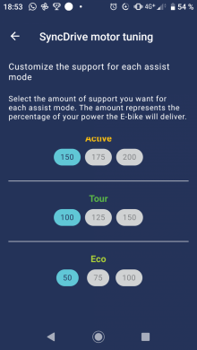

So I broken my own promise today :D. I went slightly different way. Instead restricting it to 36 or 38kmh I just left it unrestricted (45kmh). Why and how it works now? My motor tuning looks like this:
So basically I have the lowest possible percentage of assist on every assist level. When I derestricted the bike completely there is ZERO wall effect and max speed is actually something that depends on me and the motor working together. Which feels awesome. So on:
  • Tour: I ride something like 28kmh with a very comfy resistence
  • Active: The same feeling to the legs and the speed is around 34kmh
  • Sport: The same resistance but the speed is around 38kmh
  • Power: The same resistance and the speed is around 41-42
The really cool thing is that on whatever level I'm at the motor helps ALL THE TIME. So I can go to 40kmh even on Eco. So overall it all works MUCH better than I though it will. I think that this chip with this motor is MUCH MUCH MUCH more fun than Bosch with any chip I tested. Really cool stuff. What is left is reliability testing which will take me of course at least 2-3 months and at least 1000kms. Cheers.

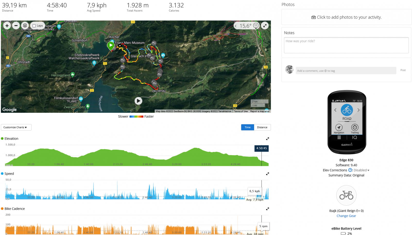

I just did an absolutely ridiculous enduro with the chip "on" all the time. Here it is:
Don't look at the average speed. The whole trip was really mental. There were moments I had to carry the bike... But on the fire roads when going up I was simply at least twice as fast as I would normally be. I finished with 2% battery but the bike was absolutely usable as an e-bike till the very end. I'm 84kg + the whole gear (around 6kg) + 25kg bike. So the whole setup is 115kg. 1928 vertical meters and 39 kilometers and 3:37 moving time I think gives you an idea what this machine can do. The chip works flawlessly. Cheers.

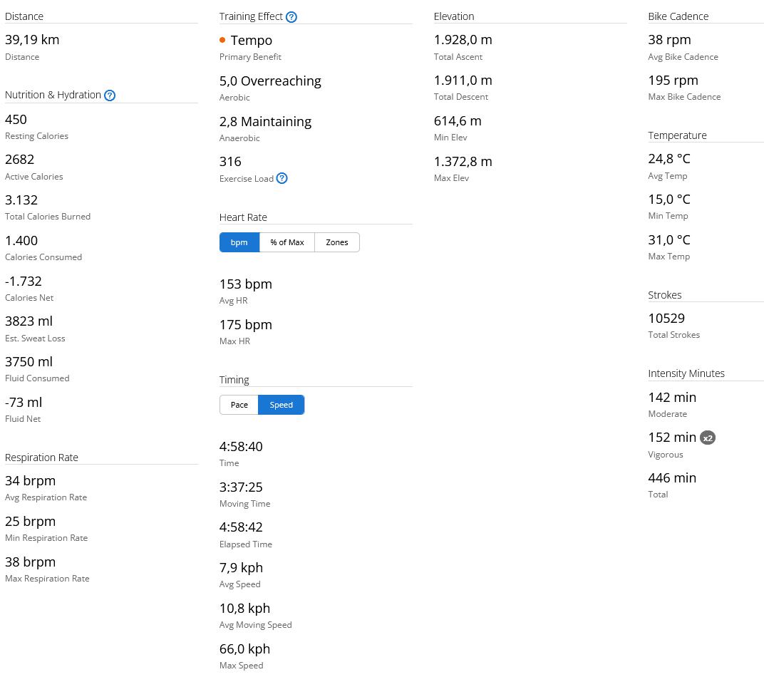

Wow that's fantastic ⚡⚡⚡👍 impressive stats.
I am about the same weight all geard up as you. The vertical meters you did are insane, the most I could do was 1750m with the 625Wh...do you have the 750Wh battery?
With the 625Wh I found out that my range falls between:
35km/1400m(300%-400% power),
50km/1550m(175%-250% power),
63km/1750m(75%-150% power).
The last day I did a power session(pushing it to the max):
Forrest access road(asphalt 20%, gravel 80%)
Stats: 26min50s,
10km,
670 vertical,
22,3km/h average speed,
Motor power 300% with occasional 400% bursts,
Battery used 44%
The motor was on fire hot🔥 after that session 🙆‍♂️

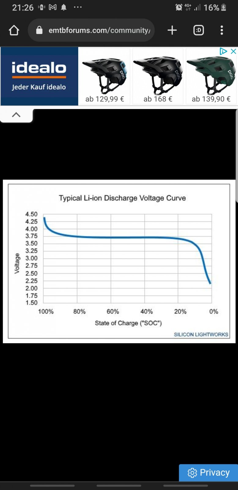

I also noticed that the battery pack follows the typical Li-Ion battery discharge graph. It starts droping significantly after reaching about 10% or below so I am usually calculating my consumption/reach considering this fact.
