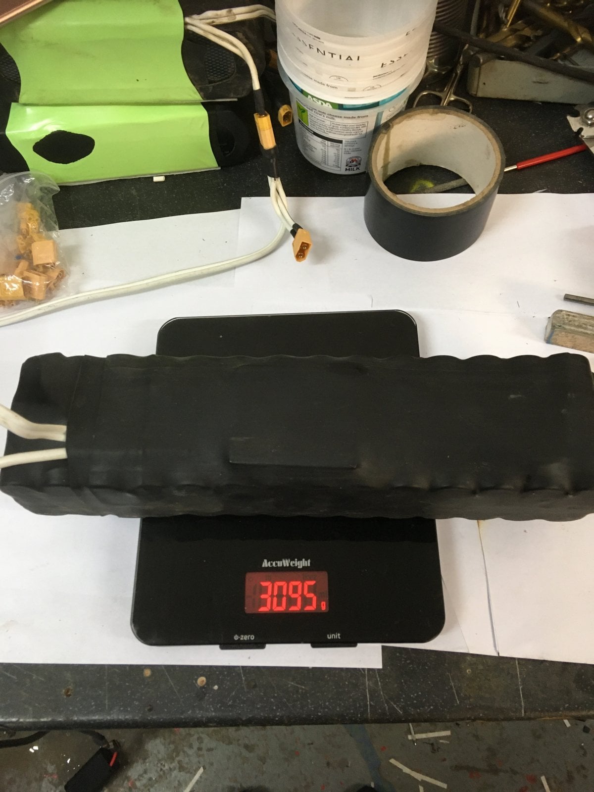

Yes is the answer, but with caveats here. The manufacturers use proprietory Can Bus signals and the likes to manage and interpret the battery to protect it from too much load and the total number of charges etc. But if you research and look around the internet its surprising how much info you can find. Do your research and you may well find for example that a few of us have built batteries for say the Bafang motors.
OK safety warning here, building batteries can be a risk to the builder. Why so, I am building 52 volt batteries which fully charged are 58.3 volts. Now anything around 60 volts DC with 15A of oomph behind it will stop hearts if you manage to get yourself in the wrong place and touch terminals you shouldn't, so beware, be safe and adopt good practice. If you want to see the tip of a metal screwdriver dissappear in front of your eyes then go prodding around one of these types of batteries, yes we all have done it once, but I can assure you it will be the only time.
OK why do I build batteries. Cost certainly, the battery below for £ 160.00 comes in at a pretty descent 780Wh's. Weight, that same battery is just over 3.0kgs, using the latest cells such as the Samsung 50E cells where each cell has nearly 5.0 amps of oomph compared to say the Samsung 30Q cells of only a couple of years ago with 3.0 amps. A 780 Wh battery of only maybe two years ago would have been pushing 4.0kgs. You get the picture, the batteries energy storage is becoming much denser. Learning curve, what a way to learn about the next generation of motorised transport until Hydrogen fuels take over.
OK so where and how, theres now a zillion articles and Youtubes on making Li Ion batteries for Ebikes but the best is probably a bed time reading session on Battery Technology - Endless Sphere and various Youtube feeds.
OK heres my latest
And how I have my 2 18650 x batteries paralleled into the Dengfu E10 I have giving me 680Wh usuable. The new 21700 above is more compact and quite a bit smaller in volume than the two batteries, I'm looking foward to getting it out and seeing what it will be like, its the first time we have used these high density cells.

Ok best two suppliers of batteries I have found are Fogstar Wholesale – The UK’s Number #1 Li-Ion Battery Supplier in the UK and Nkon.nl/ if you are in the EU. Nkon will also add tags to the battery, which then makes for an easy way of soldering the battery together, rather than having to purchase a spot welder. The first few batteries I built this way, are still going strong some 5 years later.
BMS's are funny things, you can pay a fortune or you can pay less than a fiver and get the same results. If they work from day one, they seem to work forever. I also spray all mine with conformal coating and then getting covered in water is not such an issue. I've almost given up on specifying a BMS as everytime you go to buy more, they are no longer in production or not available. Ebay is good for low volume and fast delivery, Ali Express is really cheap but takes about 10 - 14 days to turn up.
Best way to fit the battery to the frame is to simply use industrial velcro and simply mount the battery to the cover, the cover is pretty strong and when you remove the cover, the battery comes with it. Industrial Velcro always amazes me how much weight it can cope with.
But if you tally up the costs, for not a lot more you can get the Bafang battery, just it will weigh more.

Just as an aside here is my latest 780Wh battery, very impressed so far and I think the quoted specs are what we are actually seeing in the field.

if someone is selling you the 50E for Ebike duty in 14S2P format then you may want to ask questions on their suitability as a supplier or have you assumed as I used them in the 14S3P that they would be OK ? As I have already pointed out each individual cell call handle 10 amps, so we are now using 2 x giving 20amps max current. Now that may sound OK but I can assure you your motor will peak around that.
So we have whats called a 1 C situation which the battery boffins at Samsung have tested their battery in ideal temperature and drawoff circumstances would say thats OK. Out in the field however you will find things quite different and indeed in our use of the Samsung 35E batteries we got caught in the same scenario, they don't live up to spec in the field at 1C. We have found that in the last stages of charge the voltage sag at 1C is such that you will trigger the BMS early and you will have less over all power than the older 30Q batteries we had been using, which are rated much lower for capacity.
I would recommend that you go no lower than 2C or as I have done 1.5C ( 14S3P ) with these batteries, they work really well with the extra overall max rating of now 30 amps.
We have been using the Samsung 21700 40T which have a 35 amp 1 C rating in the 14S2P with really good success and out in the field they actually seem to exceed manufacturers specs. Top battery with an ability to hold good voltage levels until the bitter end.

A simple + and - will power up the Bafang M600. You will not get some of the display features such as " range" but you soon learn what range your battery will do by using both the display and the Bafang App which will display volts.
The Samsung 50E 21700 cells as 14S3P at 780Wh's are definately a big thumbs up. Does seem to make the motor a bit fiesty until a volt has been dropped and then its back into the normal 48 volt battery range. I would suggest with this M600 motor to stick with the 48 volt battery it was designed for, its more than powerful enough.

There is space with the 14s3P 21700 battery I built at either end and I think with careful battery construction and layout it could be possible to build a 13S4P battery but it would be very tight I would suspect as the frame is designed with 18650 batteries in mind.
A 14S3P Samsung 21700 50E battery will give you 780W\h’s
A 13S4P Samsung 21700 50E battery will give you 960W\h’s
Is it worth the cost and development for just 18% of additional battery ?
I’m only using about 550W/h’s on 1K of climb over 50K of quite knarly and slow off road, and would suspect that if I backed off a bit on power and had more open terrain, 100km would be possible on the 1 battery ?
