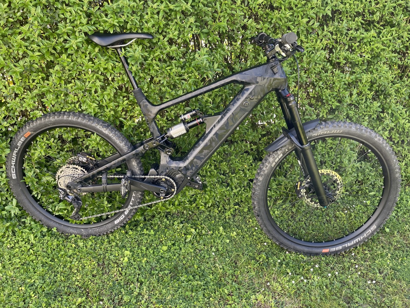

Dengfu E10 - Build-up
dvng
May 21, 2021
94
41
Malaysia

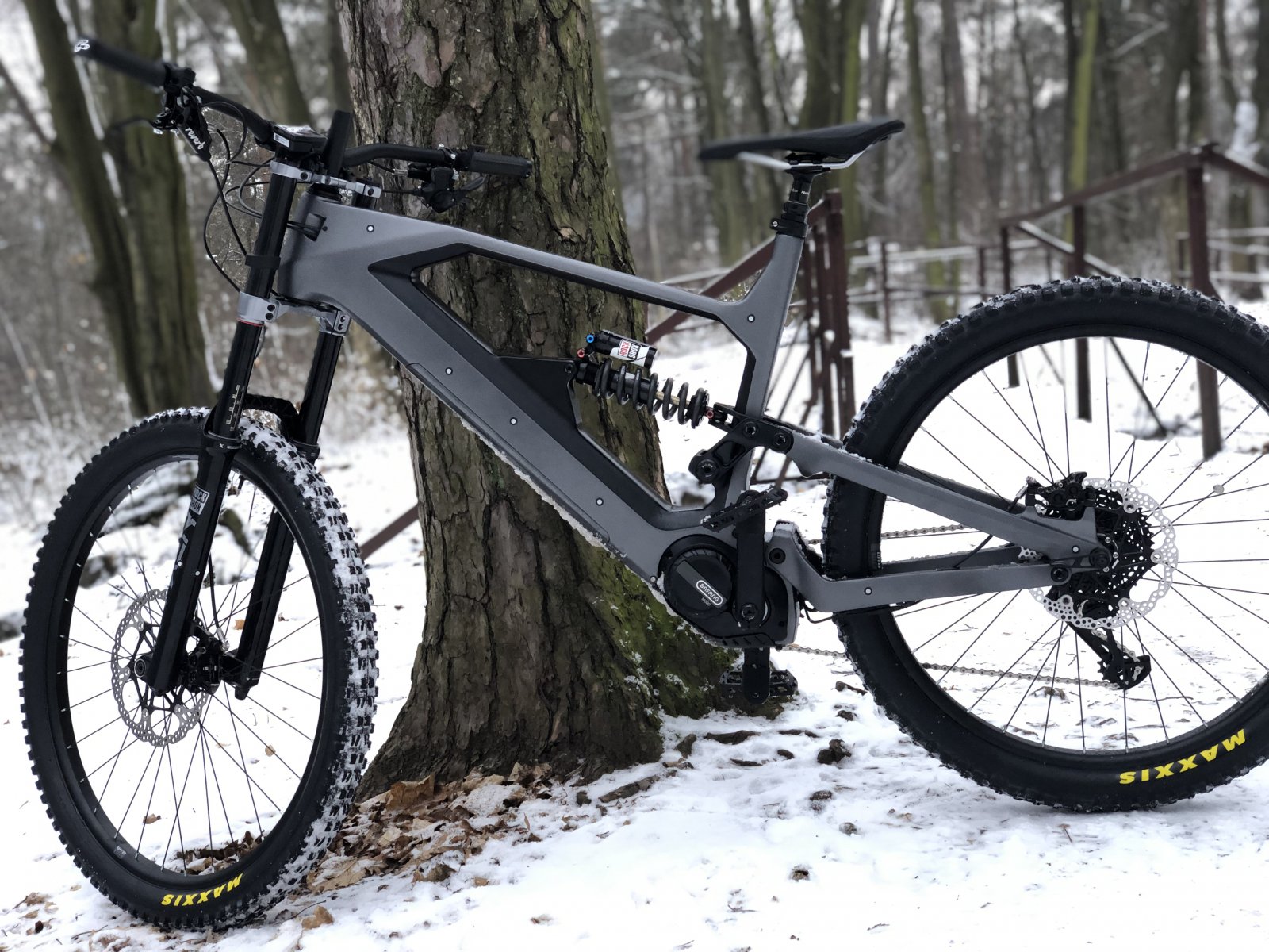

Very nice and top spec! Sure it rides like a trail iron! But 24 kg with coil shock, ZEB and DH tires? Did You use a custom battery? Mine with M500, Mezzer Fork (together appr. 0.8 kg lighter) and coil shock is about 25 kg with Dengfu 840 Wh battery…
I hv carbon wheels, ti spring for the shock, selle italia slr seat, 32t chainring, superlight carbon pedals..which helps to reduce the weight.
Roy68
Mar 4, 2021
57
36
UK Herts
I confirm you can get to sub 24kg with the M600 and 840Wh battery. Even with a coil shock my bike is just over 23Kg including a big 750lbs/in coil, like you I have the Mezzer fork. Here are some key areas where I looked to save weight:
I saved quite a bit of weight with Carbonal wheelset, carbon rims save a bit compared to Alu, and Sapim CX Ray spokes are really strong & light (but expensive), wheelset only 1630g with DT Swiss 350 hubs.
SRAM XD 'machined from solid' rear cassette save quite a bit compared to Shimano equivalents, but again more expensive.
Magura MT7 brakes, their carbotecture levers are nice & light, paired with shimano Ice tech rotors which are mostly aluminium, saves a bit more weight
And of course I use dirty cheap Chinese carbon bars:ROFLMAO::LOL:
But if I was doing the build again, I wouldn't waste time with all the lightweight stuff, M600 is so powerful I doubt you would tell much difference between components.

…and may be my scales are just a piece of shit, honestly! I used a body weight scale and a luggage scale - hopefully both are a little on the pessimistic side ?

I agree, the torque is insane and if the torque delivery is slightly more subtle, this motor is a real winner. I am only using PAS 1/9 for all terrain profile whilst shifting gears to suit the cadence. My only gripe is i have do micro ratcheting to avoid the surge of torque when negotiating gnarly technical climbs which really disrupt my flow.
Roy68
Mar 4, 2021
57
36
UK Herts
Yeah the torque delivery is kind of on or off!

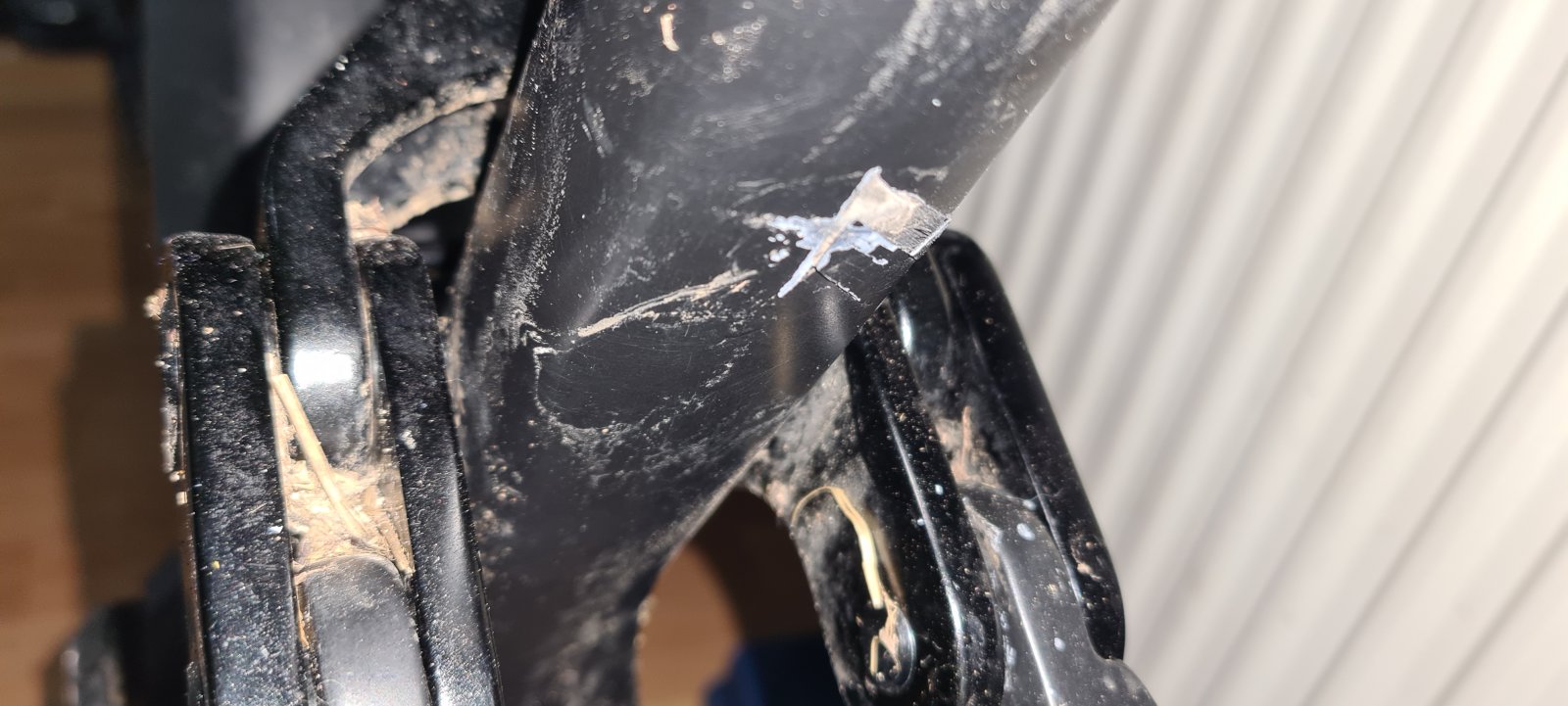

Hi just noticed this on the seat post any ideas as to how it happened I have a 216 63 rc3 shock

We said multiple times, that shock 216/63 is to big for this frame. Now you see why. Your rear probably "touched" seatpost.

Let me correct my wording, as maybe its not fully OK:
1) we dont know if really linkage/wheel hit seat post. Based on photo this is not confirmed, and maybe it was just rock/wood/debree hitting seatpost because of small clearance. Also we dont know what is rear wheel size and conditions of "hit". Big jump, or rock garden ride?
2) each bike manufacturer define leverage ratio applied (LAA) based on bike geometry, stroke and travel. If you change one parameter (wheel size), stroke (from default 55 to 63) it can have implications on travel size and how geometry behave during travel. Based on plain numbers, 216 with 63 stroke does not mean anything bad, if there is linear progresivity of shock based f.e. on different setup or just using spring instead of air. But, when running dirty jumps over 2 meters, this must be not just calculated, but also correcty set/tested based on common knowledge/experience with of shock behaviour and frame geometry. And one must expect, when I use longer stroke i must expect longer travel, so adjustments of shock and tuning must be done correctly, as margin for error (clearance) is probably less then using 210/55 shock.
I did one test with mine 210/50->55 and 216/63 on Mframe. both debonair, on 216x63 with maximum travel linkage was 1-2mm from frame, meaning that if i fly to hard drop or catch a wood, there is near zero clearance. I am confident, with some buttons on shock or increased linearity this can be handled, but i didnt go this way. In case yes, then shock with coil is from my POV preferred way. But i dont assume this as "test", more like as "observation".

Ok it's my own fault just noticed put my offset bush in the wrong way it's still hard where it's peeled so going to to send it down and put a couple of layers of carbon on there are hopefully we'll be all good
I've seen much worse carbon issues fixed in the past (only on youtube though!), not done it myself though! Looks a fairly easy spot to repair though.
Here's the video I watched (they hacksawed the chainstay to test how easy it was :eek::

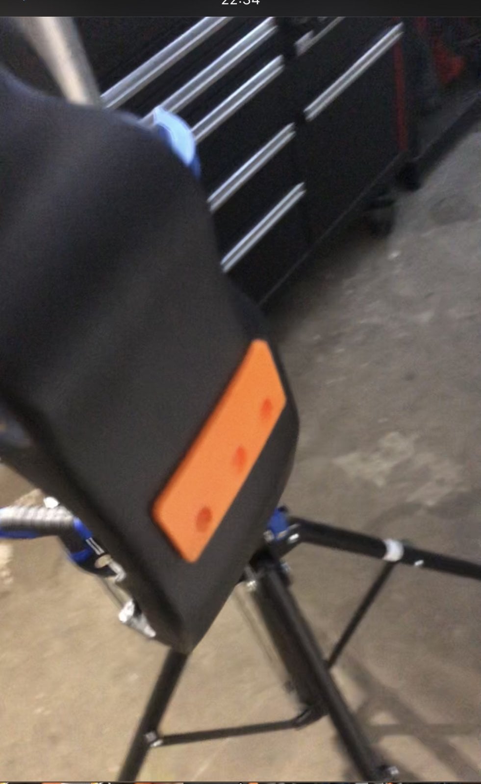

Pav09990
May 16, 2021
15
31
Poland
You can down Hill with the brake lever in this position ? what is the function of the white points on the frame ? ( to make the curious talk :sneaky: ?)
This photo has been taken with some portrait Option on the phone .Brake lever is normal position .Litle reflective dots on frame are reference points for 3D scanning

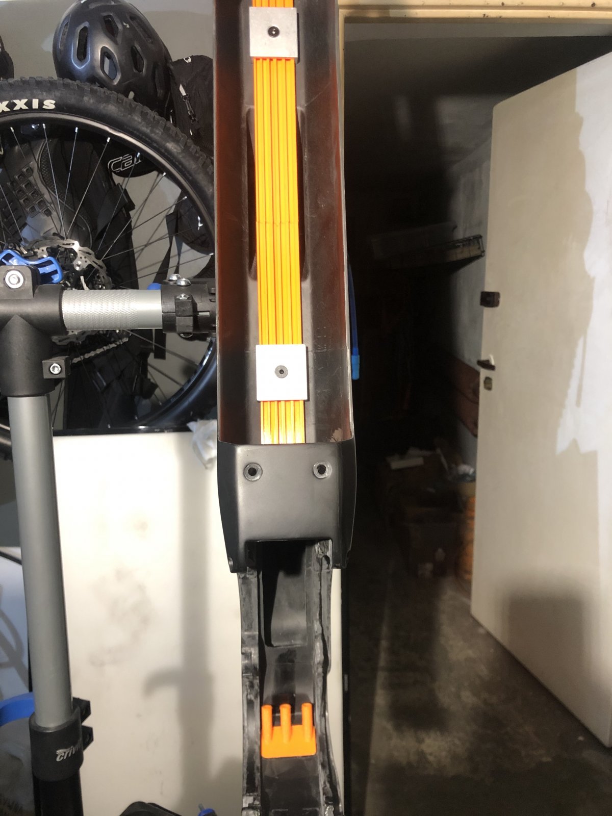

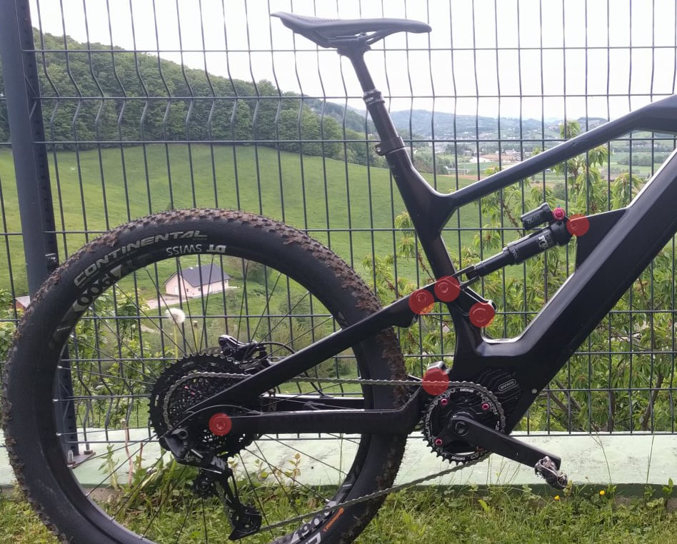

i marked related spots with red circles. i am parktool guy, so green lube from PT used. But any apropriate will do. In past i used from ATE Germany. Picture i used is bogdans machine :), hope its not a problem.
So you removed all bearings from frame and greased frame housing and pressed bearings back in? I’ve noticed mine makes a lot of creaking noises. Do you need to grease motor bolts where they tighten to the carbon As well?

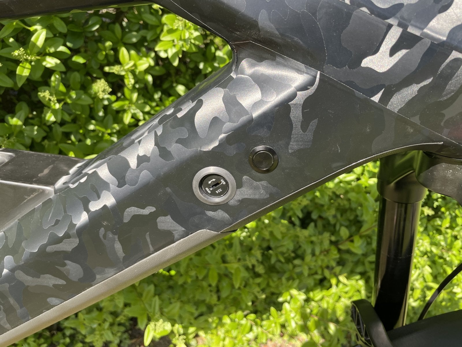

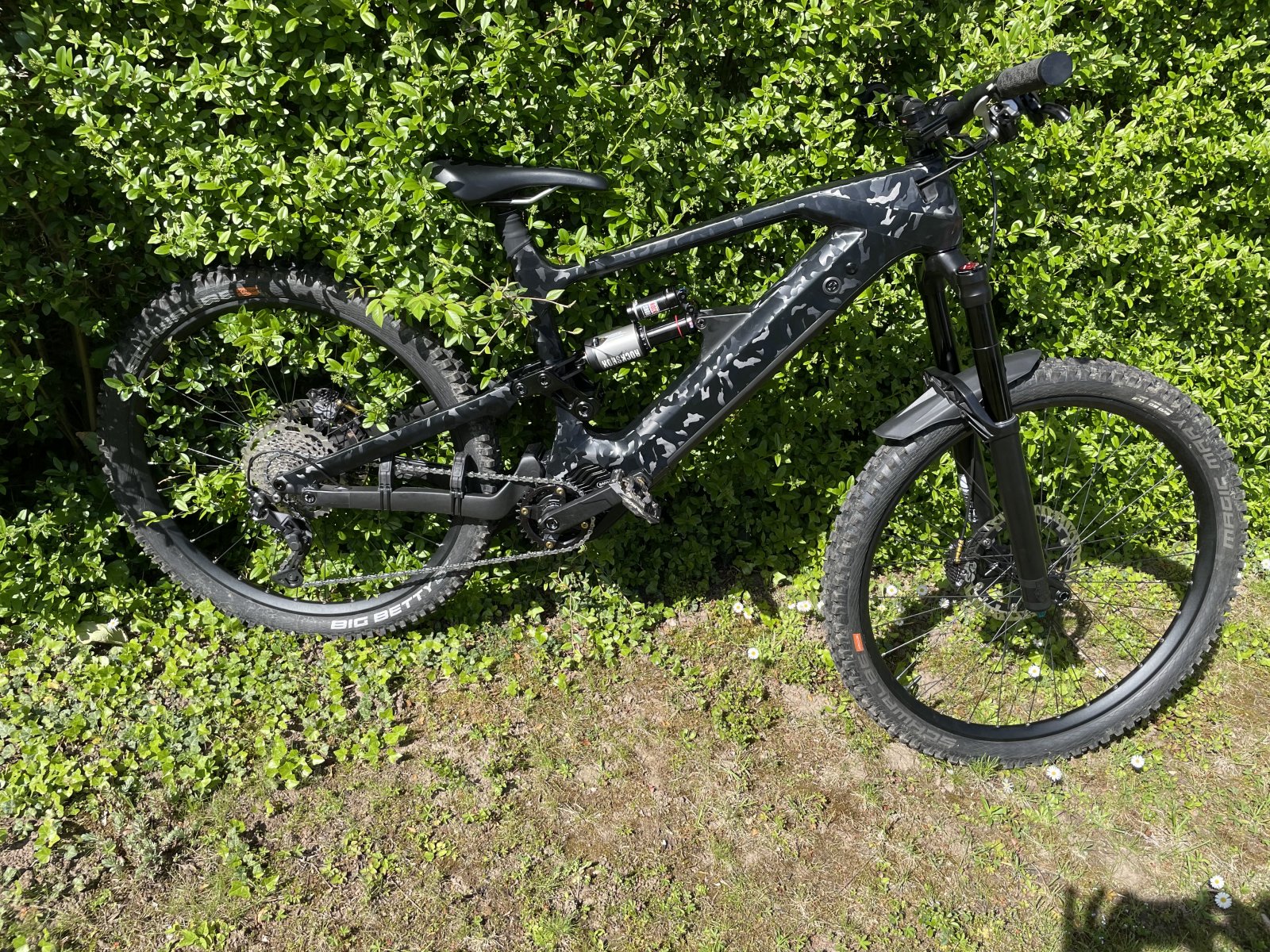

I did some foil wrapping the last days, to give the frame a bit of protection. Plan was to use the 3D camo only on some areas. Ending up with a fully wrapped frame (after almost complete disassembly), some mental breakdowns, 1sqm of expensive foil wasted and replaced, and one destroyed heat gun. I‘ll NEVER do that again. Is ist worth the effort? Time will tell...
This looks great. I guess the project you started and regretted 👍🤣
