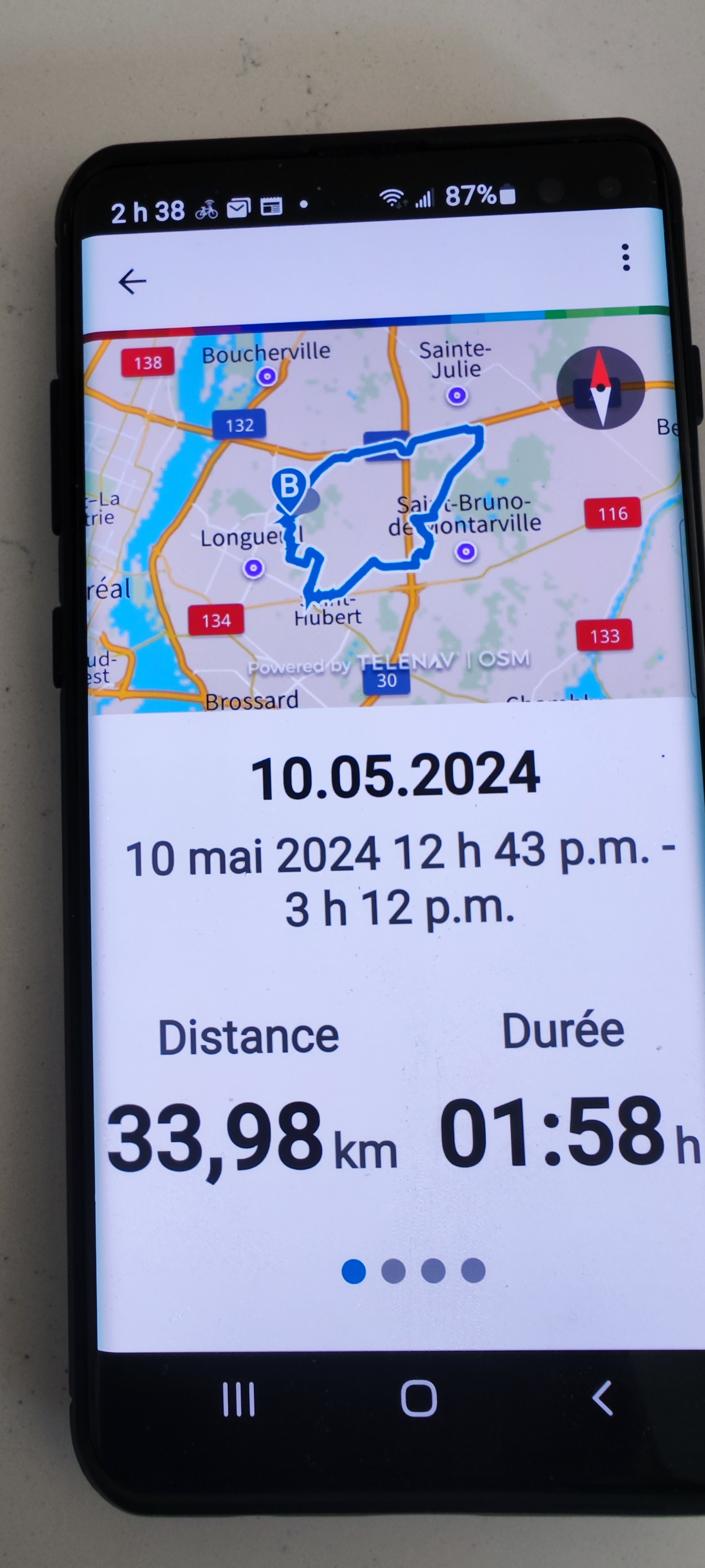

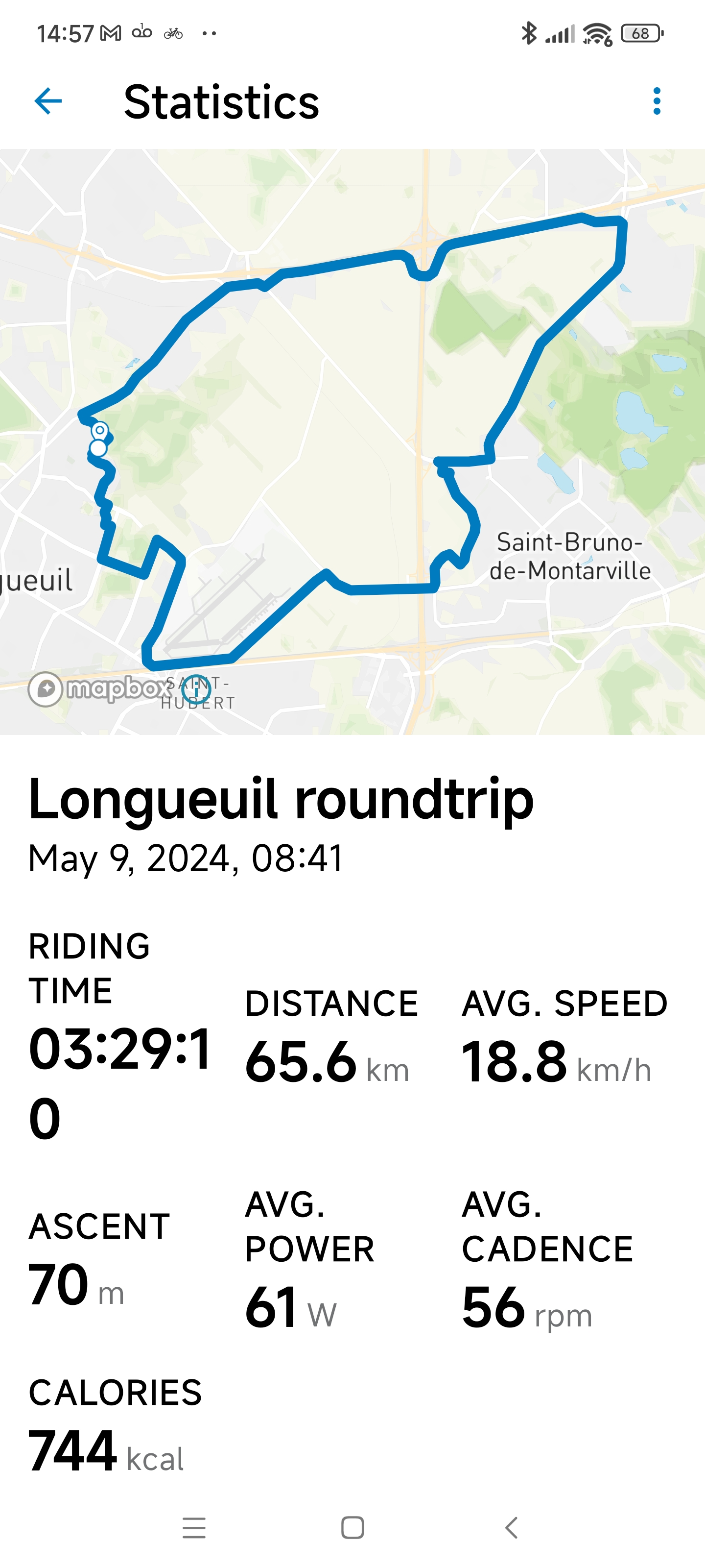

WOW!!!!WOW!!! WOW!!! "Bosch Smart System" is it so smart???
I Only have problems with this "Bosch Smart System" and Bosch TAKE SO LONG TO ANSWER ME....I still waiting for answers from Bosch 2 weeks now
I got a New R&M Nevo 4 with 750W Battery and Kiox500 look like every ting was OK until I realized sometimes it save my Rides sometimes NOTING is SAVE, a lot of times it not save the Today ride and tomorrow it save the ride from the day before and add it to today ride with the accumulating Km from yesterday and today,like I did 43 Km yesterday and today 34 so I will have 77 Km and the date is from yesterday...!!!! also If I starting ride from point A and return to point A again but if I stop anywhere it save ONLY from point A to where I was stop and it show me only the ride from point AS to where I stop point B but NEVER show me the completely ride from point A my house to my house again soon I stop this is it save only that even I return to my house... I missing my old Bosch NYON a lot
I look in my phone before the ride is CONNECTED I check the settings on my phone I change phone and still NOTHING change

Look the images of my Kiox500 "Smart System" and my wife Nyon same ride
