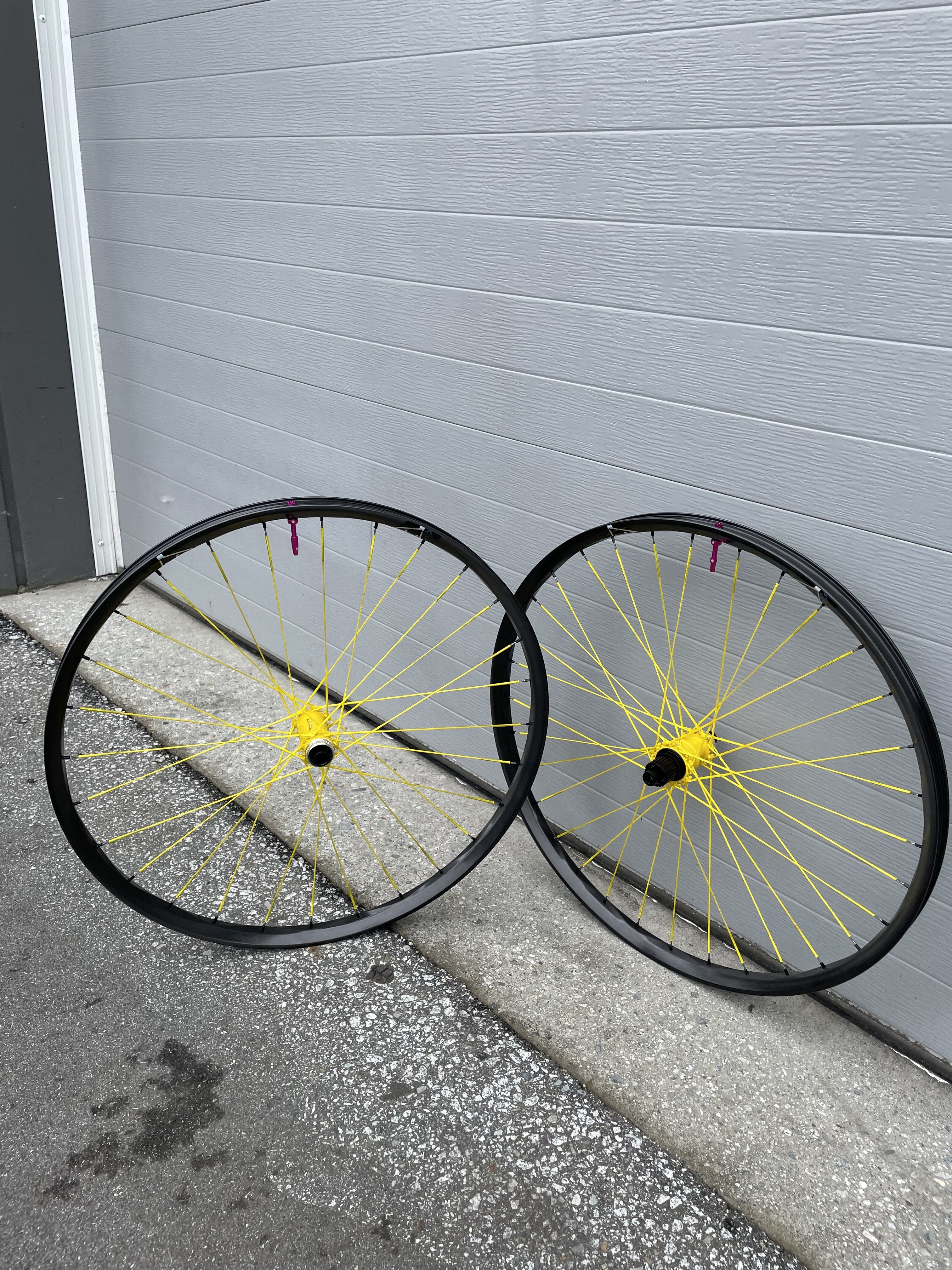

I started out with aluminum rims, then found out I could use an old carbon rear wheel (NOX AM 275 on King hub, Sapim CXray spokes) with an adapter (142mm to 148 boost). Night and day difference for me on the rear wheel. It’s stiffer, doesn’t squirm around, tracks better and can schralp berms better. My front is still the stock aluminum, it feels good. I’ll probably change it to a Carbon rim one day.
the rear wheel made a big difference for me where I ride. The bike is a gen 3 Levo expert.
Wow. I haven't thought of a "material mullet". That is something to think about and definitely the change can be done one at a time if curious.

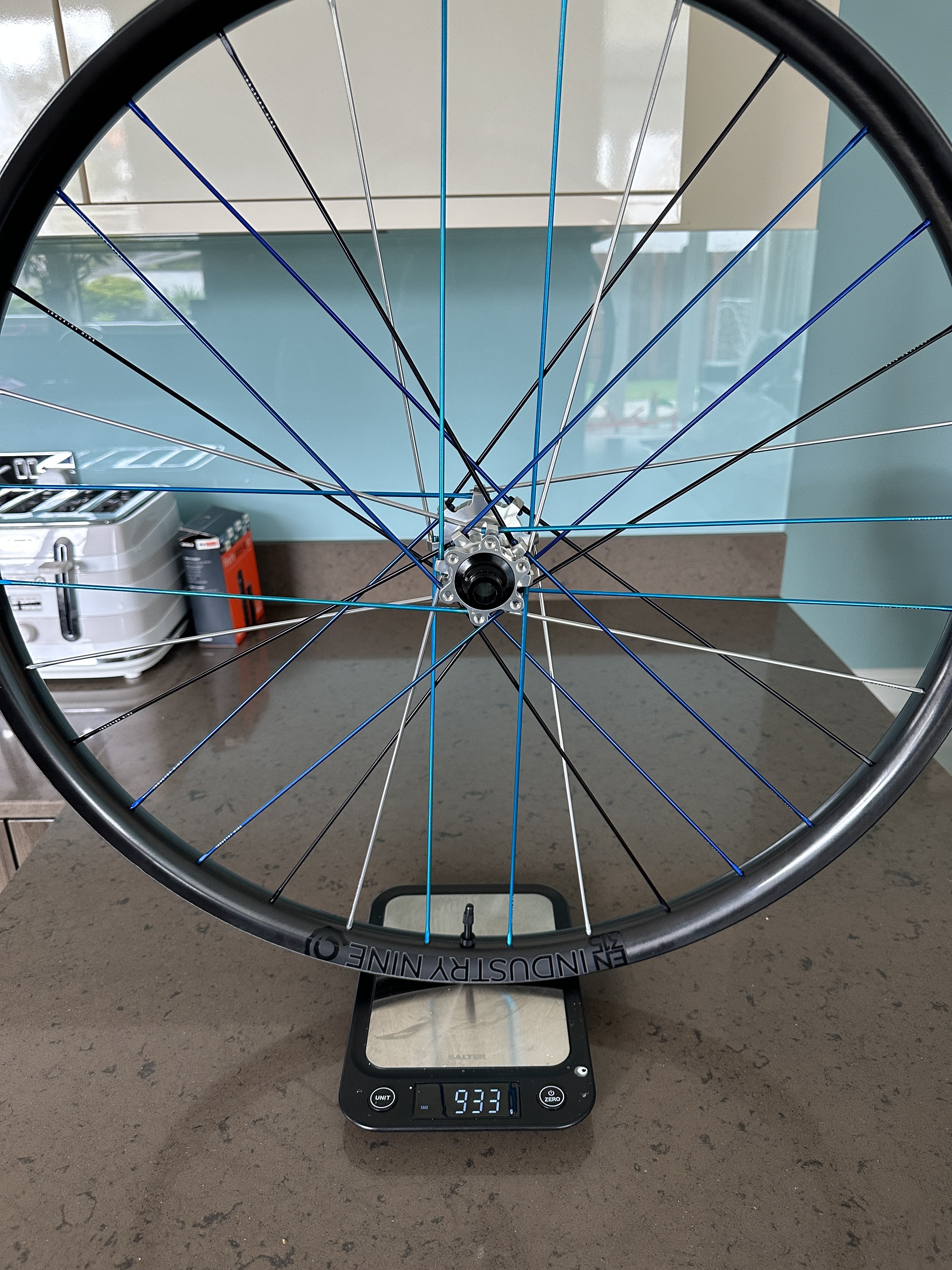

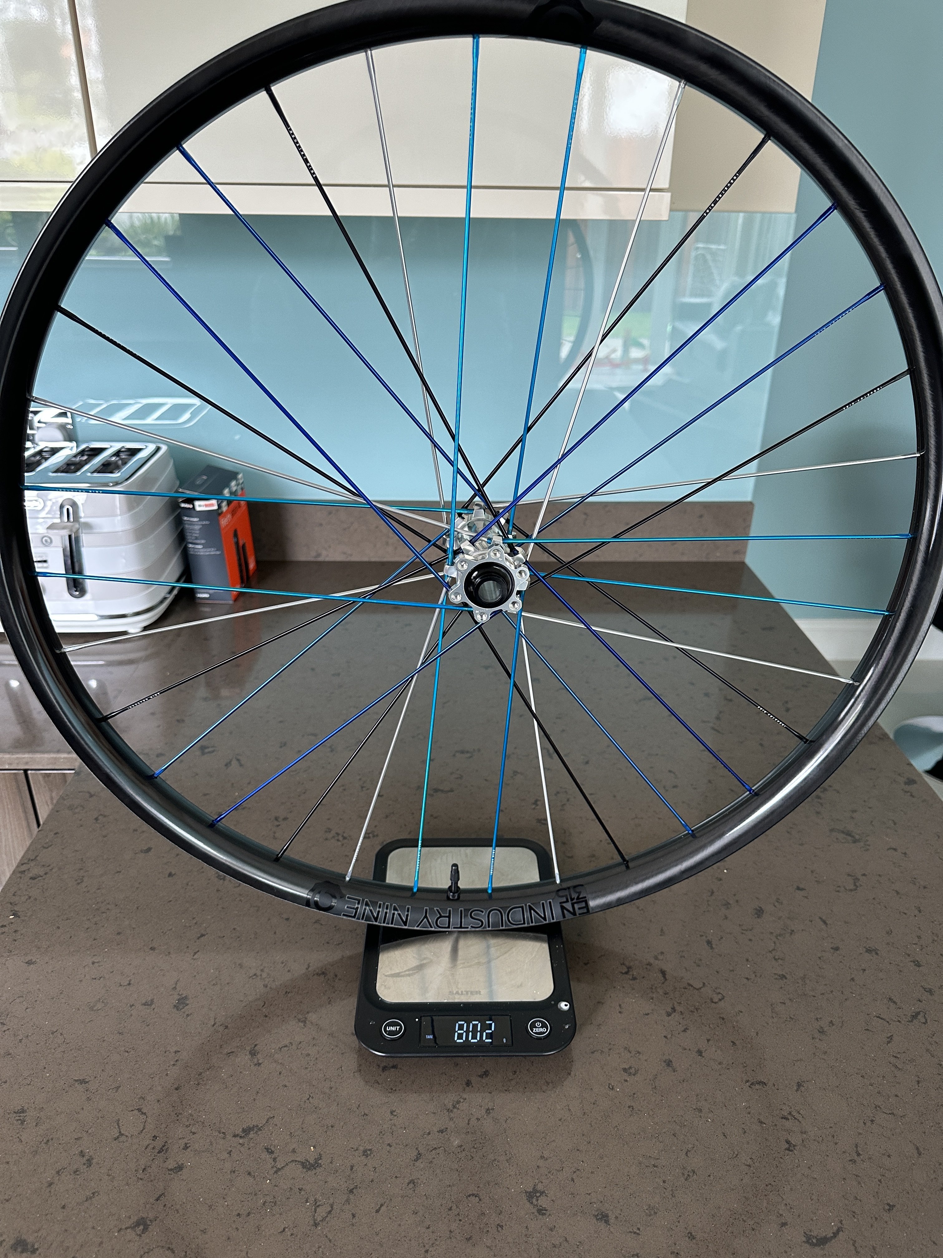

I’ve just bought some Industry Nine EN 325 rims - which are designed for Enduro / Aggressive riding. A perfect pairing for my Levo SL.
i9 do a GR series which is designed for downhill and e-bikes. There’s also some super light trail rims. They have a whole selection of MTB rims in carbon designed for different purposes.
That’s one manufacturer. If you went through all the wheel manufacturers, there will be lots of carbon rims specifically designed for e-bike use and different disciplines. They’ll be more expensive than their alloy counterparts, and probably a good bit lighter.
The choice is yours. If you have extra cash that you’re willing to spend, I’d go with carbon wheels that are suitable for your application. They’ll last years without adjustment, and generally come with a lifetime warranty. If your conscious of the cost, then get alloy

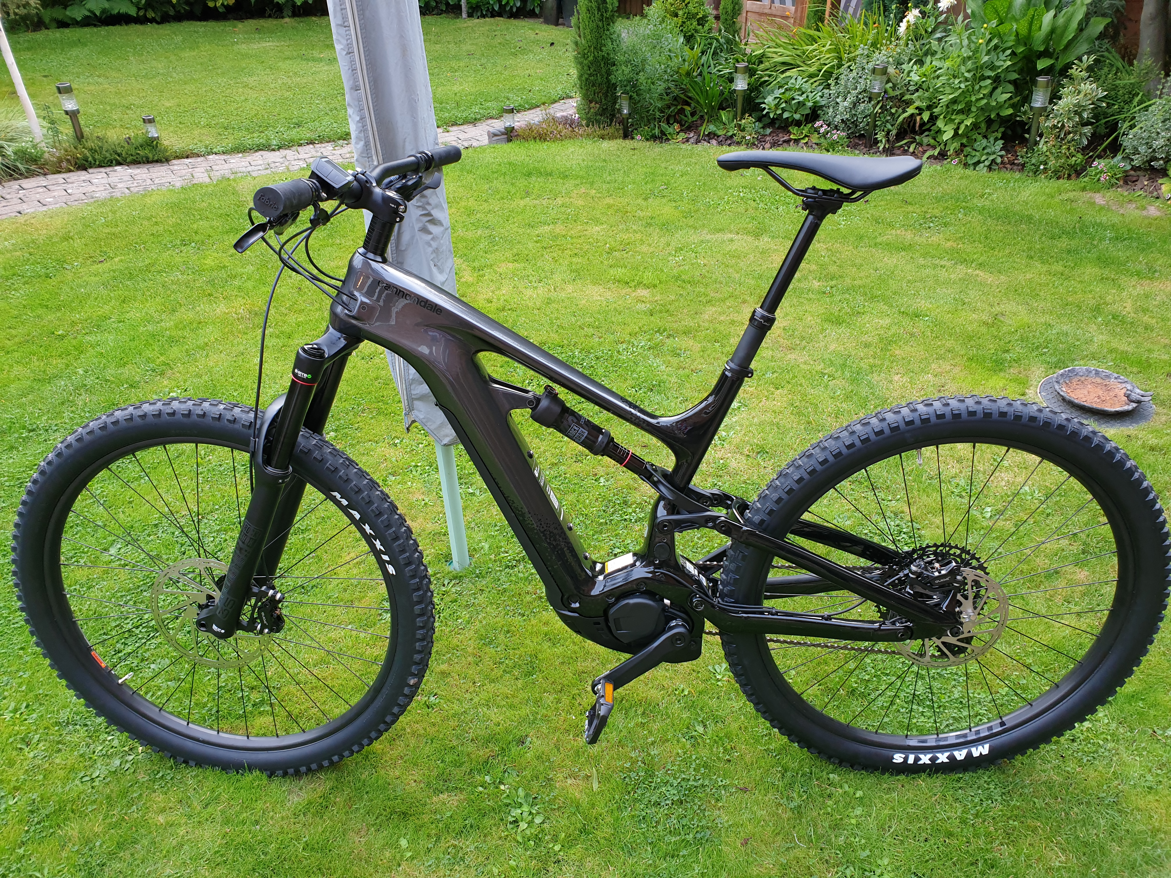

Loppy Lou
Mar 22, 2022
25
38
Bristol

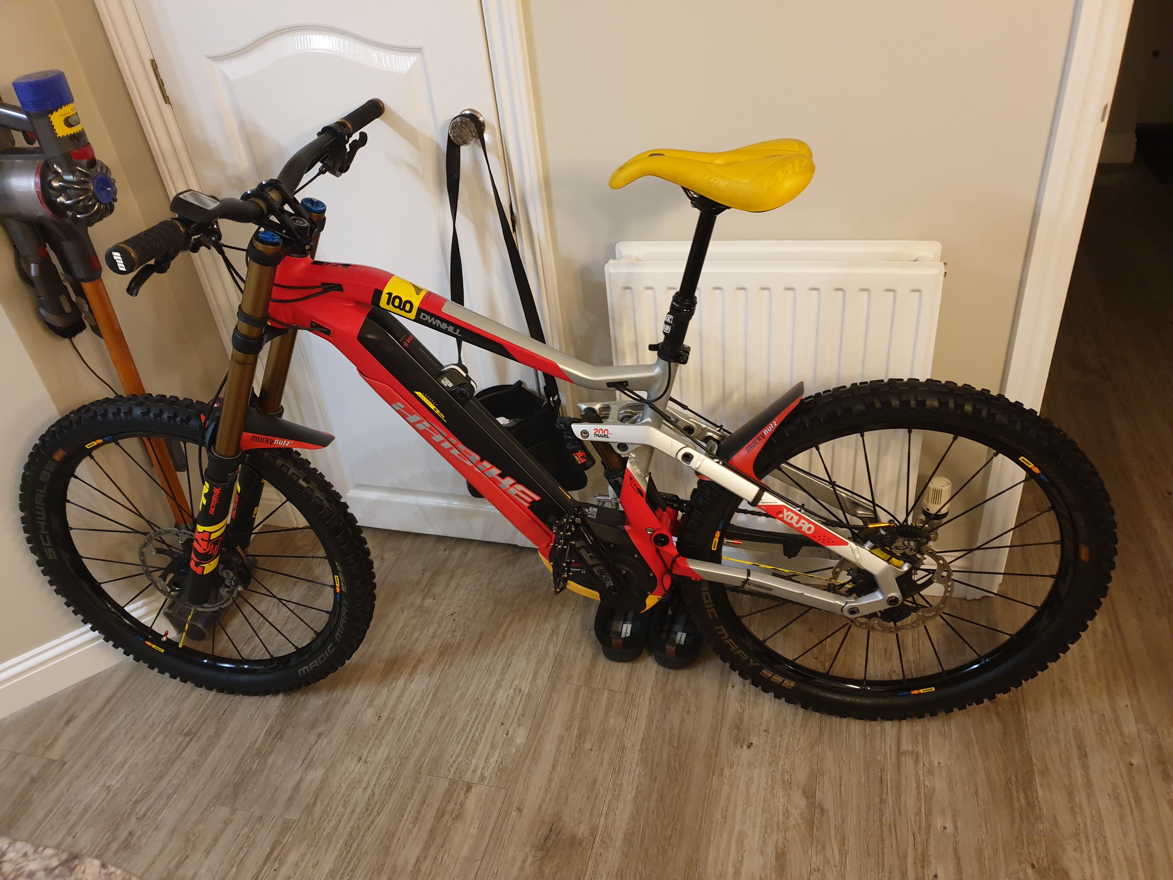

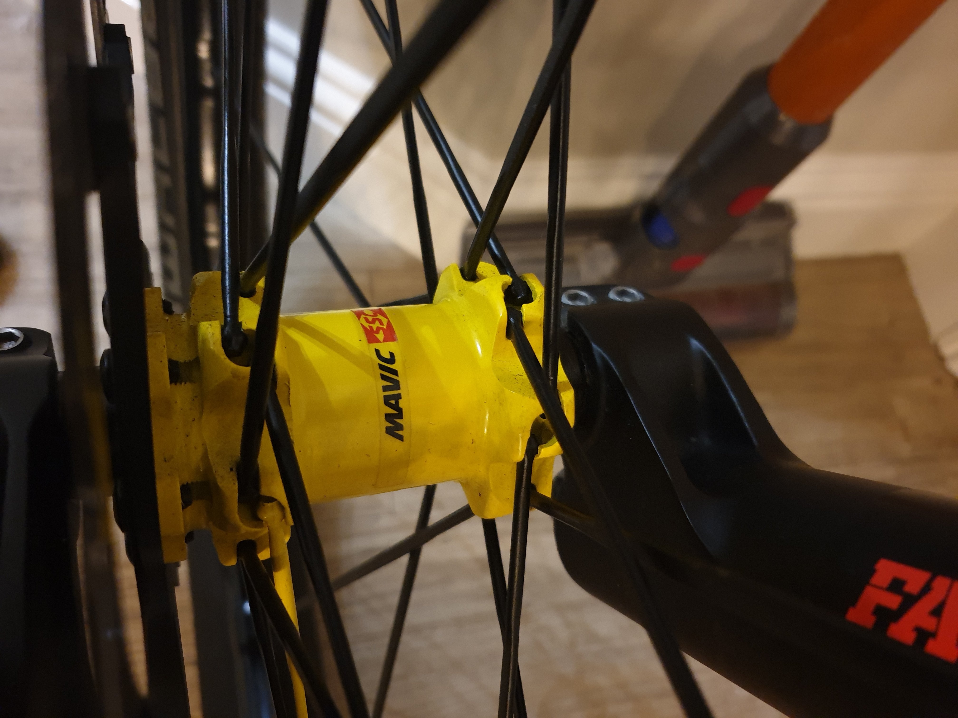

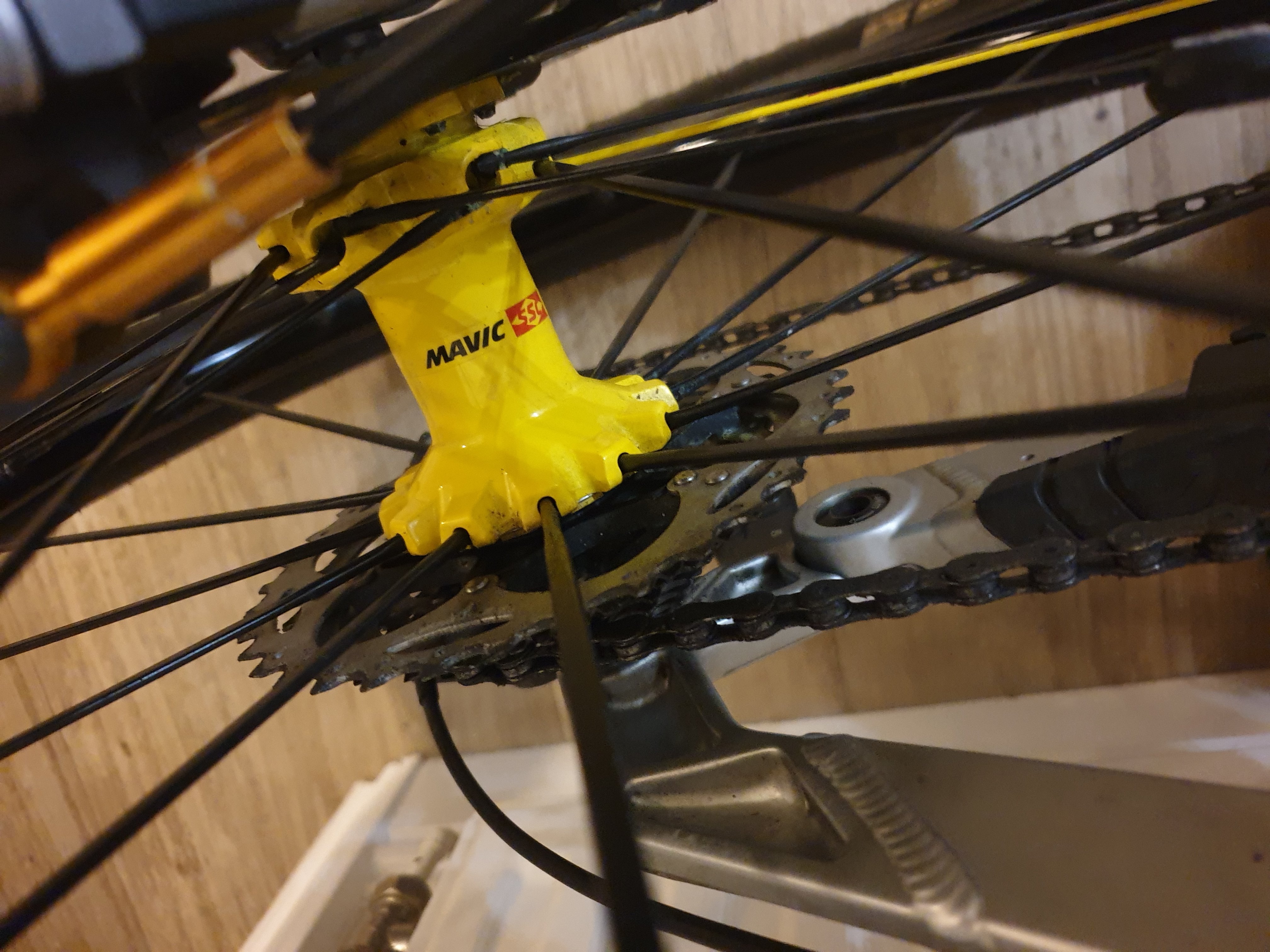

I have Mavic carbon rims on my Hiabike Xduro 10 downhill bike, they were fitted with tubless, but I struck a rock on a knarly decent and it caused a leak through the carbon which I couldnt fix so had to fit a tube. On the aluminim rims on my other bike they just take a bit of a dent but the wheels keep going so I would put to you. If your doing a lot of uphill fell typoe riding and want to save weight, and day long trails then its probably worth it, however if you ride for around 11/2 to 2 hours like I do on knarly trails with lots of lose rocks and do some downhill then stick with aluminum due to the durability. I would swap my wheels around between my bikes but the Cannondale is 29" on both and the Hiabike is 27.5 on both.
20220115_230552.jpg 20220115_230830.jpg 20220115_230841.jpg Cannondale Moterra III.jpg

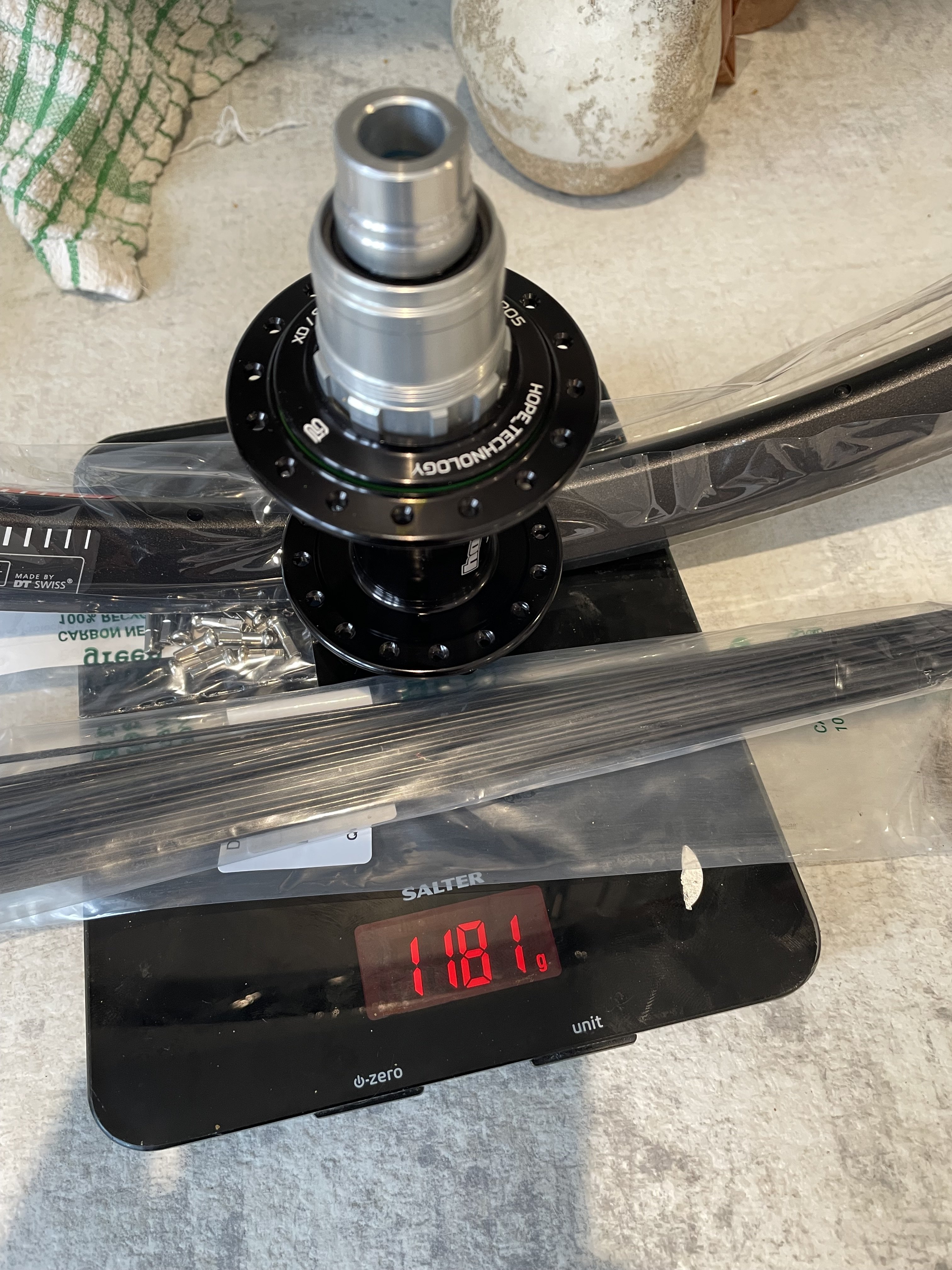

p3eps
Dec 14, 2019
1,900
2,276
I can’t really feel any difference between alloy and carbon.
I prefer alloy these days. Easy to buy new rims if needed and relatively cheap.
Builds are also nice and light. A good build will also give you plenty of strength.
I’ll be building this tomorrow.
Pro 5, 32 spokes, DT Swiss EX511 29’r
Still 250g heavier than a 29” carbon rim - which is already taped and has a valve too.

p3eps
Dec 14, 2019
1,900
2,276
Yeah, they are nice rims.
I’ve had light bicycle and Nextie and Santa Cruz reserves, all really nice rims. I personally think the EX511’s are just as good for my needs. 👍
I’m not saying the carbon rims are any better… both have their pros and cons.
The EX511’s are a comparable rim to the i9 EN315’s - focussed on Enduro and aggressive riding.
Probably 450g+ difference between them by the time you’ve got valves and tape on, but I’d imagine a hefty price difference too.
You could lessen the weight difference with a different hub… as Hope are pretty hefty compared to some others.
If you’re riding a 25kg bike, then I imagine £1000+ to save 450g is not even a consideration.
My Levo SL is 17.1kg, so keeping the weight down is important to me. I could have gone with rims that are 400g+ lighter (and cheaper)… but then I’d be sacrificing quality and they’d potentially snap with my riding!
