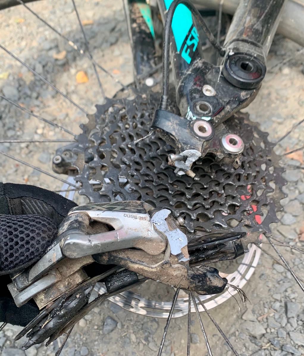

Likewise. But I also don’t have any interest in removing my chain after every ride, soaking it in hot wax or any of the other BS people do on here. When I bought my Kenevo, I saw the religious drivetrain maintenance people do and decided to try my usual approach- hose it off when it’s dirty, lube it sparingly before I ride, pull it off and soak it in diesel at the end of winter.
I replaced the drietrain for the first time somewhere around 1500miles because when I smashed the mech off at dyfi in 2021 it took the chain with it. Second chain/drivetrain is still on there now and seems quite happy.
