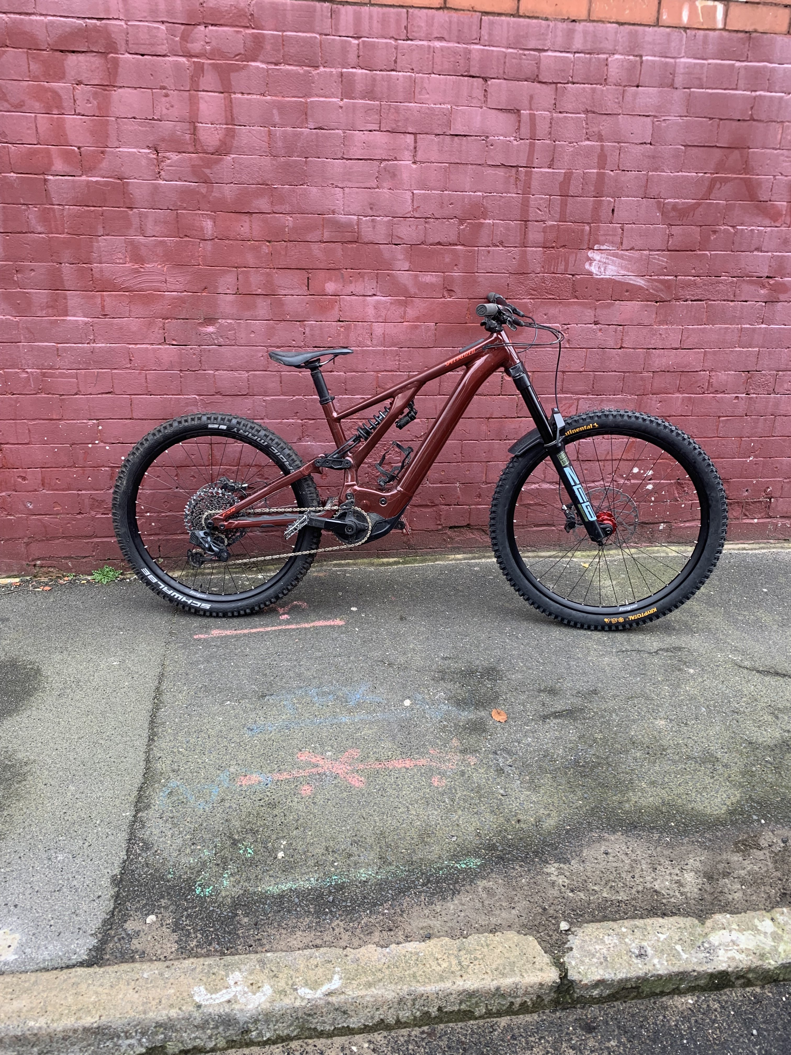

Hello All, I have just bought a Kenevo for what I would say is a good price. Had a few shots on a Levo first but always felt a bit 'over the bars' on it. Anyway, I am wanting to venture into the 29 wheel size world. I don't have much of a budget at present so am thinking of going with a mullet set-up to start with, the thing is I don't want to slacken the head angle any more than it is stock. Reading through loads of old posts on here, it appears a 160mm 29er fork with a 44 offset might be the way to do this - can anyone offer any advice here? Thanks
Depends on the fork, I wouldn’t use a fox34 or a pike( or any lesser fork). Definitely up the air shaft to 170mm as 160mm will lower your already low bb.
uamvar
Aug 22, 2023
20
Ok 170mm it is! Thank you for the assistance chaps.

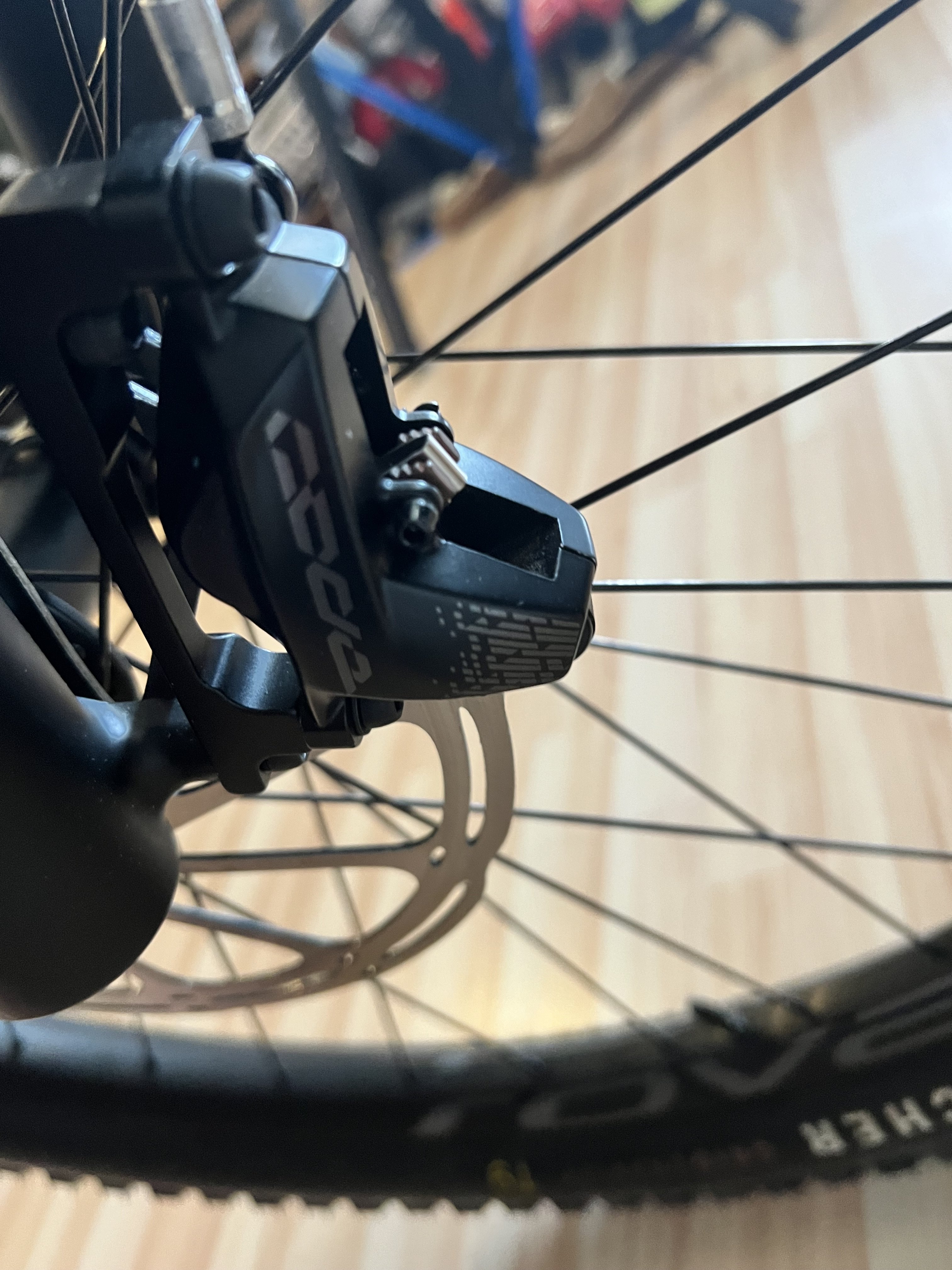

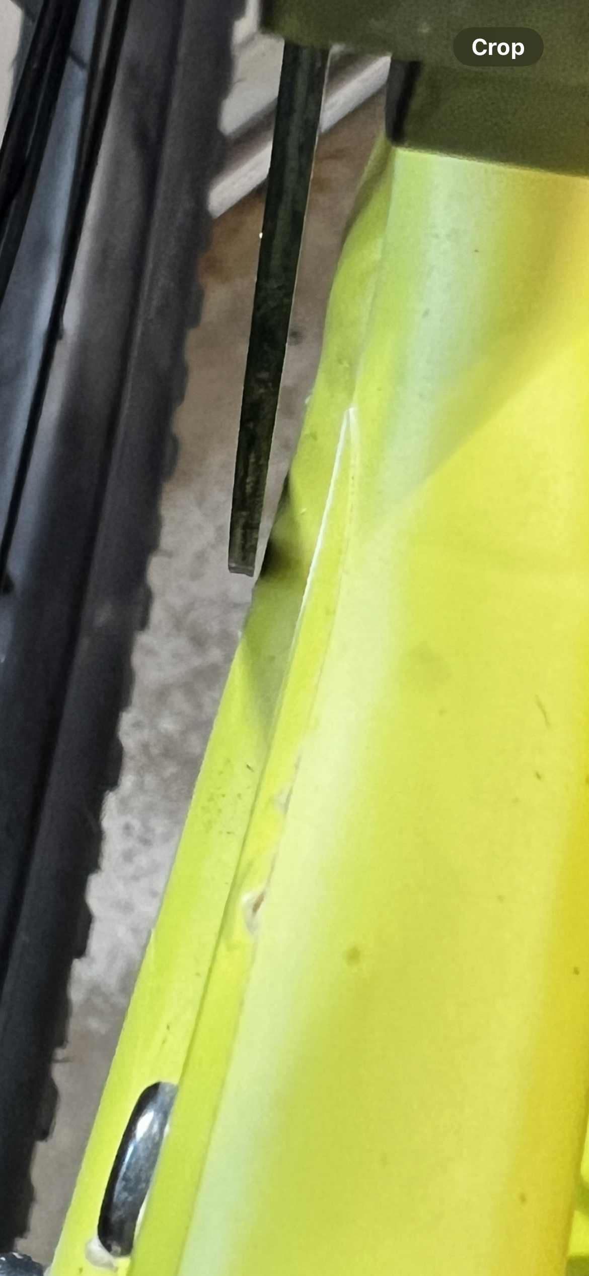

Hey Guys, I'm new to the forum but have been following this thread for the last few months and finally got around to completing the transition to a 29er Kenevo. I sourced a few take-offs from other bikes for the build. I bought a Zeb Select 170mm fork and some Kenevo SL 29er wheels. I did not notice before swapping the wheels but the rear disk is extremely close to the frame - a credit card is just about all that clears. Is this normal? It does not rub the frame.
If this is not normal, any suggestions on how to increase the clearance?
Thanks,
Andy
Mk0
Nov 1, 2020
Helsinki

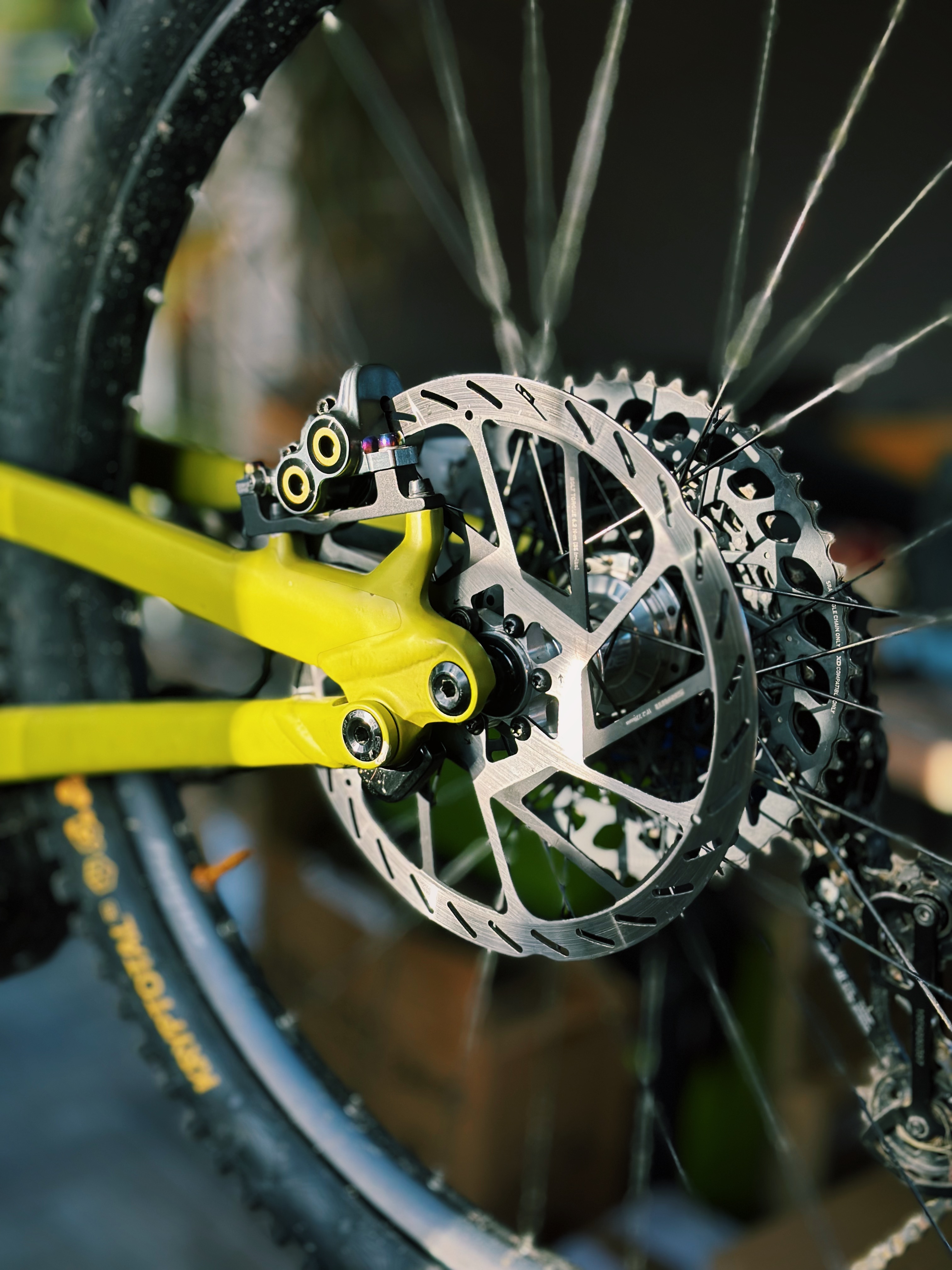

Struggling with the same issue and found one wheel+disc that doesn’t work with the frame.
I am using DT Swiss only and it is really close but working with 1501 and 1700 series wheels (240 and 350 hubs) and TRP 220mm disc but the 1850 series wheel (possibly 370 hub) was that didn’t work.
It’s not about the size of rotor in my case when it’s grapping from inner part of the disc.
Went to the local dealer and we tested also other wheels and frames to find out is there something in the frame. Is is like that and the best combo was some random spesh wheel (no dt hub) and SRAM disc.
Will continue with small clearance even it hurts my mind when building bikes for enduro durability…

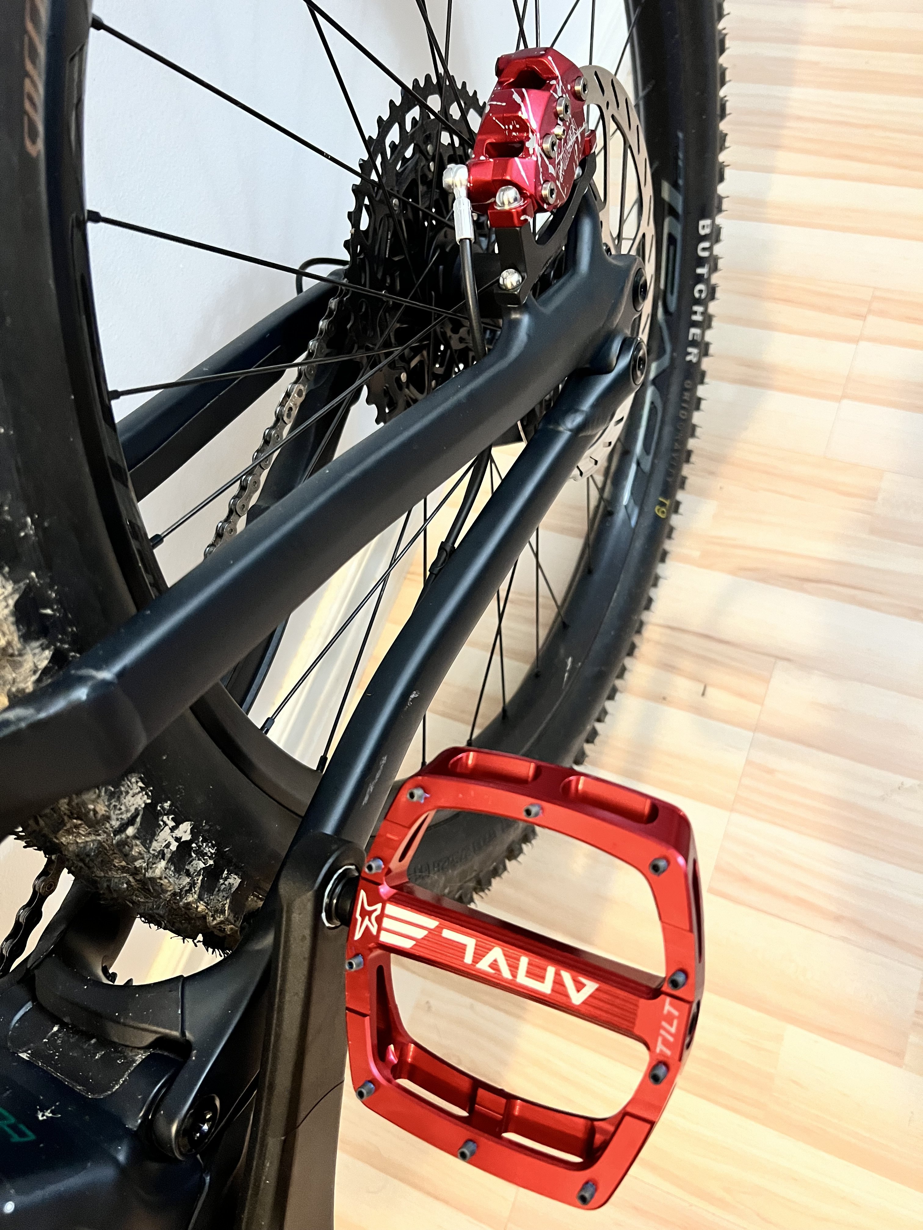

I’m running 220mm rotors with Hope Fortus 30 on Pro5 hubs. I cant say I’ve noticed this issue. S3 frame.

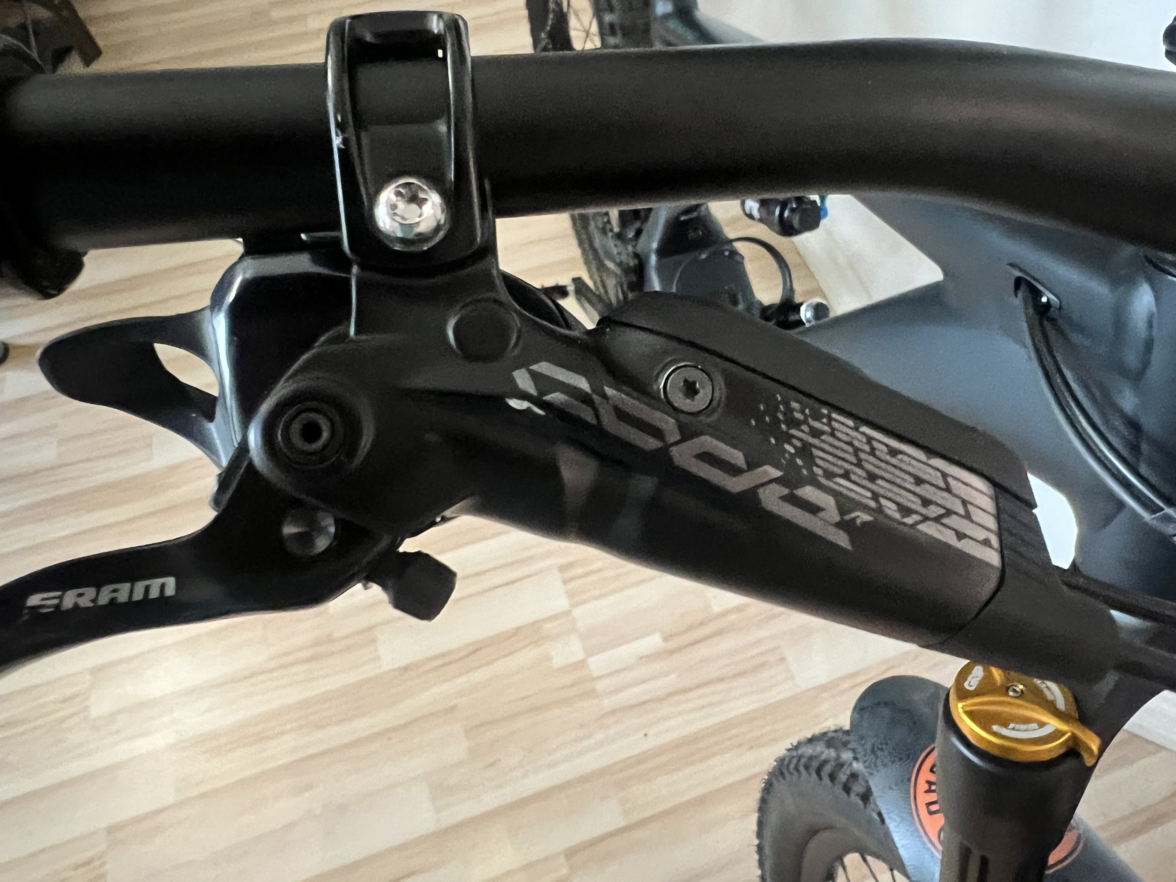

I must have those brakes..... the SRAMS that come on this are awful. I often wonder what they actually put in that huge box at each lever, maybe they are considering using one of them as the venue for the next Superbowl.

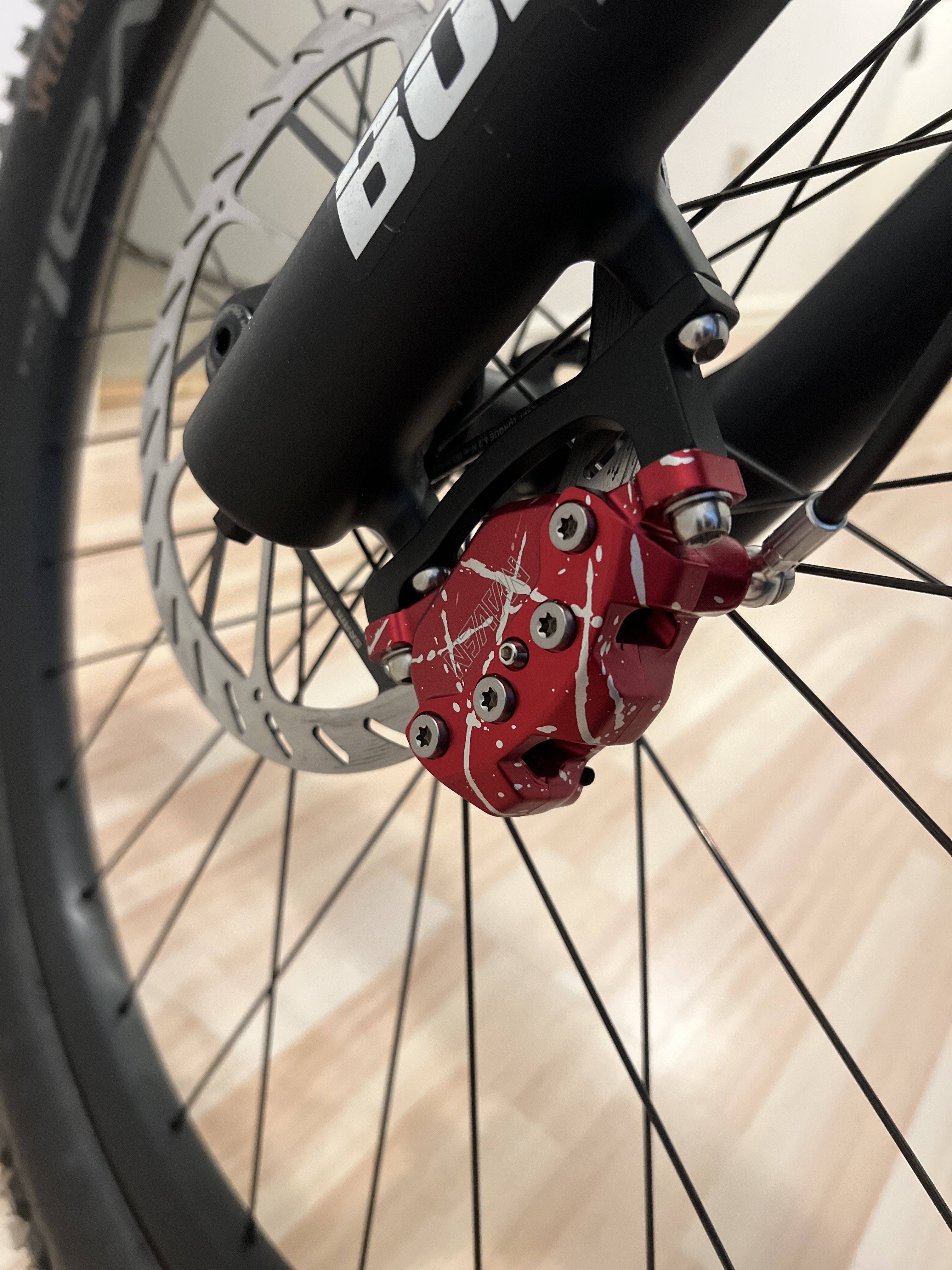

I have:-
Shimano Saint Levers
MT7 Pro calipers
Galfer Purple pads
MDR-P rotors (this pic is where I have temporarily put HS2 rotors on as I warped the rear MDR-P and it’s near on impossible to true back up as they are 2 piece).

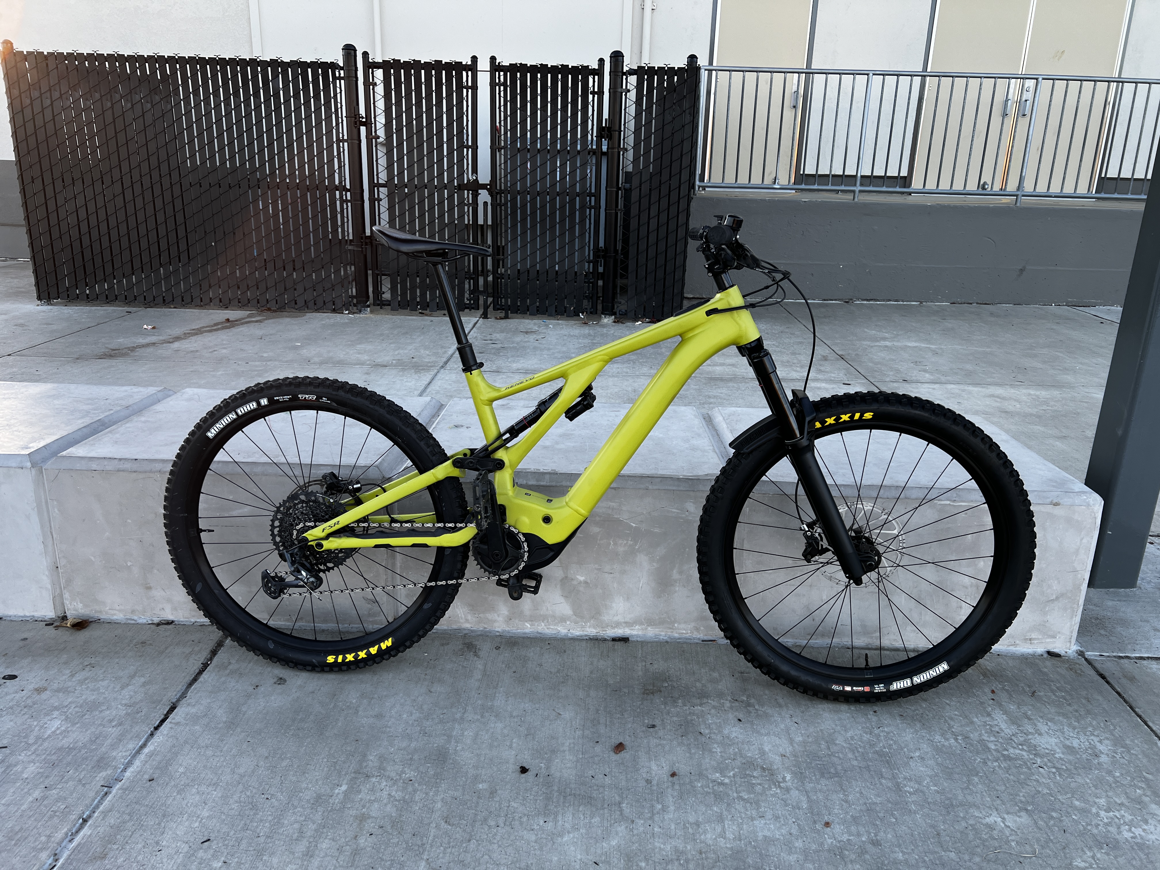

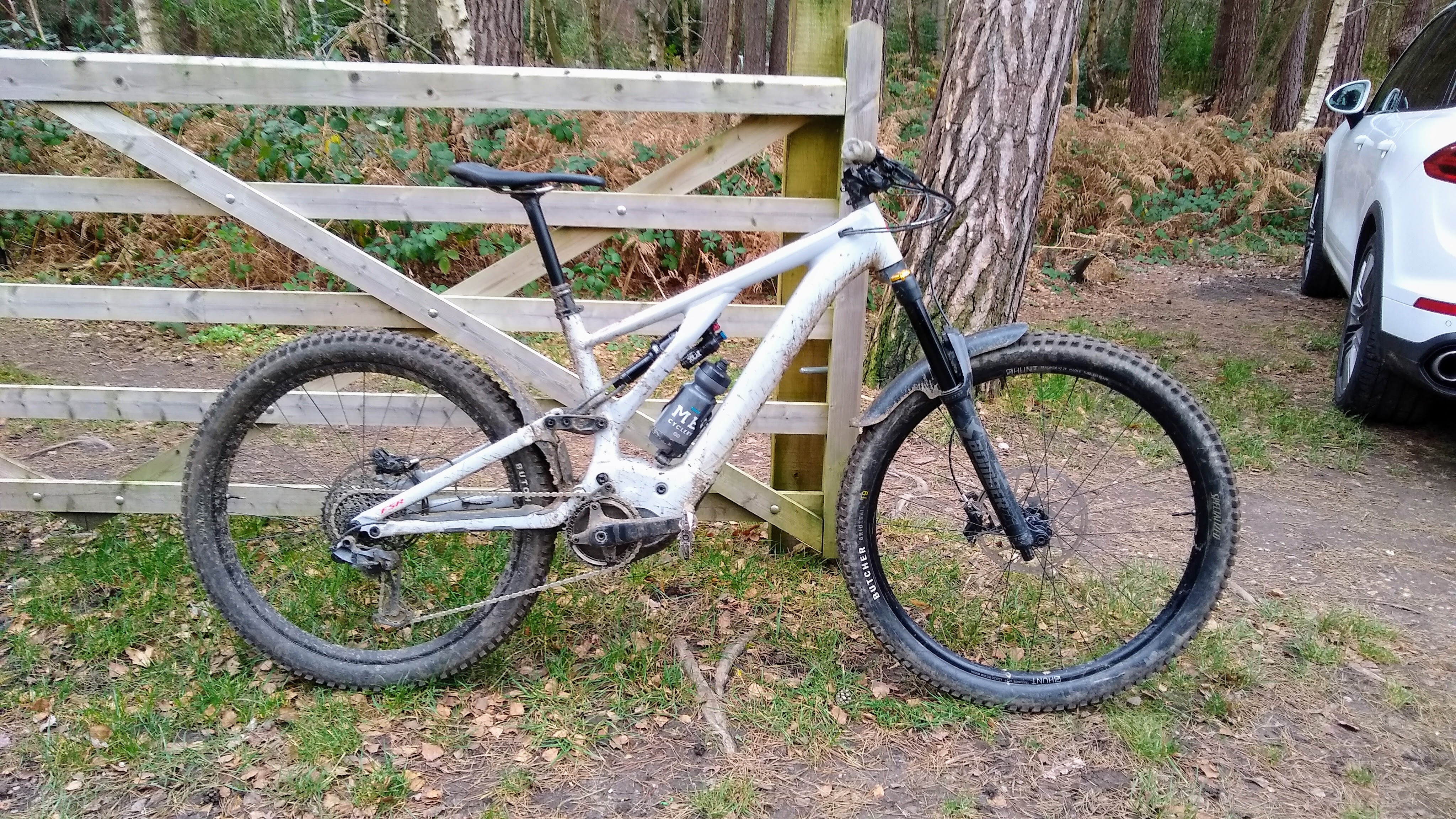

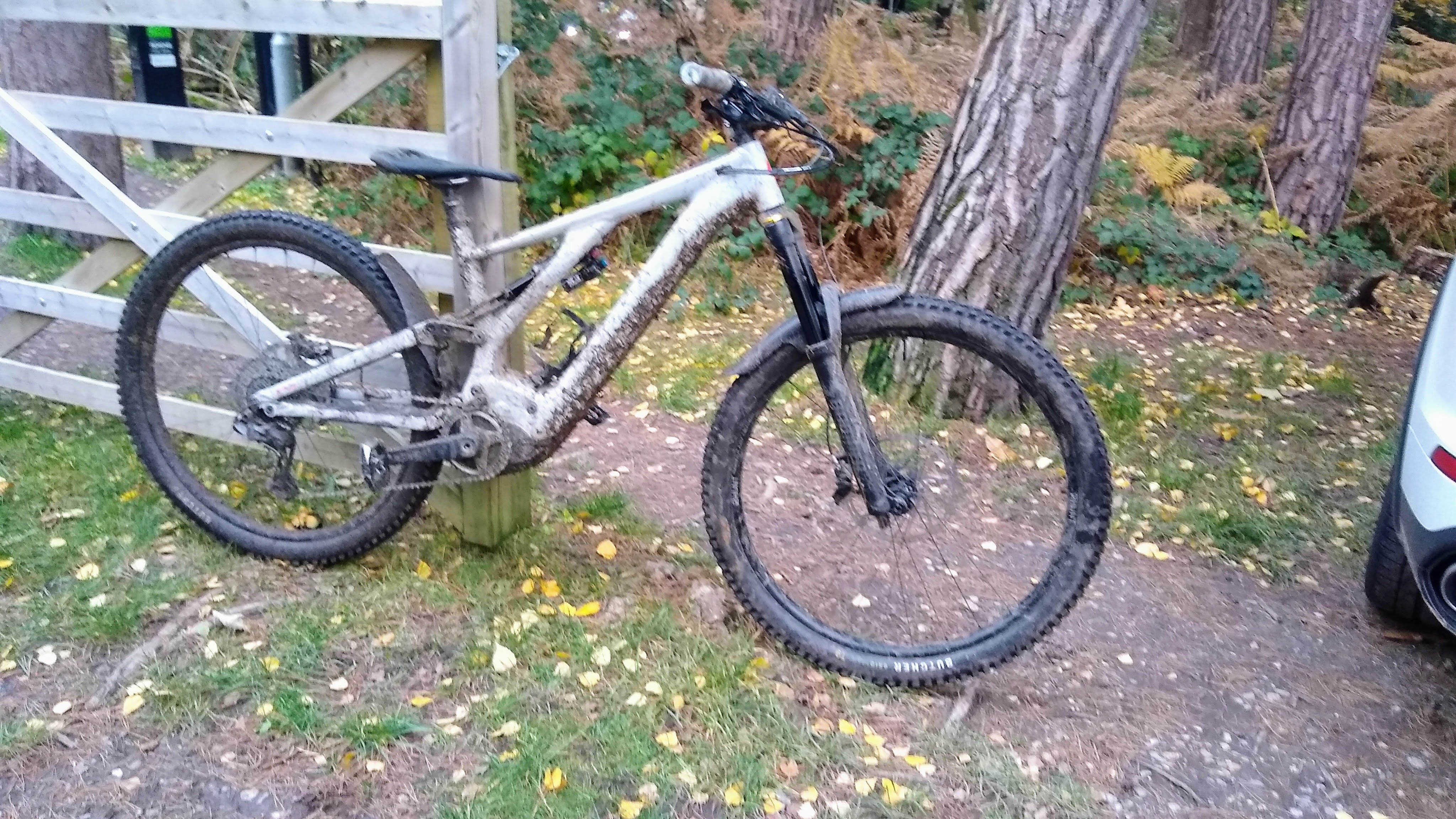

I’ve just gone MX or MWS, only one ride in, but I might prefer it to the full 29er, which is a genuine surprise to me, managed to keep the geo sensible (BB height and head angle) as I run a Bomber Z1 at 170 up front and using a 2.6 rear tyre, chip in high position.
I can recommend using:
Bike Geometry Calculator - MAD SCIENTIST MTB
to get a good idea of what changes to all the geometry any of these changes will make, I found it to be very accurate.
Every time a read the geometry chart for the latest greatest Enduro e-bikes I compare them to the Kenevo and they are always so close, it was ahead of its time and it works great with all wheel combinations.
If it isn’t obvious the top picture below is the MX and the bottom is full 29er.

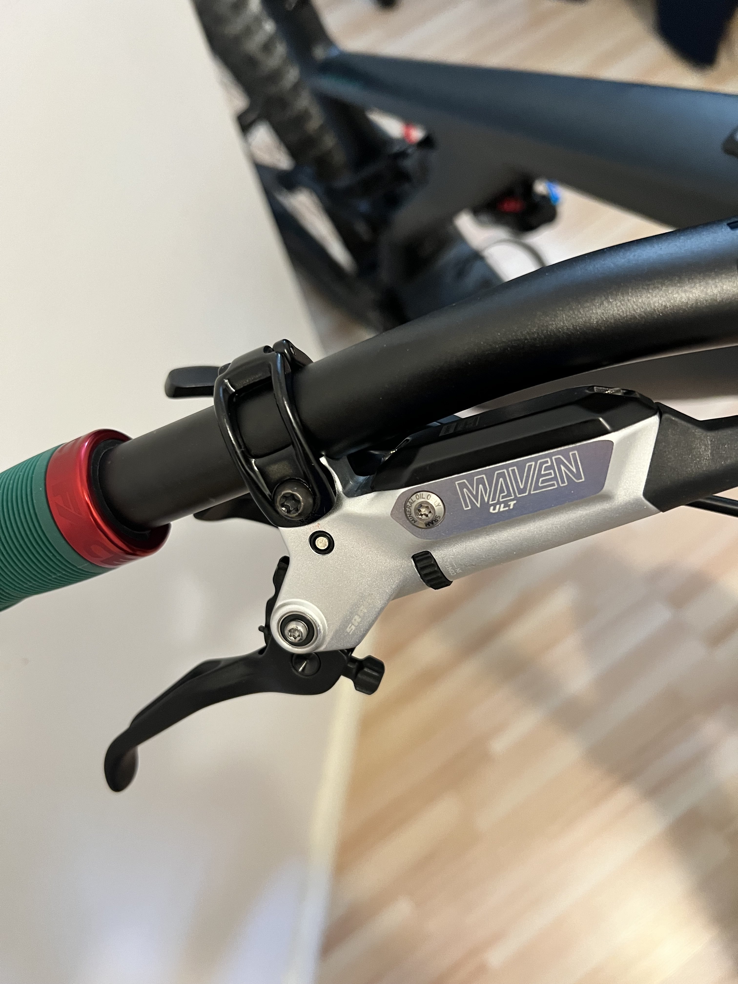

How is the lever pull on those, I tried a set and they felt kinda stiff. I also saw the a video by Dale Stone.
What’s your opinion?
Kenevo_Cal
Mar 4, 2024
15
20
Vancouver
it is a little harder at the initial stroke…but not crazy
i’m used to shimano brakes on my other mtb, so i don’t really know what sram lever pull should feel like
but they got big time power 😤

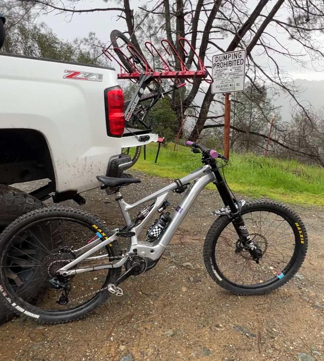

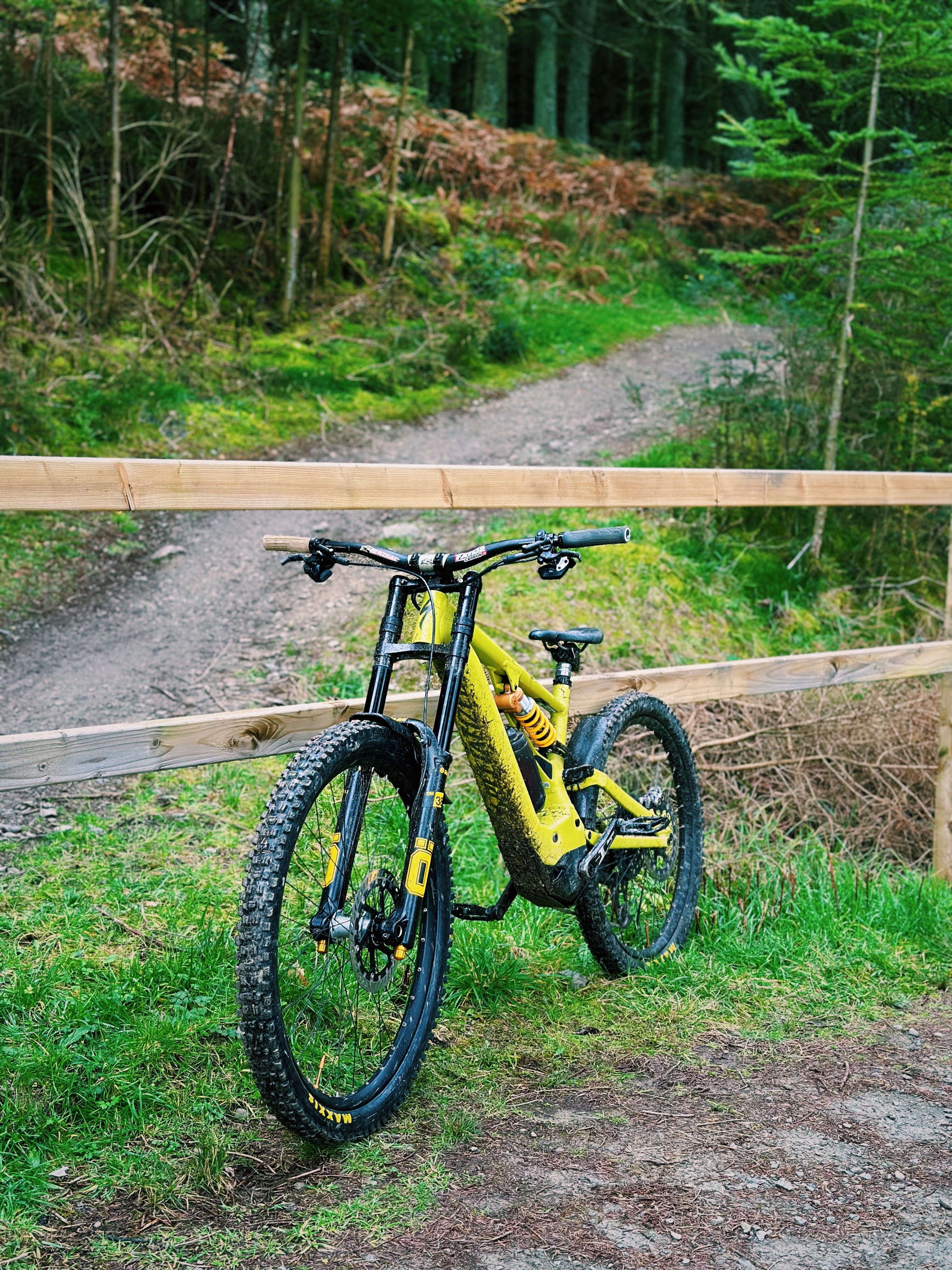

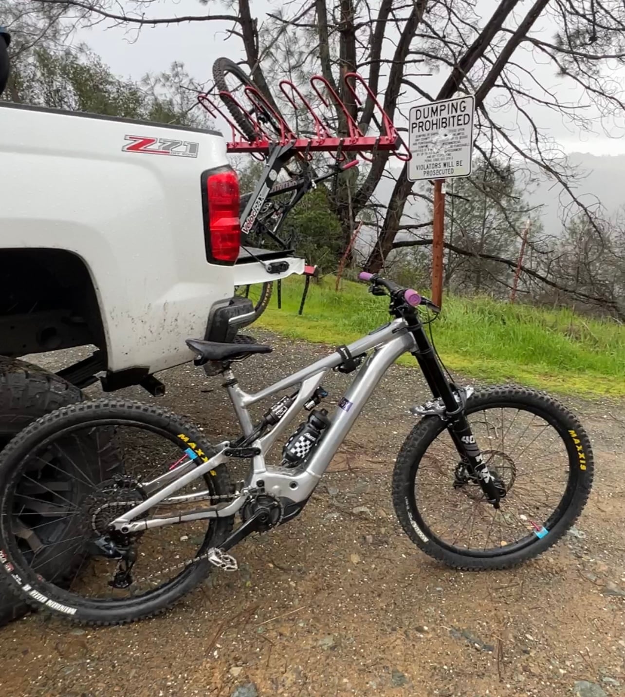

This is my offering so far..after going from a gen1 kenevo it’s very different. I might try a 29 rear wheel as it feels a bit wild like this. Anyone else tried ZEBs in their quest for the MX set up?

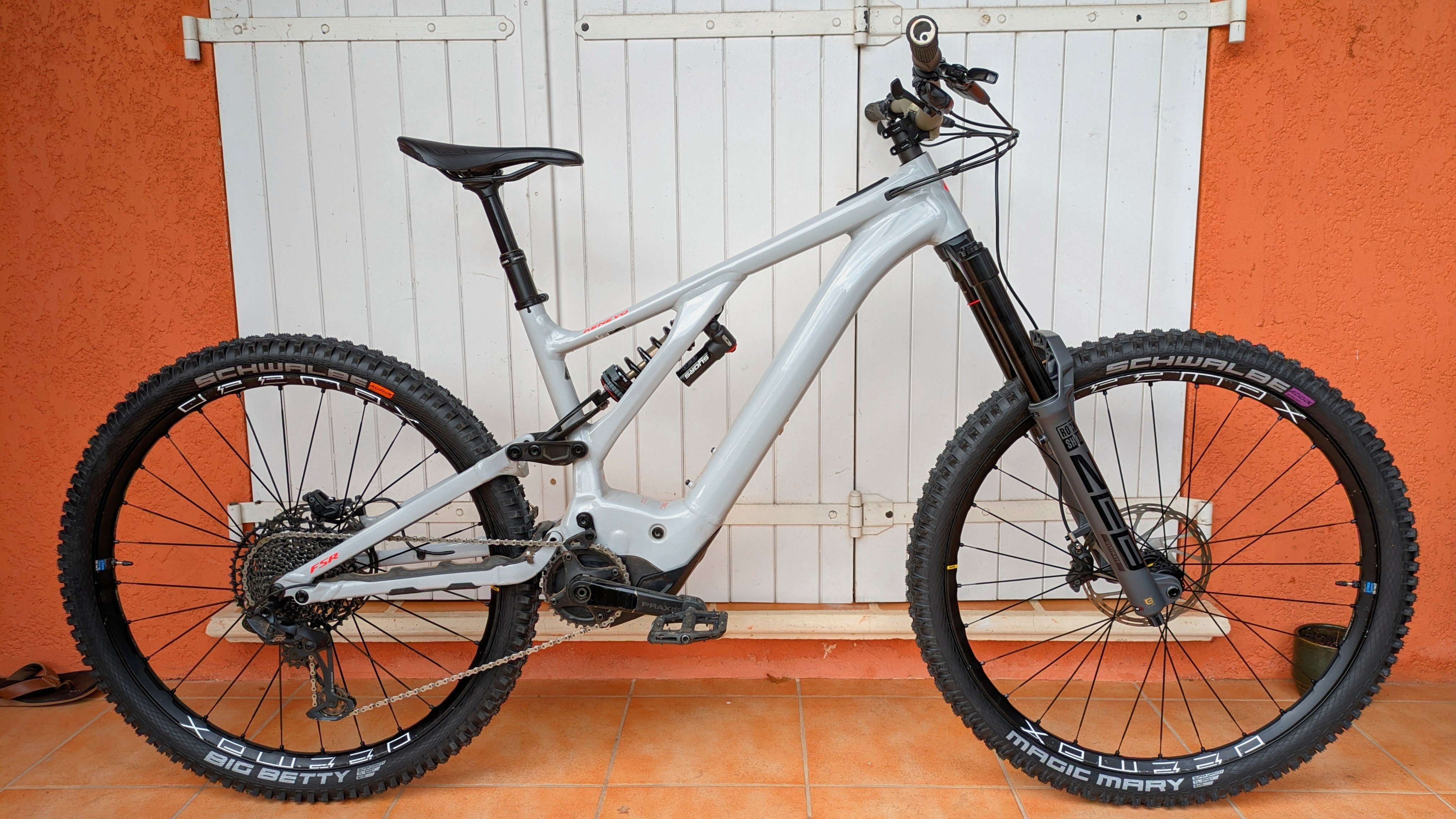

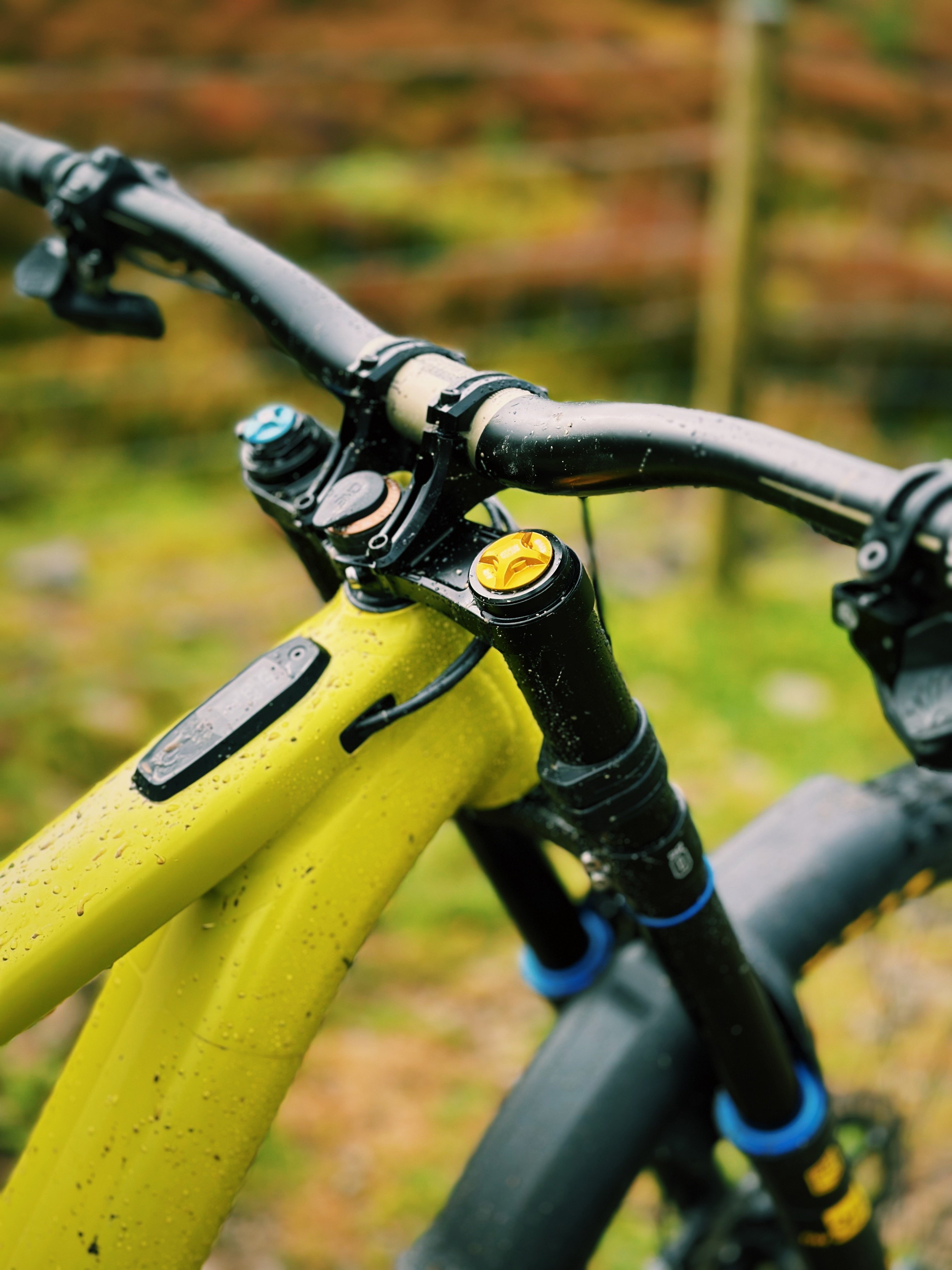

hello, after 2 years of good and loyal service, I finally upgraded my Kenevo to a full 29. A zeb 180 mm and 1 bos syors to glue all that to the ground. the bike rolls everything up, zero regrets... if perhaps not having done it sooner 😁

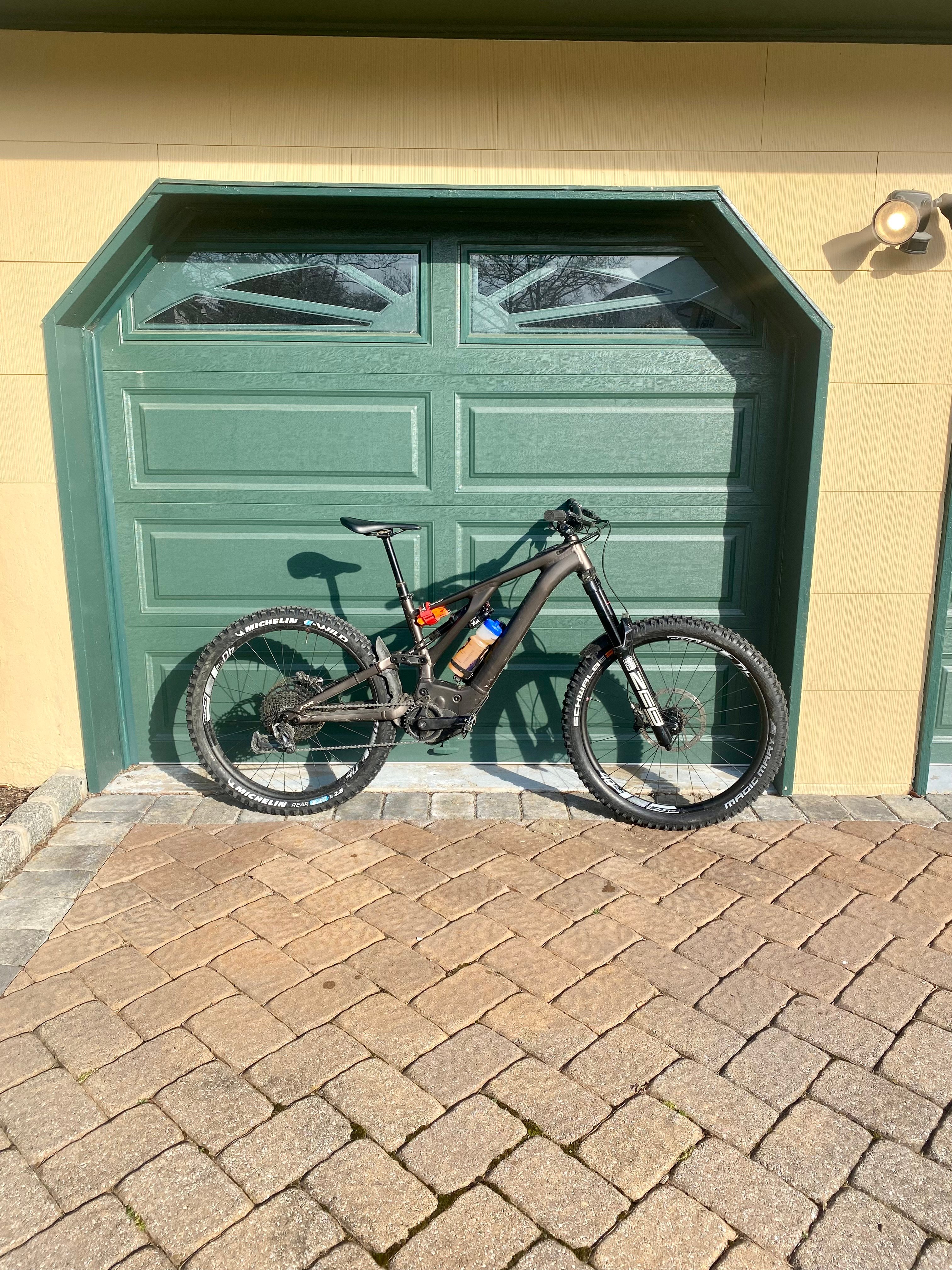

I still say the Kenevo works better as a 27.5 plus bike. Get some 40mm iw wheels and some 2.8 tires. All that skipping through rock fields on 2.3-2.5 tires aired up to 25psi or more goes away. 2.8 tire aired down to sub 20 psi allows the rubber to conform to the rocks much better. The new e tires with strong sidewalks don’t have tread squirm. No argument, the 29er’s roll faster but the 27.5s roll better imo.
