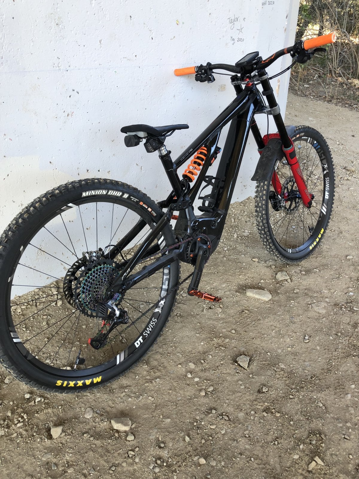

Hello Rob I have both front 29/rear 29 on my kenevo. I chose the 29 not for Geo numbers but for overall rideability :) The Bike sits alittle higher than stock and I like how I don't encounter pedal strikes when I ride chunky trails.

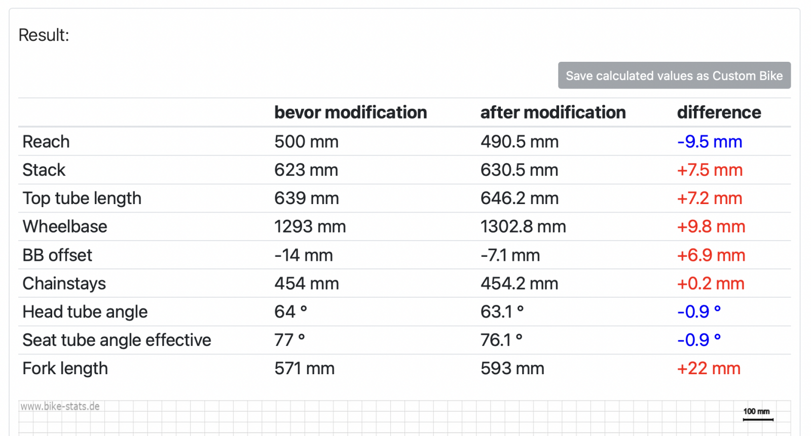

No need to wonder, takes few minutes to calculate exact geo with perfect graphic comparison :- ).
bike-stats - everything about bike geometry
Looks good, but doesnt take into account Axle to Crown differences between a Dual Crown and Single Crown fork. The Boxxer 27.5" 180 to 29" Fox is pretty different
EDIT - seems like theres an option to do this!

I tried my Kenevo with a 170mm Fox 38 w/29 wheel and 230x65 x2 shock. It went downhill great but even with rear in the high position the head angle was in the 62 degree range and the bike felt lazy when turning. I then swapped on a Fox 38 specific to a 27.5 wheel and changed the length of the x2 back to 62.5mm. In the high position with the bike back on 27.5 wheels the head angle is 64.3 degrees and the bike feels better than ever. I’m not necessarily a fan of 27.5 bikes but of my 4 ebikes I love riding the Kenevo, with its new setup, the best. The new set up also feels really good with a coil. If you want a super slack long travel 29er get yourself a Norco Range VLT. I have one of those too. It’s not as fun to ride as the Kenevo but it’s stable and rolls downhill well.
jooles
Jan 23, 2020
158
126
South Wales
6’2” and 78kg.
Kenevo S5. 2021 Fox x2 shock. 700wa battery in what was a comp version.
Have tested
27/27. with z1 180
29/27 With lyric 170
29/27 With Zeb 180
29/29 with Zeb 180 (Run flip chip high/low and fitted offset bushings to top of shock eyelet)
Running timed runs on local easier DH and hitting technical climbs the best feel was/is the following setup:
zeb 180 29 front
29 rear
Offset bushing
Flip chip low.
This gives me:
HA 63.5
BB 350
SA c. 78
No contact saddle/rear wheel
Running Eliminator 2.4 in rear with plenty clearance
The bike climbs like a goat. Runs anything DH…I bail first. Corner grip is superb.
It’s a 180/180 Levo Turbo now with option to chuck a 27 in back for even slacker/ lower however I find sweet spot for BB height with 180 travel to be 345-350 with sag around 25%.
Just love the covert flexibility of this bike. Plush, sensitive, poppy and 23.5kg with pedals and 700 battery.
I’ve run Spesh for decades now and can’t think of a better geometry, kinematic, feeling and all round bike than this one….and it has a motor.
Think I’ll setup a YouTube channel documenting my project ;-)…mind think Robs rather good at that…

So the offset bushing, are you running it in low AND also an offset bushing?
jooles
Jan 23, 2020
158
126
South Wales
Hi Rob,
Yes an offset bushing in the top eyelet and flip chip set low at the bottom (Yoke end).
This gives a pretty good overall geometry as above.
Static BB height a little higher maybe 350-352 however once you load it its fine. I find that with an eMTB if you want to both techincal/rocky climb and hit the downs a lower (sub 345) BB gets in the way a bit.
If you wish to just session a place like BPW there is the option to lower the BB by sticking the original 27.5 in back, running as a mullet with a 5mm lower BB and a degree or so slacker head angle.
With reference to 29 rear wheel, as above plenty of clearance. No contact with seat post when shock fully compressed (s5).
Hope this helps fella, well worthwhile experimenting with this bike as it unlocks huge flexibility for differing types of terrain, riders and environments.

Mines 23.5kg with pedals and mud ;-) 700wh battery, is yours the same battery?
You'll love it ...I'm on Zeb Select and they suit the bike a treat.
Have you offset the top shock bushing yet. This does make it feel a little more planted in corners as lower.
Give a run down on how it feels and we can compare notes.
Looking ace.
