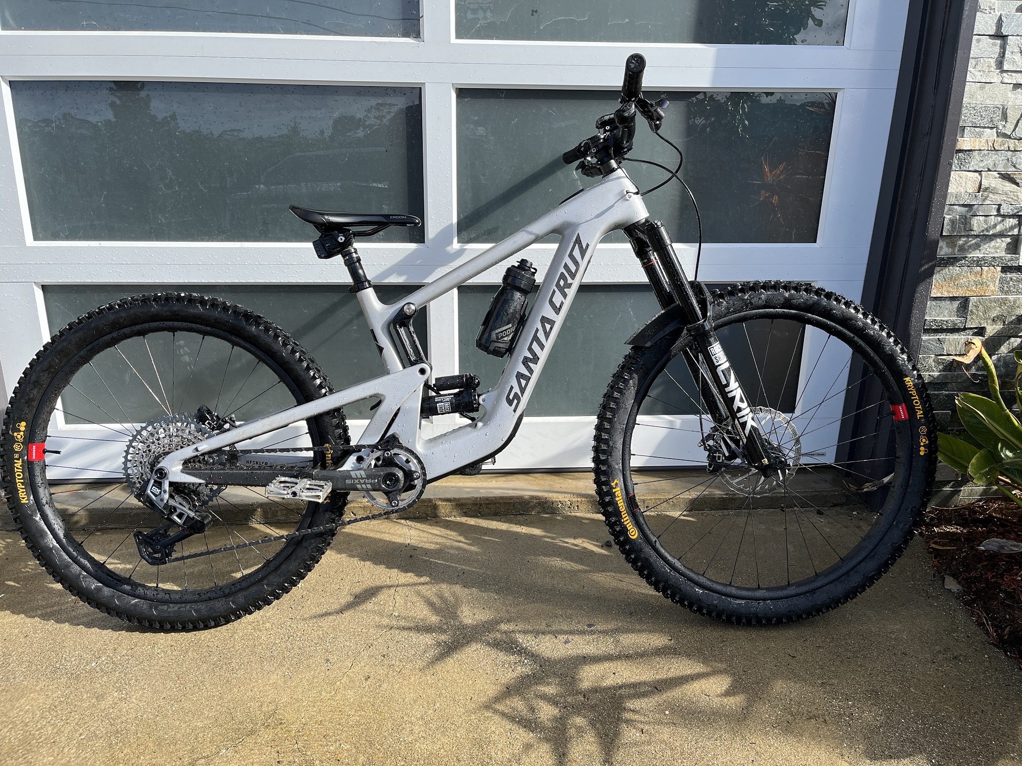

Well, my buddy won't stop raving about his HSL, so I ordered one for myself. Getting an S build and basically flipping most of the components over to my Levo to sell that or just use it for trail work.
Andeh
May 30, 2023
37
24
Half Moon Bay, CA
I got my HSL built up, at least mostly, and got 1 ride in before the rain returned. My buddy who delivered it was also on his, and we did about 4,150 ft in 2:15 moving time. We ran Breeze on low angle fire roads, River most of the time, and Rocket on the steeper punchy bits. We each had about 15% charge left.
My first impressions are that the bike is great. The assist level is just right for me, it speeds up climbs considerably but still feels like normal pedaling (just without the suffer). The bike descends a lot more like a normal bike than my 52+ lb Levo did. Right now it's sitting at over 45 lbs, but that includes pedals, DH tires, and Reserve 30 HD AL wheels (I'm still waiting on my 30 Carbons, and will run Enduro casing tires on those). The motor is pretty quiet, but it does have more of a high pitched whine than the Brose/Specialized did. It also was dead silent descending - no rattles or clunks, unlike EP8s that I've ridden with. I didn't have any issues with the ring controller, but I think I'd probably prefer a 2-button controller like Brose. Also, it's weird that in order to engage walk assist, you have to toggle down to the motor off mode first.

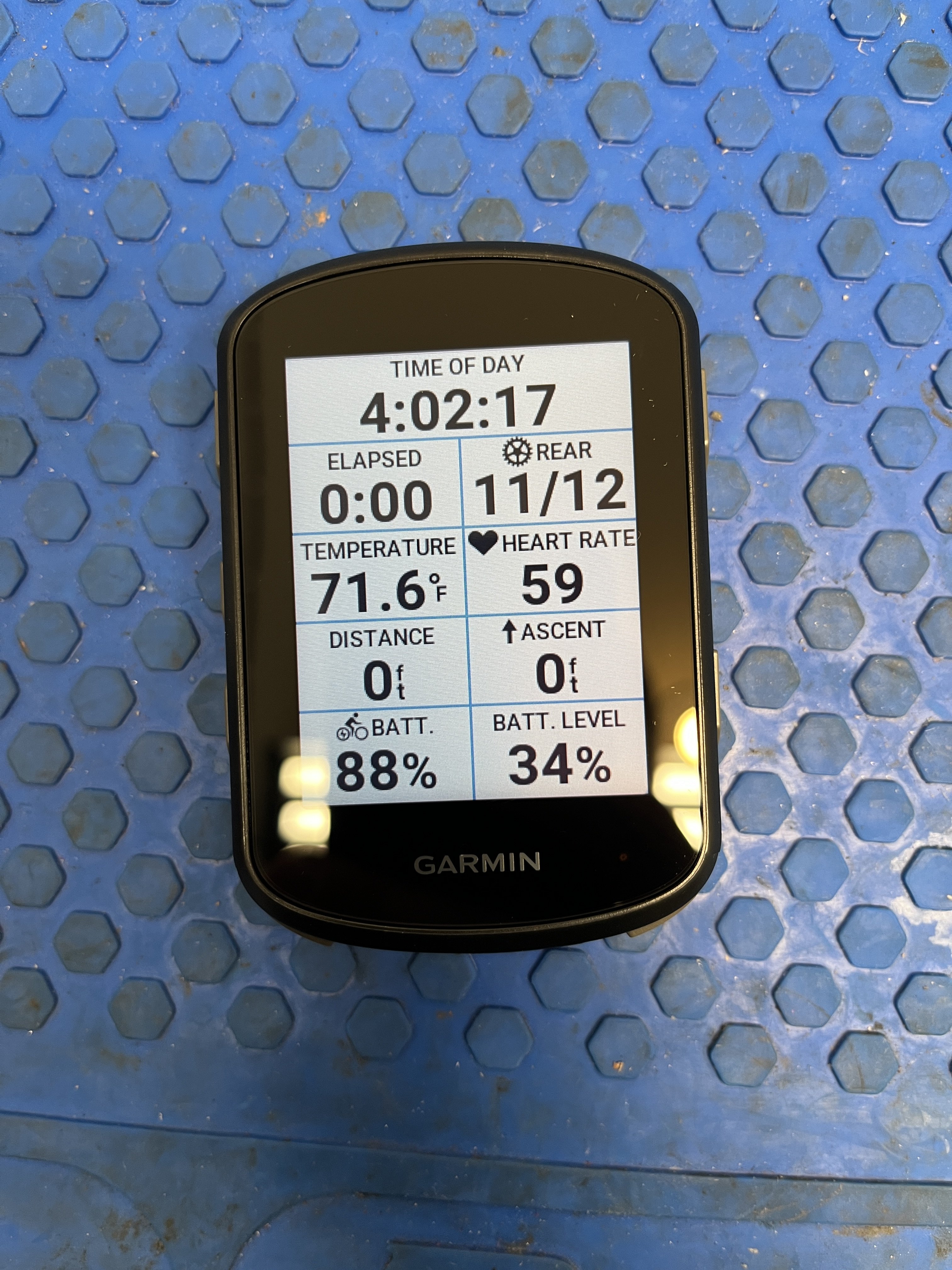

Apparently you can only see battery percentage with the phone app, or with a Garmin device and using the Fazua app on that, which is not configurable and shows a bunch of useless information. Also, while out riding, my phone could not connect to the motor to check the battery percentage, apparently because it was paired with the Wahoo. Fazua has a long way to go in terms of software / UI.
Dig into this assumption a little more. I do use a Garmin, but I don't use a "Fazua app" on it. I've got my battery % and pedal power on a custom data screen.
The guy I rode with just described it as that, and showed me on his Garmin watch and 530. He said you install a widget or something, which gives you 2 different preconfigured Fazua screens. I forget the exact different fields, but it was like battery percentage, mode, and some stuff I don't care about like moving speed. One screen was more minimal than the other.
With other ANT+ devices (AXS derailleurs, heart rate monitors, Specialized Levo, etc.), they provide numerical data to the head unit that you can set up in custom screens to your preference on Garmin and Wahoo. The info I care about is: current time, ride duration, ride distance, elevation gained, ebike battery %, AXS gear #. I have 1 screen that shows all of that. Then my Wahoo also uses some colored LEDs across the top to show heart rate zone.
I do what you do with my R60 and Edge 530, a custom screen with basically that same data you listed.
I’d be interested to know how this is done, the Fazua app is ok on my garmin 1040 but it would be nice to use a custom screen with my own selection of fields and at least be able to display the battery percentage.

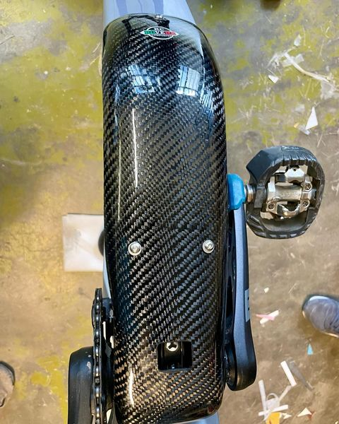

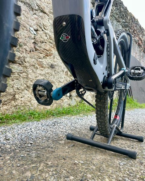

guapo73
Dec 30, 2022
Italy
in case you are interested Rovere Compositi | Savona from Italy
What have you tried? All I remember doing was powering the bike on and pairing its sensors to the computer, then building the custom data screen as I would for anything.

I ordered a Garmin 540 since my Wahoo has been kinda flakey lately anyways. I'll try setting it up on there and try to put together a how-to if I'm successful.
I did press my buddy also on a HSL more about how he set his up (he's not super tech savvy), and he did say that on his Garmin watch he used this: Connect IQ Store | Free Watch Faces and Apps | Garmin
It let him show both battery percentage and mode on a single screen on his watch. I will try using the standard Garmin custom fields first, then try that if it doesn't work.
you can add this fazua widget to your ebike garmin profile where u can find also other additional fields

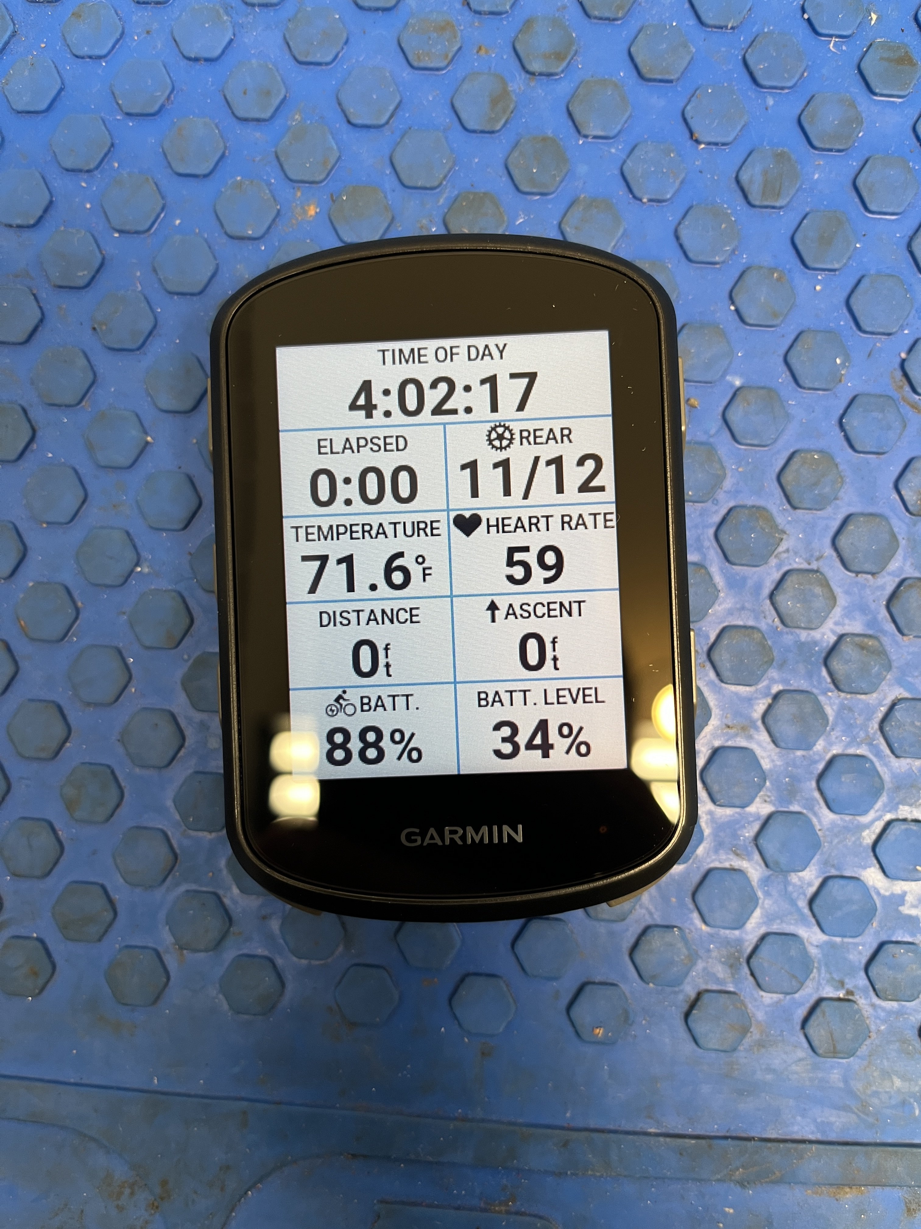

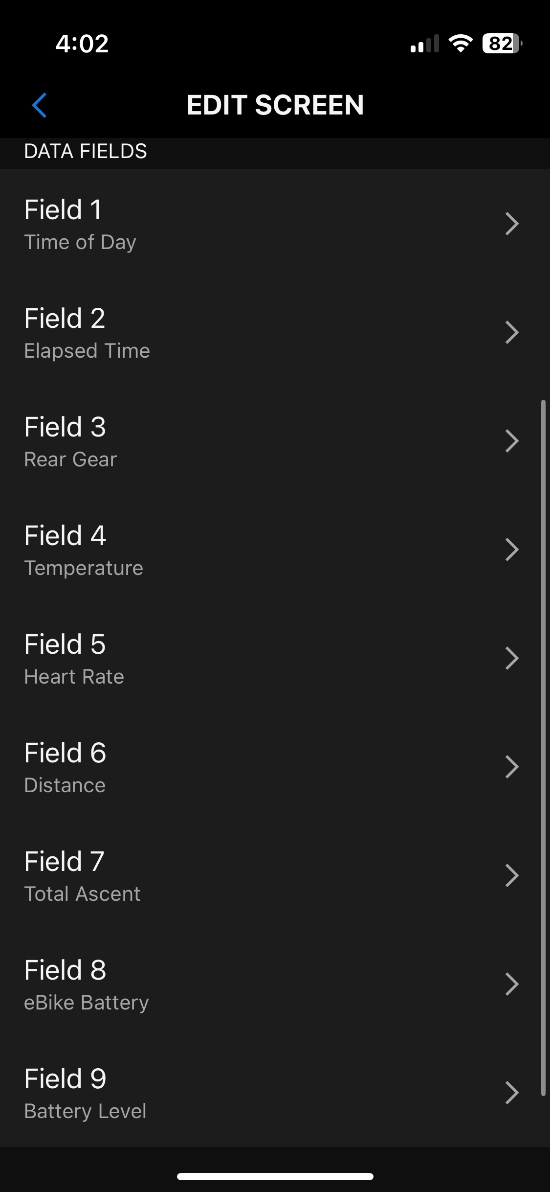

Yeah, so as others have said here, Fazua "just works" with Garmin. No idea why Wahoo can't but whatever. I just searched for nearby devices on my new 540 and it saw "ebike" even with the HSL turned off. (Guessing that's also why the ebike battery has drained to 88% over the last week without being ridden.) I really like how you can do all the Garmin configuration on your phone now (that was one of the major draws for Wahoo for me).
Here's the screen I was able to create with stock fields:
Thanks for this, I’ve sorted it on my garmin 1040.
select menu>sensors>add sensor
your ebike and gear sensors should show up. Just tick the boxes to add them and they are selectable for the custom screens.

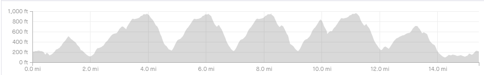

I got a few more rides in on my new HSL after the rain let up, and I'll just say that this is a damn fun bike. It's much better handling than my Levo was, and way easier to bunny hop and pop off smaller features. Like others have said, it uses it's travel exceptionally well. The only time I felt hard bottom on the shock was a huck to flat.
The range is totally fine for my use cases. On Saturday I rode with a mixed group of ebikes and regular bikes, running only in Breeze with the exception of 1 steep techy climb where I used Rocket + tried the boost function, and we did just under 3,000' of vert in 1:45 of moving time, ending up with 52% charge left. Then on Sunday I rode solo on my local trails and did 4,700' in mostly River, but using Rocket on all the steeper parts, in 1:40 of moving time, and had 2% battery left.
The vert you're getting is quite good. Is this on the winch and plummet style trails you mentioned? Mind sharing your weight (and FTP estimate if you know it) for others to reference?
Glad you're enjoying the bike! I still have barely ridden any of my former bikes since getting the HSL.
Yeah, winch & plummet (although I didn't ride a couple of our steeper trails because they were still wet). I currently weigh about 163, 5'8". I've never done a proper FTP test, but using the internet calculators by age & weight, they say 300w.
