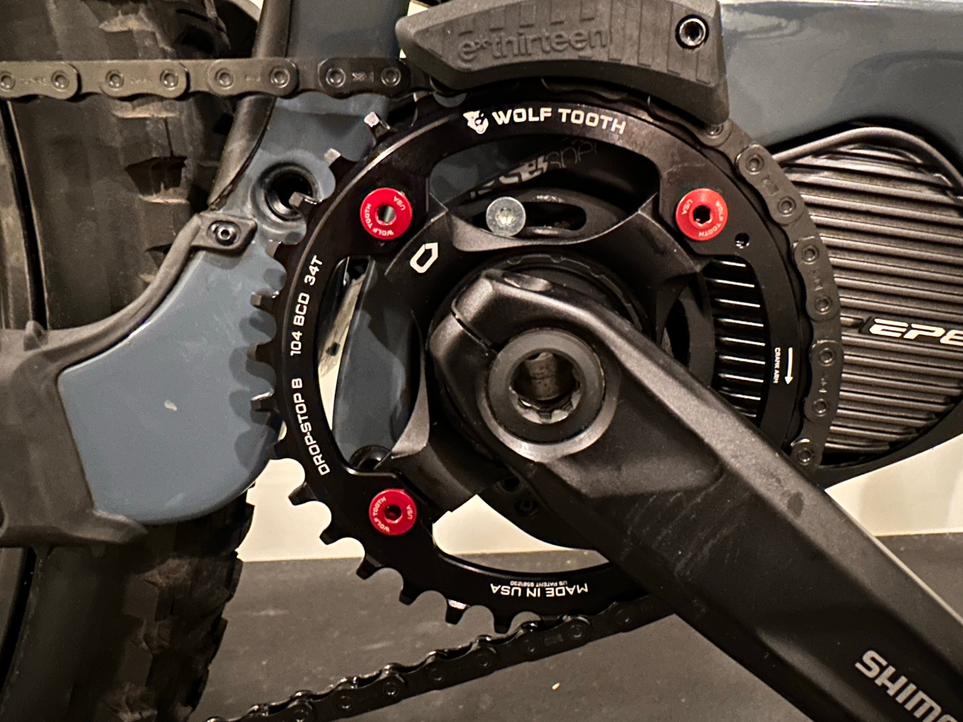

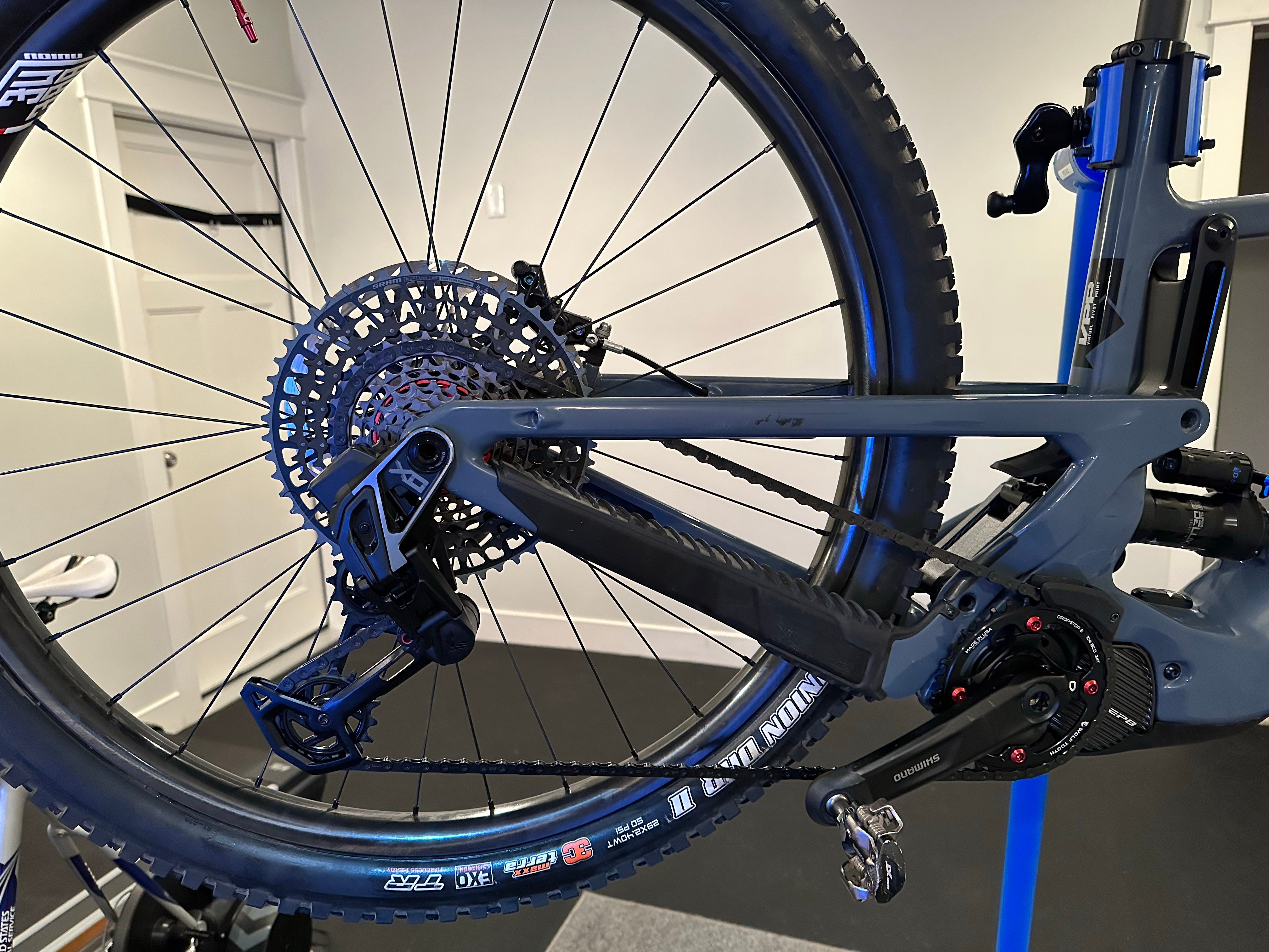

Can you list what other parts besides the mech and chain you had to buy to install this on your Heckler?
The only non-SRAM part I’m using is a Wolftooth chainring, the Drop-Stop B 104 BCD 34T, which is made to be compatible with the new SRAM Transmission.
I also replaced the OEM chainring bolts with Wolftooth ones. The OEM bolts are the old Shimano style that needs a special chainring bolt tool to remove the bolts, and which are not good because they strip easily. The Wolftooth bolts use two hex keys which is a much better design.
Everything else is the new SRAM: derailleur, cassette, chain and shifter pod. My LBS sold me one of their XO upgrade kits minus the cranks/BB.

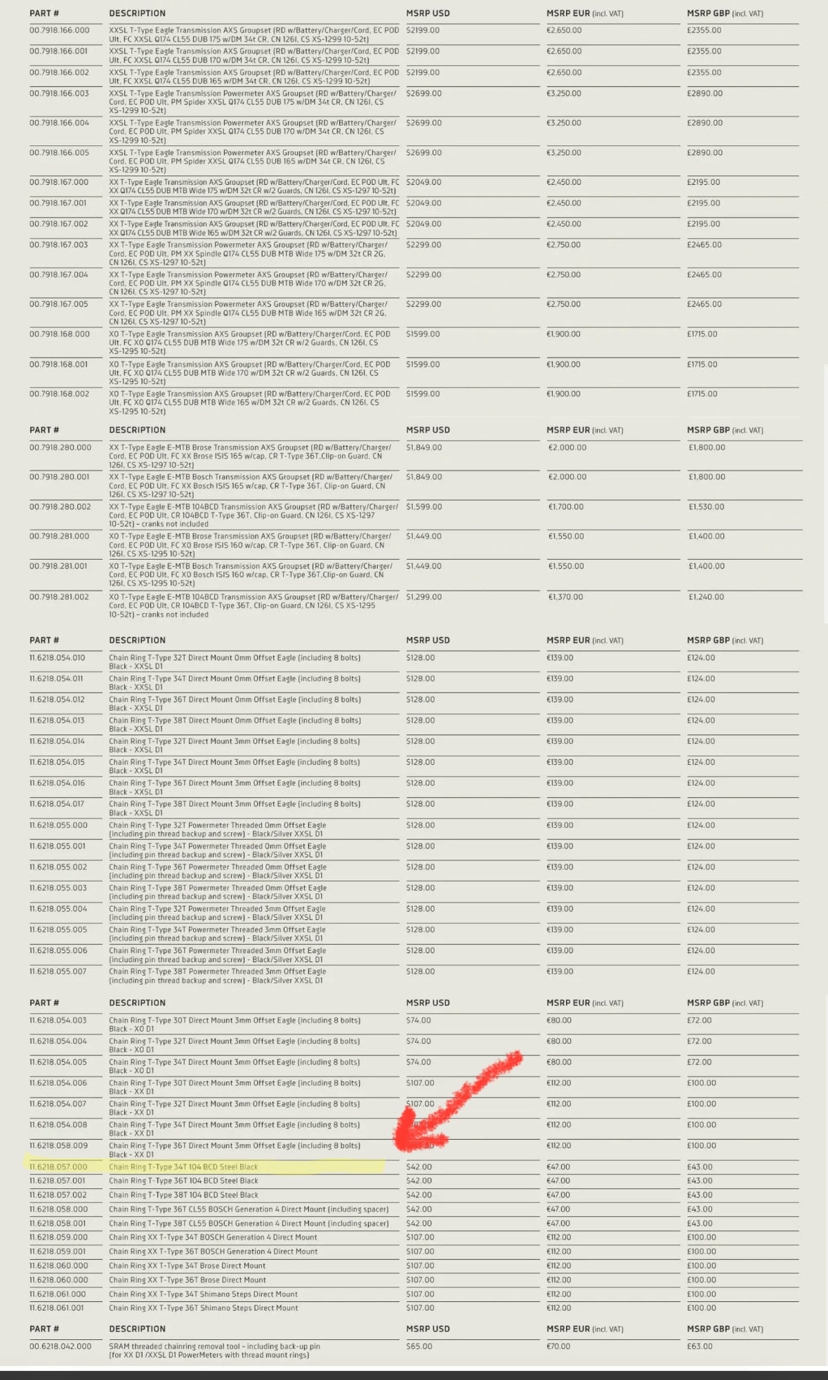

If you don’t want the Wolftooth chainring, SRAM has a T-Type chainring with 104 BCD in their catalog, but my LBS didn’t know when they could get one so I decided to go with the Wolftooth because it’s available now.
Great info! Thanks!

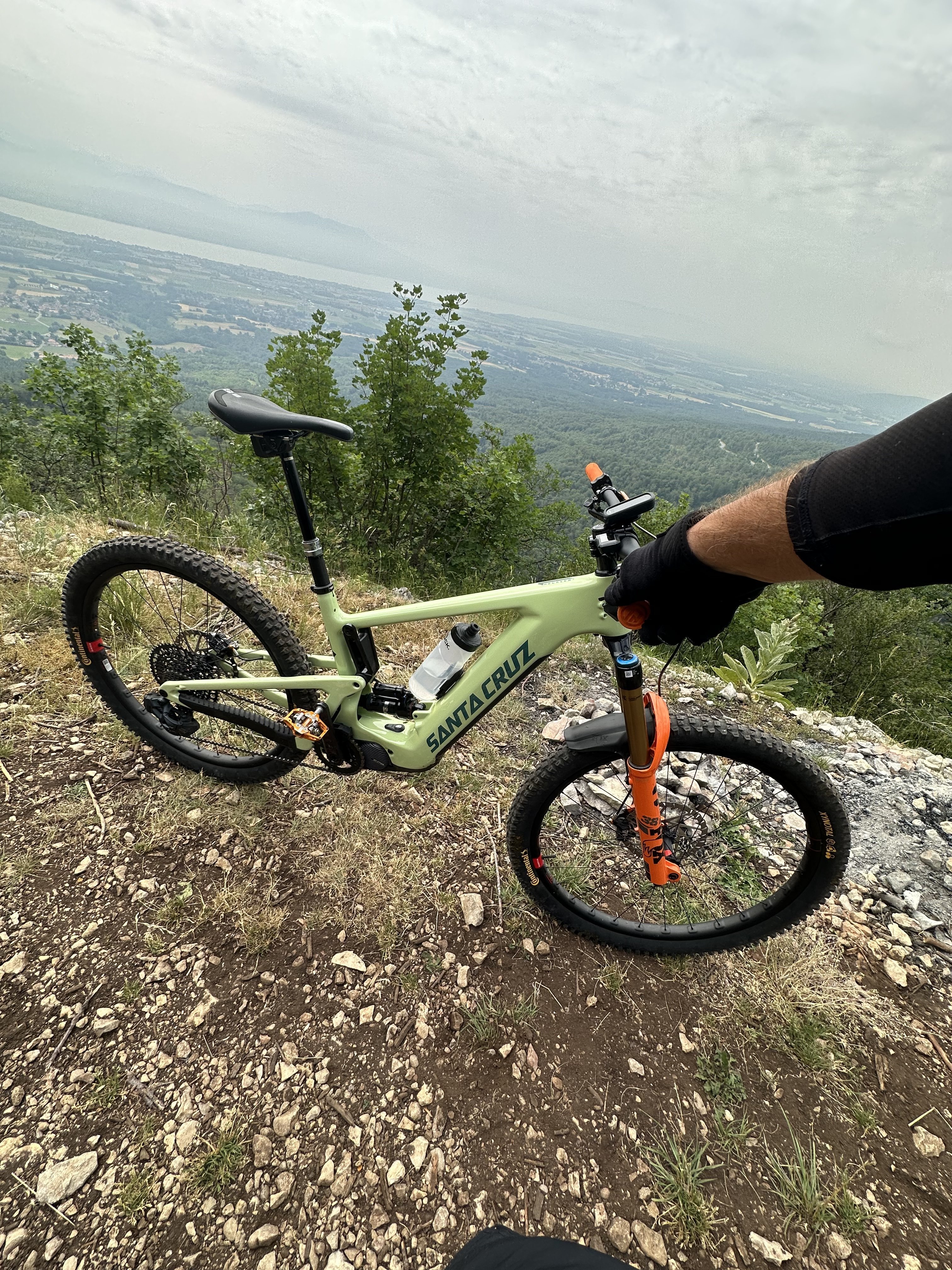

Greetings all,
I would like to get the new 29" Heckler and I have seen two this morning, the dark grey and avocado.
I wanted to take the available grey but seems that I have fall in love with the avocado one !
Is is "hard to clean" the mud on that "shiny" color ?
Beside that, my dealer told me that all available bikes come with EP800 and not E801.
Does it make a real difference ?
I do not see the new Heckler model (with Zeeb) on the official website, at least on the French one.
That being said, is it possible to get a new Heckler with 801, and yes which reference or production year / month should I look for ?
Finall, is it possible to add a Fast Suspesion Fenix Enduro ? Seems the tunnel is large enough !
Thanks !

Yes; I should get it in about the two or next weeks.
I've choose to take a R in order to have an update budget.
Magura MT7 Pro will be placed on it and I'm thinking upfront about the front and rear shock.
Is it a good things to put a coil; like a Fast Suspension Fenix Pro, or a simple Ohlins TTX2, in order to improve the performance or will it "destroy" the cinematic ?
About the fork, any pro to move from a Lyric Select to a Fox 36 Factory or even an Ohlins 36 ?
I'm 78kg, riding more "mountain bike" than truelly enduro; with rocks; drops and some small jumps (around 50cm).
