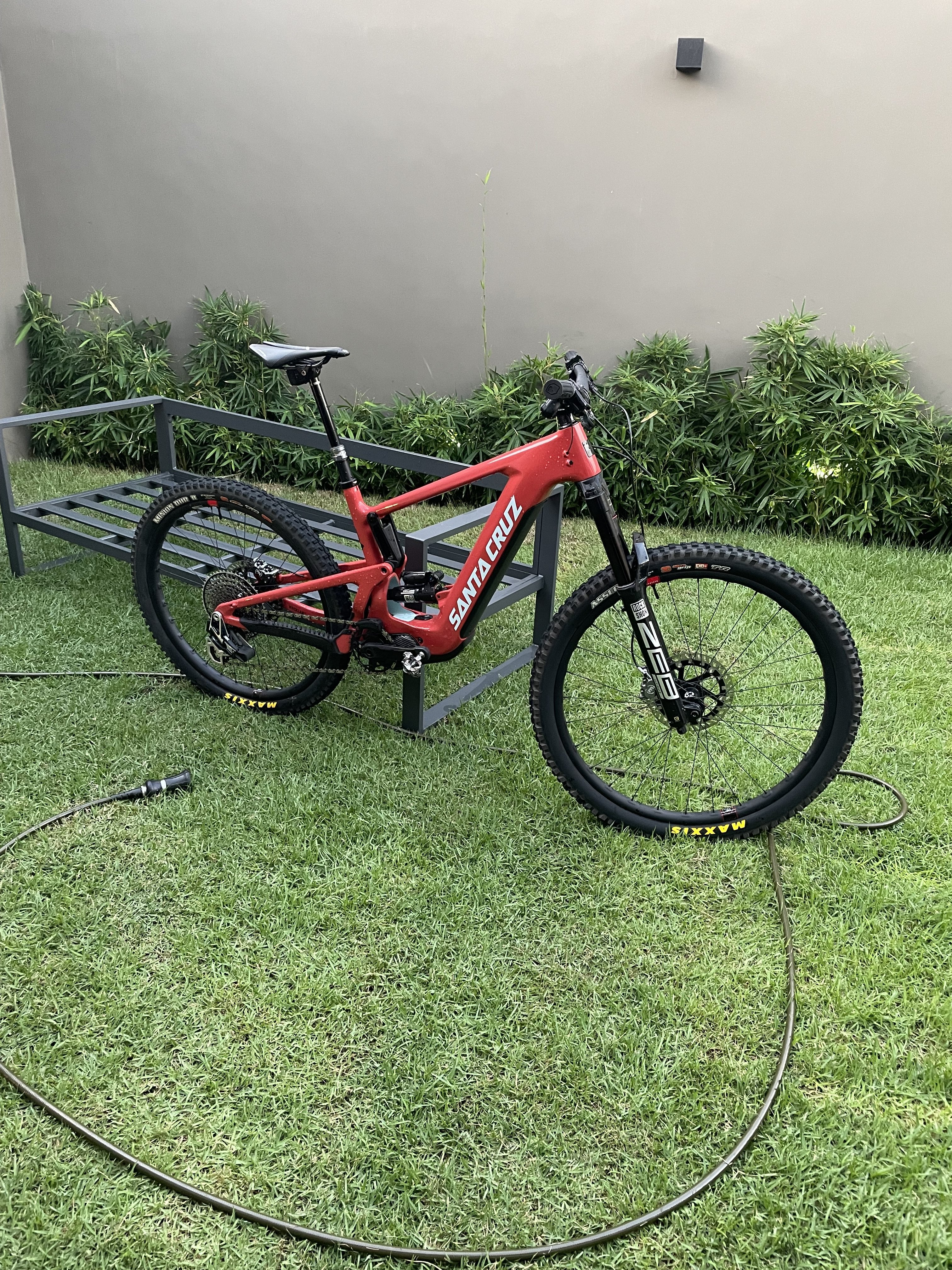

I see a high pressure type nozzle on that hose. I would suggest that you not use high pressure. The water will invade the bearings and destroy them. When I first started riding, it was hard to resist hitting the bike with high pressure water to clean my bike. I'm over this now after seeing the results on a few bearings I replaced. I now just use a light sprays and a very soft brush with long bristles. I do notice grease with a dirt coating at the pivot points on my Heckler, but I resist the urge to blast it off with high pressure water. I actually leave it there and figure it makes a good barrier to keep out water and dirt. If it really starts to bug me, I take the rear wheel off and use a rag to lace it through the areas at the pivot points in order to wipe as much grease/dirt away.
