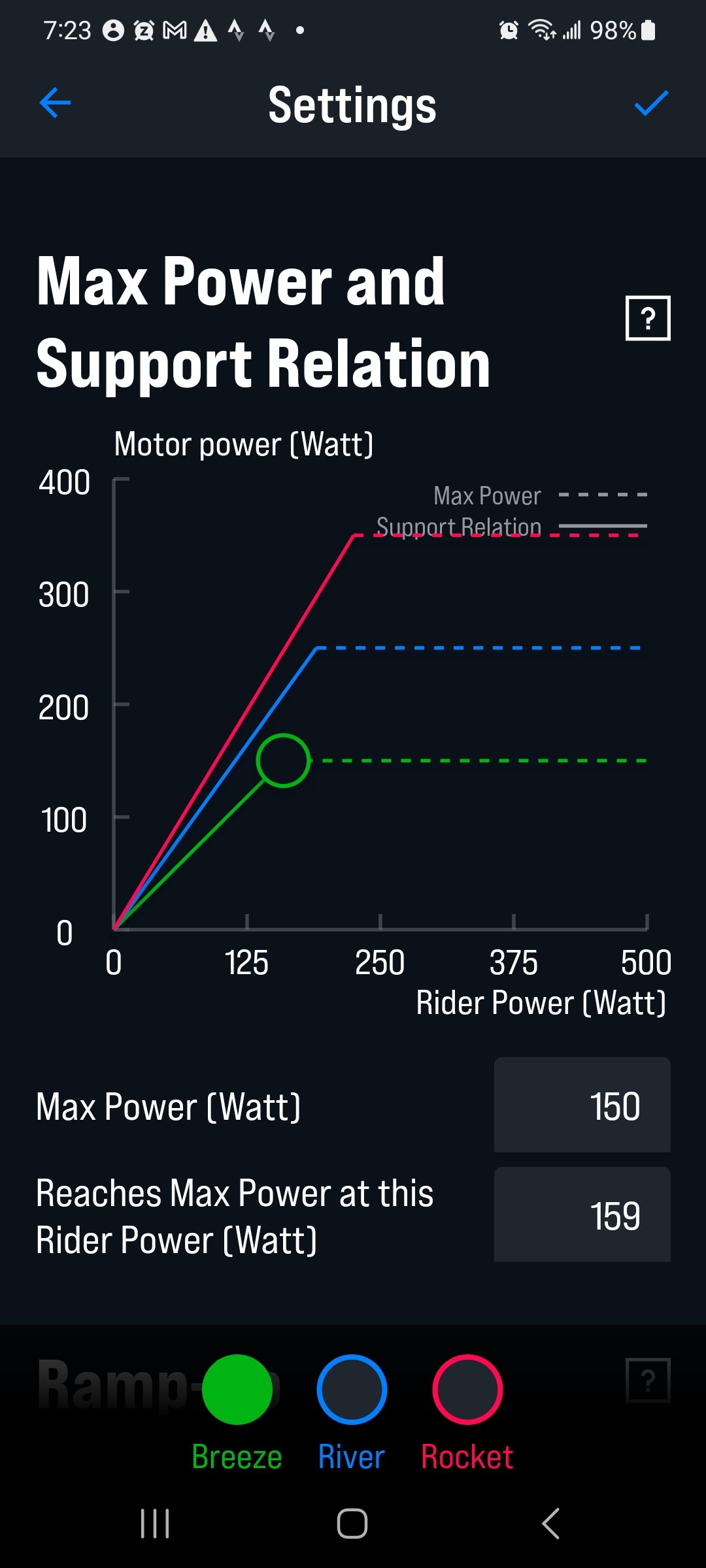

Today I rode 19 miles with 3400 feet elevation. 8 miles in river and 11 miles in breeze. I weigh 200 lbs. Had 8% battery left. Longest ride with the bike to date was 23 miles 2900 feet elevation with 11% battery left. Mostly riding in breeze. For me 20 miles and 4000 feet would be close to max range at my current breeze setting (150 watt max power). Hope that gives you some idea of range.

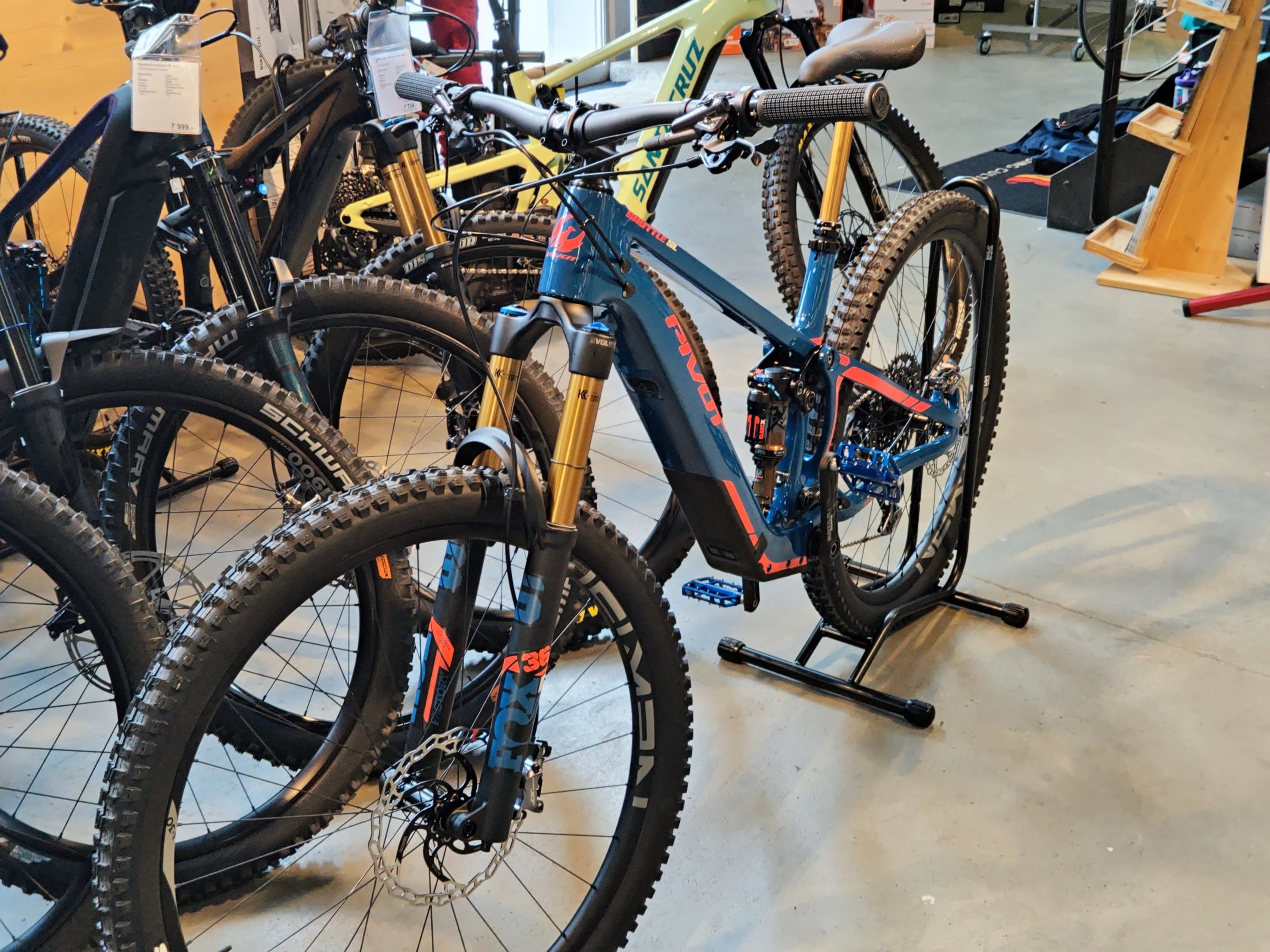

After riding a FF Kenevo, Kenevo SL, Bullit, Scor 4060 Z over the last years I was excited to see the Fuel EXe and the Shuttle SL. I love the idea of a lightweight EMTB, but the KSL lacked some power for my riding here in central Switzerland, right at the foot of the Alps. DH it's the best of the emtbs I've ridden. The Scor was the best of the FF, as it was the most nimble and playful of those.
Today I've tested the Pivot Shuttle SL Pro and bought it right away. It's pretty expensive though.. I could have gotten a Fuel EXe 9.7 for 6k! The XT in Mulsanne for 8.9k. The yellow one for 8.7k. Some shops have pretty decent sales right now. But I went all in for the Shuttle SL Pro, as it felt perfect right away. Size L for me at 1.78m/5ft10 feels perfect. At ~18.2kg and with that amount of power it might well be the perfect do-it-all bike.
So excited to go out on the trails the next couple of days. 🎉😎
Nice! I acquired a Shuttle SL to add to my KSL. The Shuttle SL has been perfect compliment to the KSL for the trails here in Northern California.

I did one of my "benchmark" rides today. Basically, if the battery can survive this loop, I'm in a good place. You can see the route here:
It's actually more like 24.8 miles (39.9km), 3,419 ft elevation (1042m). Ride took 2:22. For comparison I can do this ride in ~1:55 on my "full fat" Crafty w/ 625 battery. I have not been brave enough to do the whole ride in Turbo on my Crafty, but I can manage about 50/50 Turbo/EMTB.
On the Shuttle I had to do a heavy mix of River, Breeze, Rocket, and off. Battery died about 1.4 miles from the end. I was hoping for a *bit* more range. I did the same ride on an Orbea Rise M-LTD and managed to stretch that tiny 365wh battery til the end. I did it in 2:18 so it wasn't like there was a huge speed difference. This would definitely be a range extender ride for the Shuttle...if the range extender actually existed (not in 2023 according to Fazua :mad:).
