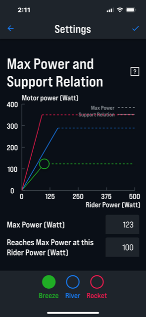

In addition to struggling with the Garmin connectivity, I'm not real clear on the method of changing riding profiles. I've figured out that if I select the profile I want, then go to ADVANCED SETTINGS I can change that profile, but I'm not sure how to select it for that ride. If I use the defaul profile there is no check in the upper right hand corner but if I am in the custom one I created there is. I can click the check mark which then disappears. I'm assuming that this selects it. But there is no way to do this with the default profile.

So I've been experimenting with power settings. Last night I had everything pretty much maxed and rode 7.66 miles and had 59% of my battery left. I did 739 feet of climbing. Today I pulled turbo down to 300 and adjusted the others accordingly and rode 12 miles, climbed 870 feet and had 52% left. Next time I'm going to adjust the levels to what my Levo SL was, and I expect to see even better results.The good news is that today's ride showed me that even with fairly aggressive power application I can get 24 miles and 1500 feet of climbing on a full battery. My SL maxxed at around 23 miles. I suspect that maxxing my power at 250 will get me close to thirty miles range.
