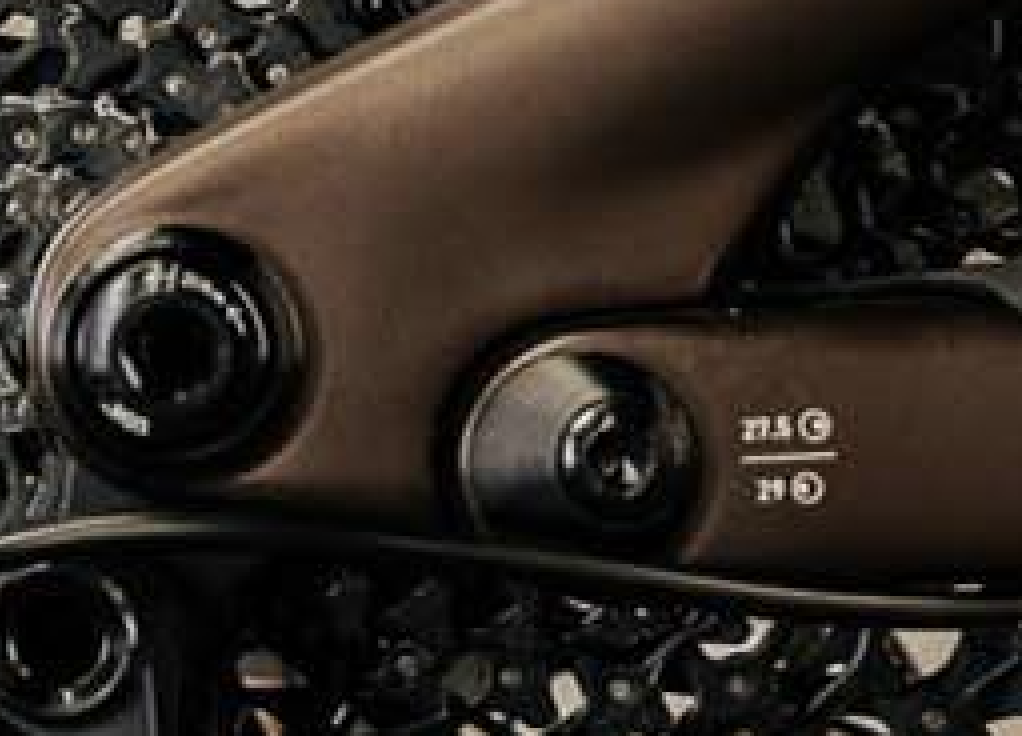

I ride gnarly trails on my 2023 Levo SL and DEFINITELY prefer it in 29".
I have a 29" Maxxis Dissector 2.4 in the rear and leave the flip chip in the 27.5 position. Plenty of tire clearance without lengthening the chainstay. I find this setup to be the best and I tested both wheel sizes thoroughly.
IMHO Specialized should have shipped it without the chainstay flipchip, as a 29" all around and in the slack headset position but fixed.

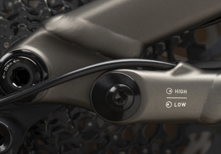

After two months of intense enduro with mullet on a PRO S4, in High, Long and -1°, I have no intention of trying the 29 rear wheel. The SL2 is simply perfect. Agile and very composed. I have Enduro 2020 at home in full 29 and also the KSL Expert full 29. On the Levo Gen3 I tried 29 back and returned to the mullet with long chainstays, more agile and reactive.

No with the flip chip in High.
It is better to place the handlebars a little low and the saddle slightly forward so that the front wheel does not lift on very radical climbs.
The overall balance of the bike is fantastic!
