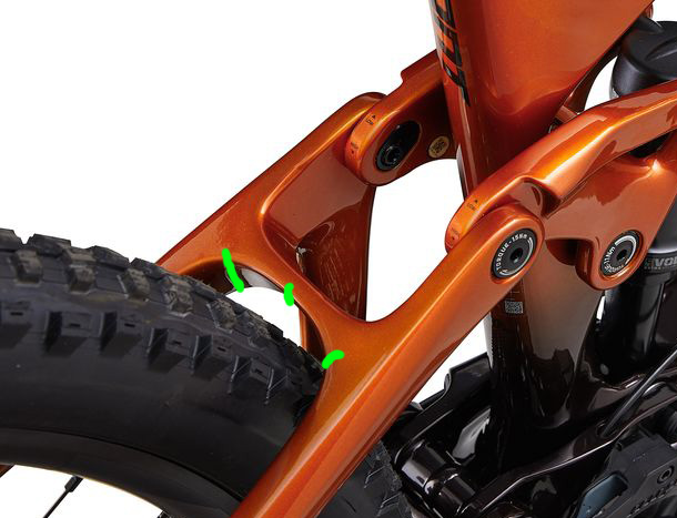

I bought a Trance X Elite 2 about three months ago and had to return it to the dealer already with a broken chain stay.
Has anyone else had this problem? I’m not sure if I can trust this bike any longer. Don’t feel like having a nasty accident due to bad frame build quality.
I also noticed some play in the lower shock mount but according to the dealer this was not the problem and is common with Giant bikes.
bglidin

I didn't take any pictures and the bike is with the dealership atm. But I draw into a pic I found online where the cracks occurred. I only noticed these cracks when I cleaned the bike. But on my last ride I noticed that the rear wheel was starting to feel unstable. Similar to when the spokes come lose. So I assume it happend towards the end of the ride doing just average level tech trails, not even jumps.
