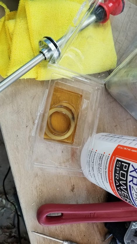

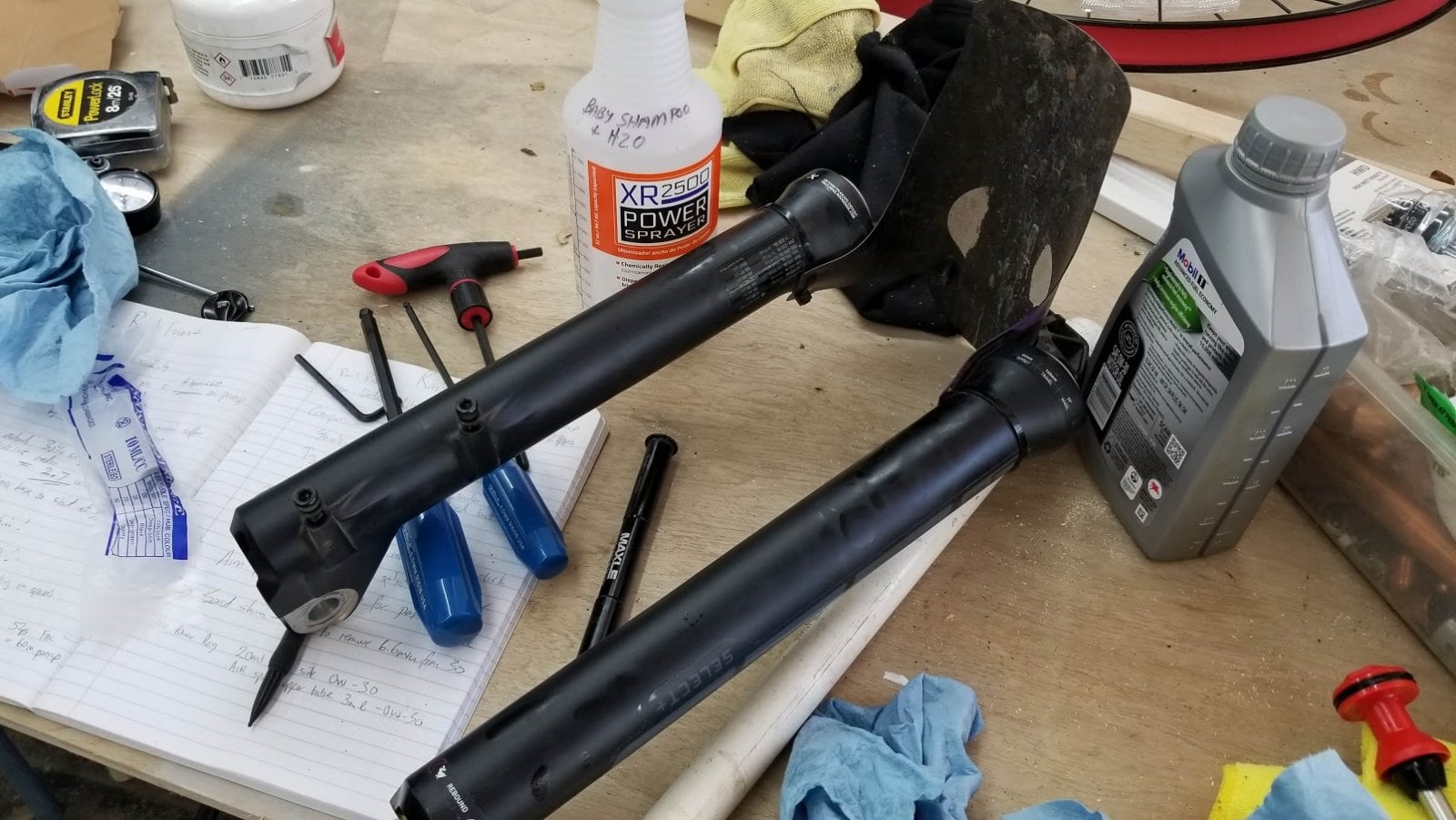

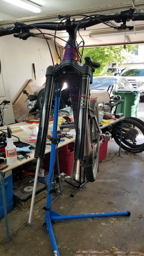

I did the lower and upper service today. The upper seals were bone dry. In the lower there was some oil in the damper side. Barely any oil in the lower air spring side.
I gave everything a good clean with IPA then greased it all lightly. Following the manual I added 20ml 0W-30 to each lower, soaked the seals and added 3ml 0W-30 to the air spring upper.
It feels a lot better just bouncing on it in the garage. The stiction issue is definitely fixed. Now I'm getting 30% sag at 66psi. Will ride 100 miles or so this week and tweak. It has to be better than it was before.
