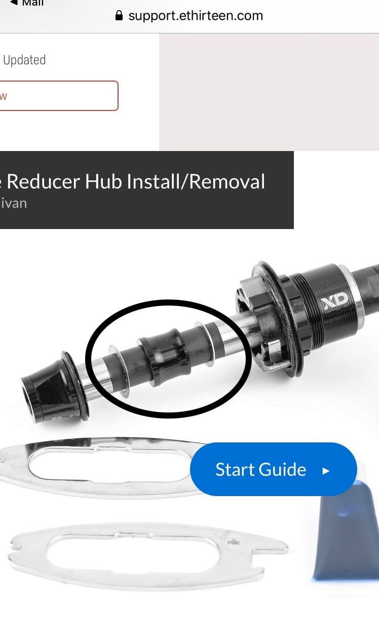

The noise you have is exactly the same as I had, I removed the wheel, took the higher 10 gears of cassette off, took off the freewheel off to remove the outer axle, where there is a spacer with a washer in each side(The washers are different thicknesses apparently, so put them back in the same places) I added a photo of them below.
A small amount of grease in the mating surfaces of these, Popped it all back together, added a smear of grease around the thru-axle and the noise has disappeared.

@Stewface is it hard for a newbie to get into that hub?
Im kinda new to ebikes and hubs etc. But i also have this sound. And its annoying. Took 5 rides and the sound came..
I must remove the cogs?
Thanks!
Thanks!
It’s not hard but not easy......
I followed a link on the e13 website. I’ll try and find the link for you, but I’m just a bit busy at the mo.
Thanks! I will wait, or see if i can find that one myself. That sound is killing all the fun in a yt ;)

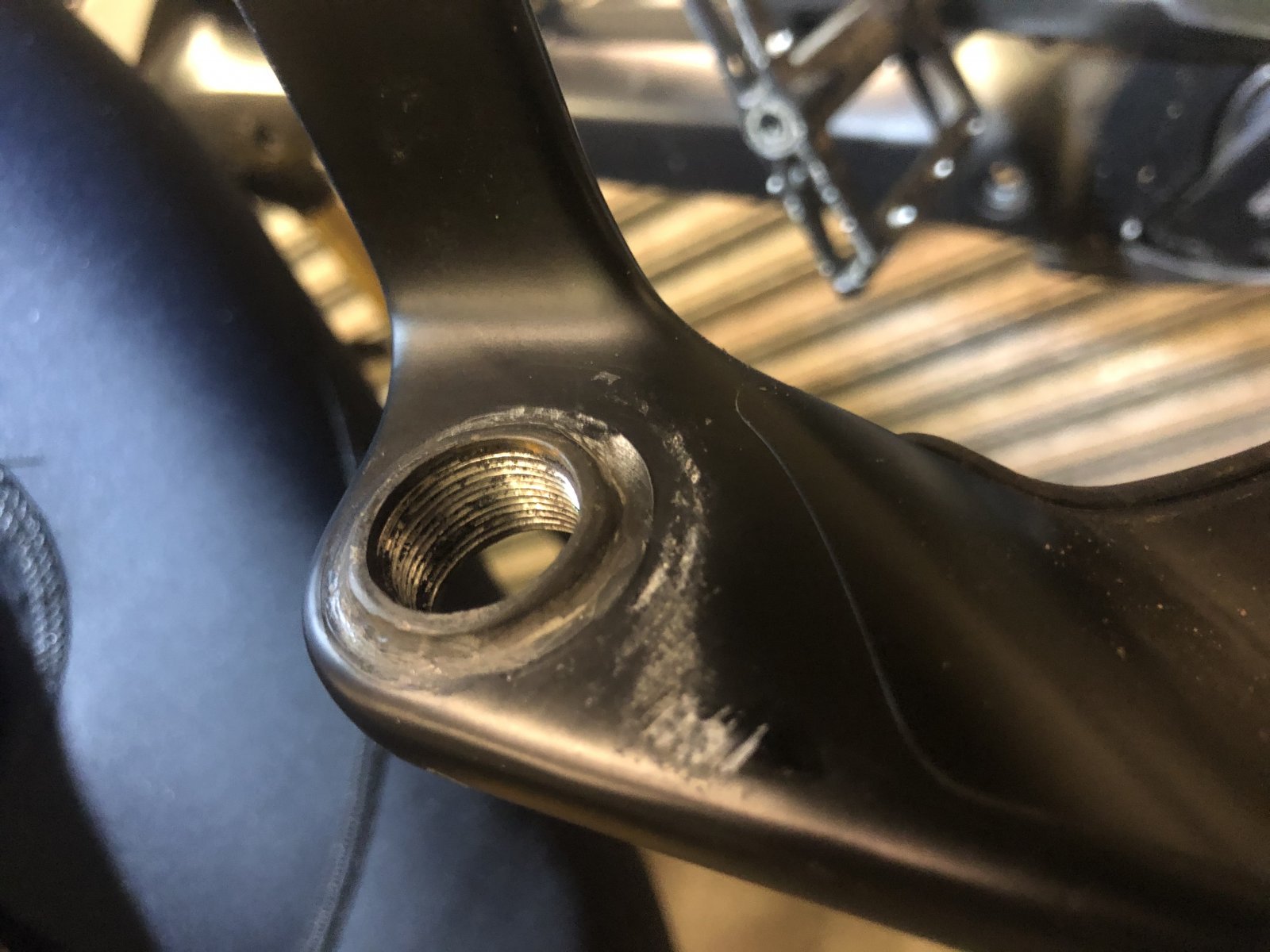

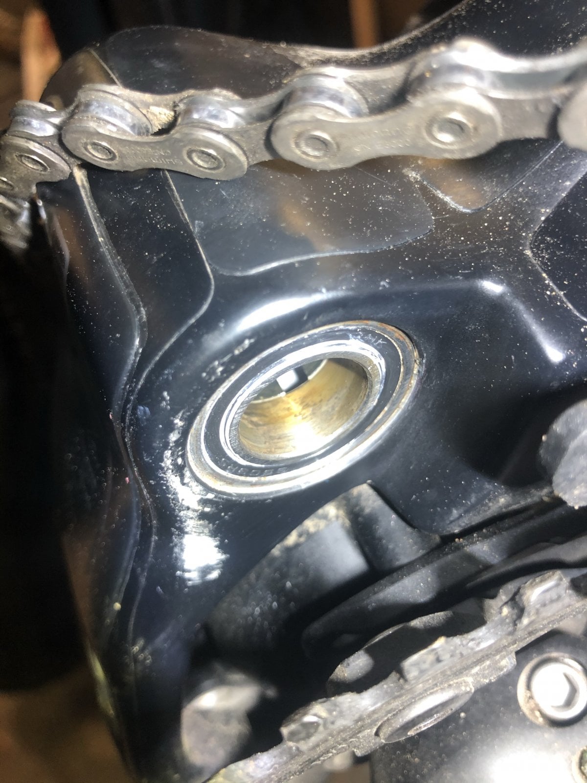

I followed the hint for the pivot axle earlyer in your post...cleaned and greased everything perfect. The noise is still there...
But when i did that, i recognized another frustrating fact.
Maybe this could also be the reason!?
In my opinion, there is heavy friction/rub off on the connection from main triangle to rear triangle, in the area of the main pivot axle. I could imagine, that the sound comes from that friction...CF on CF, on heavy load (force from weigh, motor)!?
The following pics can not discribe perfectly how it looks. In reality it is worse.
The paint on the rear trinangle is gone and the CF is rubbed.
Decoy Hinterbau - Google Drive
Whats your thougts?
I didn't have this on any bike before and in this short ammount of time.
Hi mate I had exactly the same fault as u.
I made a shim an put it in after the rubber seal on the drive side. There is not enough clearance or the bearings have moved through/in the frame causing the problem. I have not yet spoke to yt

Hi mate I had exactly the same fault as u. View attachment 28064
Hey Fatbap, thx for your reply. Can you tell me what measure your shim has? If you speak to YT, it also would be very interesting, what statement they have to this failure.
Hi mate the shim I made was only about 1mm I will speak to yt to see what they have to say an will report back

Update
I have spoken to yt regarding the issue with my frame an triangle rubbing I explained that I have made a shim/washer to adjust the clearance an this was the reply I had

Hello Peter,
thank you for your feedback!
It can sometimes be necessary to use those little washers/shims, to adjust to tolerances in the frame. We would have done the same in our workshop, to solve the issue.
As all frames are handmade, this can always be necessary.
It's good to hear that you managed to resolve the issue by yourself, already.
As everything is running smoothly now, we suggest leaving everything as it is.
There is no need to send the bike back to us.
