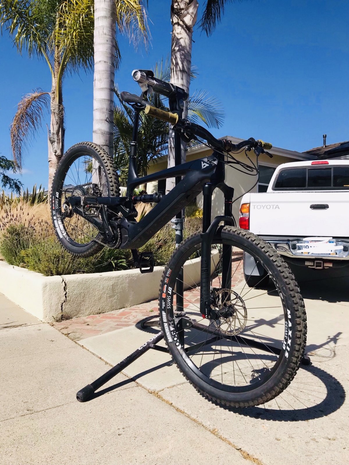

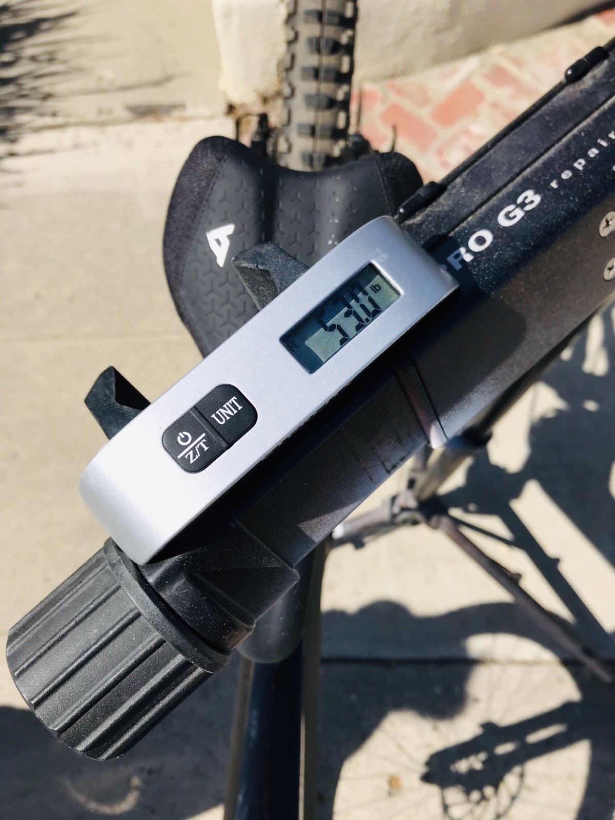

Nasty Nick
Dec 4, 2018
244
176
Ventura, CA US
Was it me? I’m at 55 with full coil, pedals, tubeless and a rimpact rear.

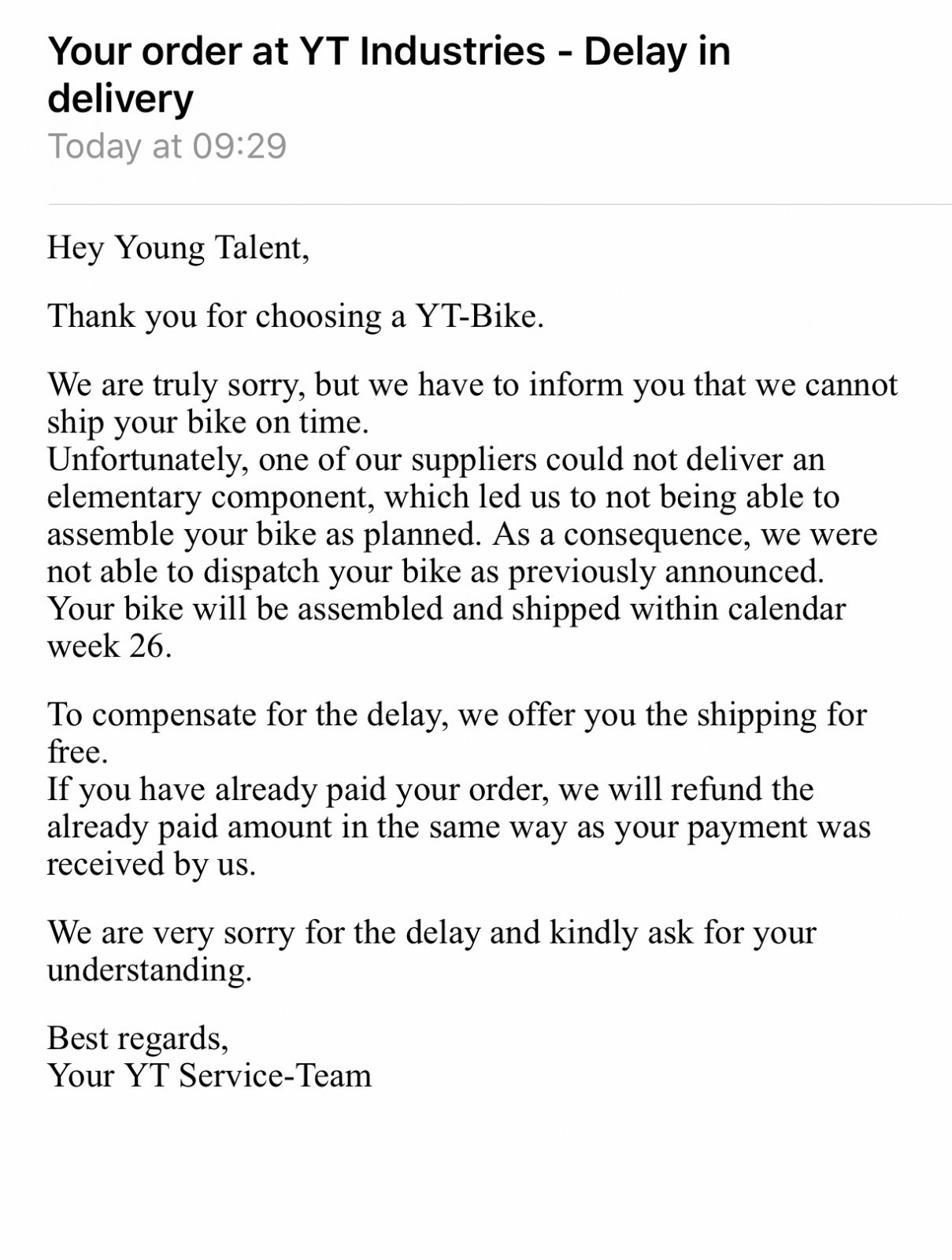

Gary
Old Tartan Bollocks
Mar 29, 2018
10,496
10,710
the internet
Hey Young Talent,
Thank you for choosing a YT-Bike.
We are truly sorry, but we have to inform you that we cannot ship your bike on time.
Unfortunately, one of our suppliers could not deliver an elementary component, which led us to not being able to assemble your bike as planned. As a consequence, we were not able to dispatch your bike as previously announced.
Your bike will be assembled and shipped within calendar week 26.
To compensate for the delay, we offer you the Bikebox for free.
If you have already paid your order, we will refund the already paid amount in the same way as your payment was received by us.
We are very sorry for the delay and kindly ask for your understanding.
Best regards,
Your YT Service-Team
Phone
Mail
Web
[email protected]
https://www.yt-industries.com
Odd.. That you're getting delivery for free and I'm being offered the box :unsure:
Maybe they’ve now run out of boxes?
Imagine being YT. In many ways this is a nice problem to have but only if you can resolve relatively quick so that you don’t burn your customers.
Still, I’d have more patience with them than some of the bigger manufacturers like Specialized. It’s important to support the small companies.
