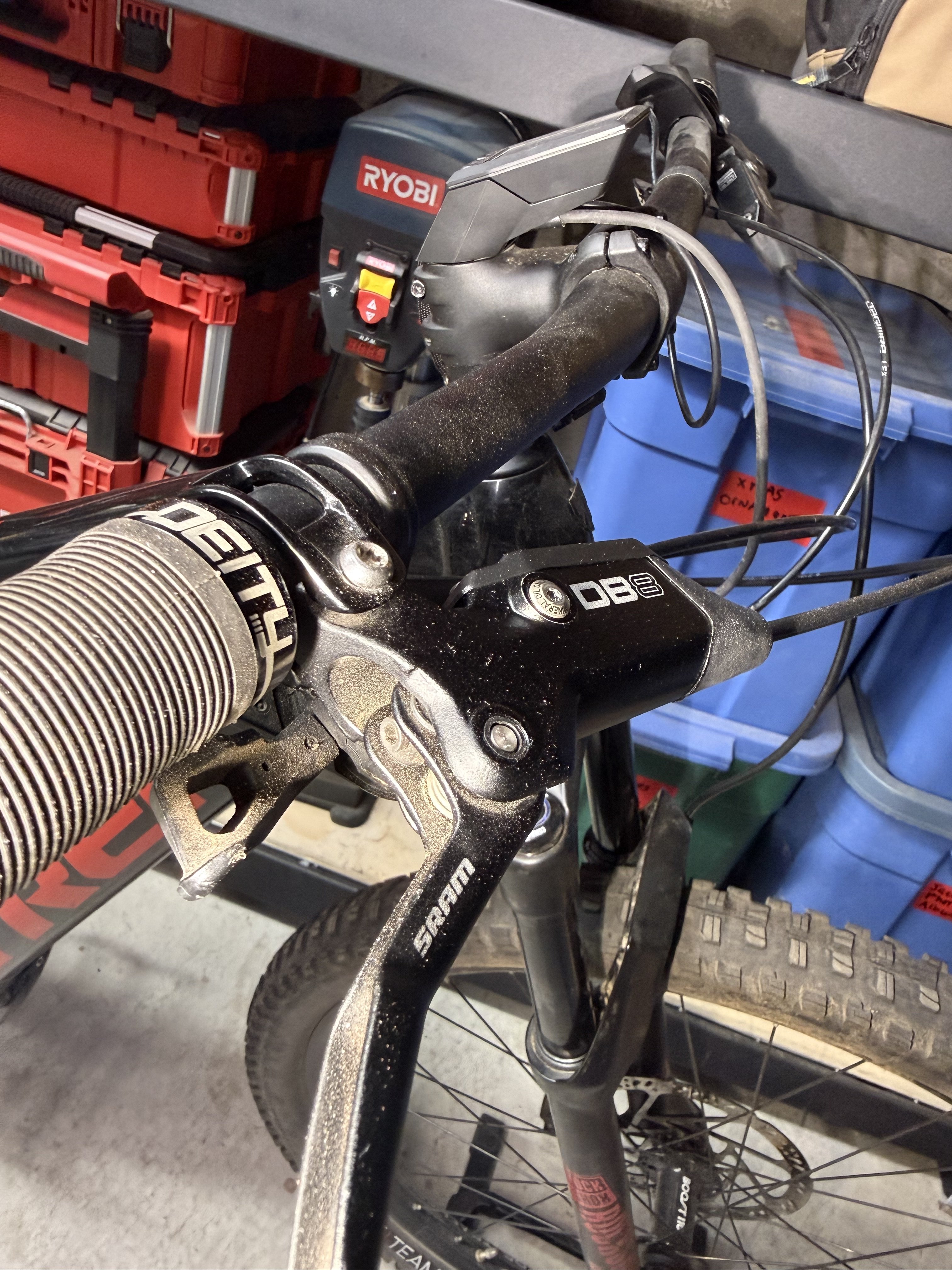

I was directed here by @Dax for some more information on the DB8’s.
This brake system came standard on a new Fuel EXE 8. My initial intention was to change these to MT7’s. (Full disclosure, I only have experience with MT7’s, MT8’s , Shimano XT, and some Tektro).
I’m glad I had an opportunity to use these DB8’s before I read the pros and cons in this thread. Good info btw. I was skeptical of the Sram braking system, especially for these mid to low-end brakes. (I mean affordable $$).
However after using them, and getting use to them, I found the power and modulation fairly good for a lightweight eMTB. I’m gonna keep these, but I wouldn’t install a set on my FF Rail. I might find that the stopping power and effortless feel just isn’t there. But I like the DB8’s on my lighter eMTB (Fuel EXE).
But…SRAM might be coming out with a new (heavy duty I assume) brake model in the next week or so. Either that or my source is unreliable. (Some guy that knows about this stuff).🤷‍♂️
