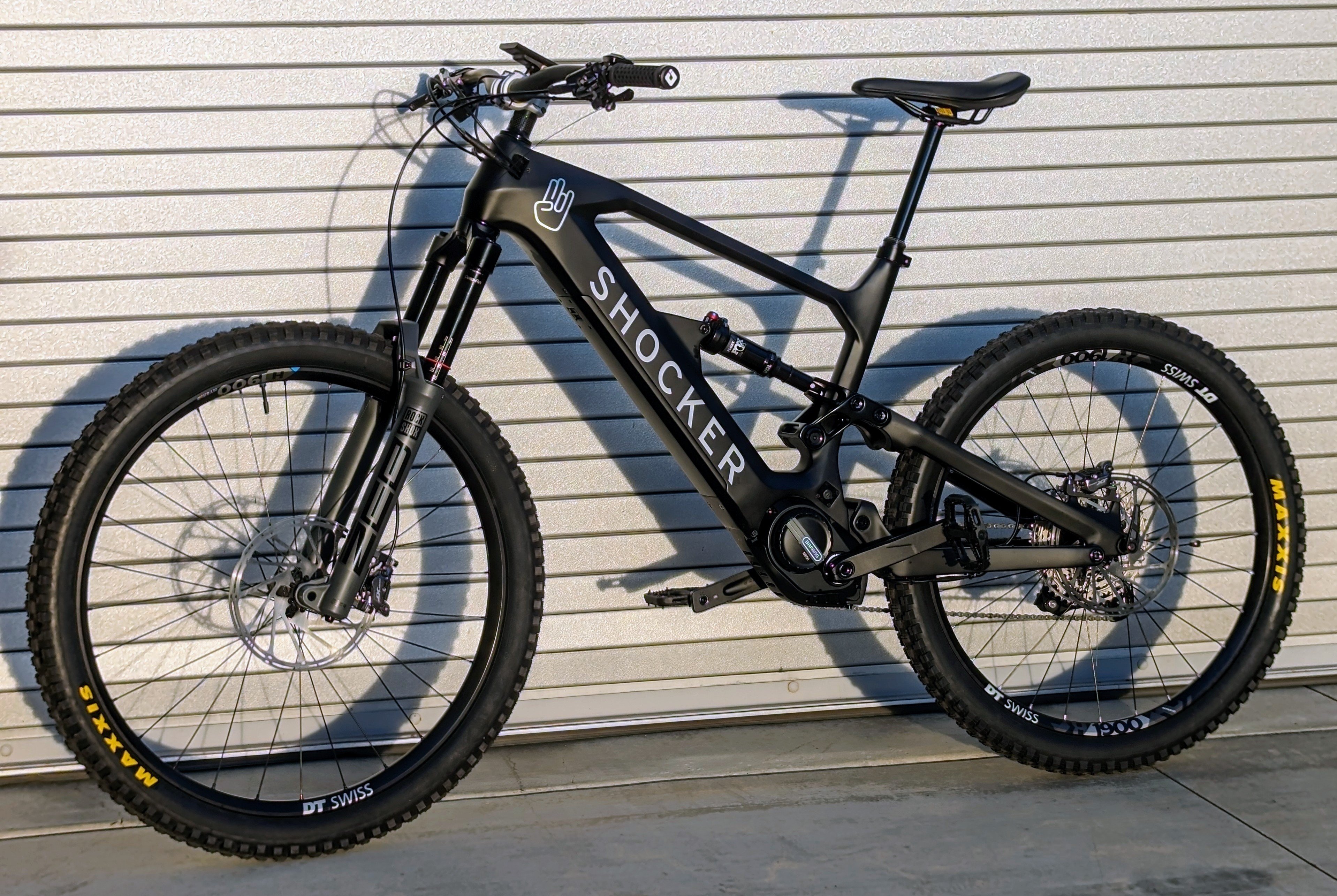

I know I know another black e10/m600 - yawn. But this is really a thank-you note. But first see obligatory photo.
The parts are nothing special - mostly what I could find on sale as the industry transitioned to the 2023 lineup. My goal was to use high performance stuff that I could find discounted.
But really this post is a thank you to all of you and in particular @thaeber, @Neeko DeVinchi and of course @Rob Rides EMTB for putting up with my dumb questions. Also thanks to @Waynemarlow and @ficorama for your battery chops.
Nothing really novel in the setup of my bike except I did plumb and wire in an in-line Magura hydraulic brake cut-of switch in to the stock Bafang harness that works like a charm. If anyone is interested in that, I'll post a how-to.

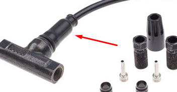

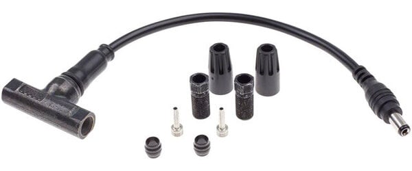

Ive been trying to find some information about these magura pressure sensors and not much can be found, even mailed magura but no reply!
Seems like a nice option to hide at least the rear one in the frame.
Is it possible to just slide off that piece and solder on some new wires? and how fast does the sensor activate? is it before the calipers clamp on the disc? i like to slightly hold a brake in crowded situations and at crossings so the motor doesn't turn on.

It works great. I have it inside the frame on the rear.
It's very sensitive and will work the way you want.
The unit only has two wires and the stock connector has three so you have to figure out which two on the harness to bridge.
I think the issue is finding one.

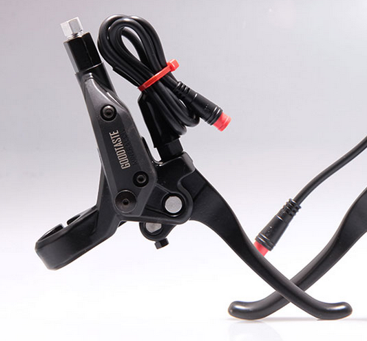

I've changed the cable on MT5E levers by taking out the pcb, craping off the glue and soldering in bafang ones, I'm assuming it's simmilar, just wanted to know if it's possible to solder the cable on the sensor directly instead of the wire
Had a set of chinese levers from goodtaste (bafang version) before they worked okayish but didn't feel right.
as for finding them, they seem to be available here and there when i look for the magura part nr instead of the name (0724344)
Bit stuck between deciding on MT5e with or the MT C5 with these pressure sensors.
I suppose you could solder directly. If I remember correctly there's a boot that covers up the electrical connection.

Did kinda look like that from the picture, Thank you:)
That looks stunning mate. Really nice. I almost wish I had gone the 'cheeb' route now, mainly to get the user-friendly motor system but I'd love to build a bike from total scratch too. Had I of known more about what was out there re decent chinese frames and motors I would deffo have gone that route. Enjoy bud!
Anyway Thanks ALL!
Vext
Very nice assembly! (y) What are the frame and wheels size please?
