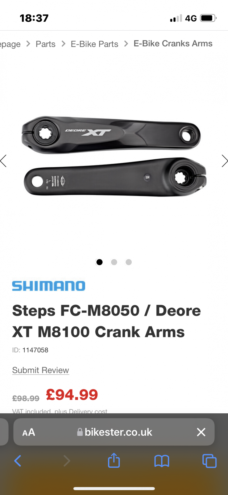

These are the cranks I bought

Those are not the correct crank arms for the ep8. You need FC-M8150's. Those are the crank arms for the e8000 motors. I would recommend not riding the bike until you get the right crank arms on there because a spindle failure will be extremely costly and potentially you're issue now.
Jul 30, 2021
59
32
Wales
Click on crank arms.
Are Hope doing compatible crank arms for the ep8 yet?

Just got the correct XT cranks and no issues whatsoever! 🤦🏻‍♂️ I do have a spare set of FC-M8050’s now though so if anyone here would like them at a really good price, let me know before I put them up elsewhere.
