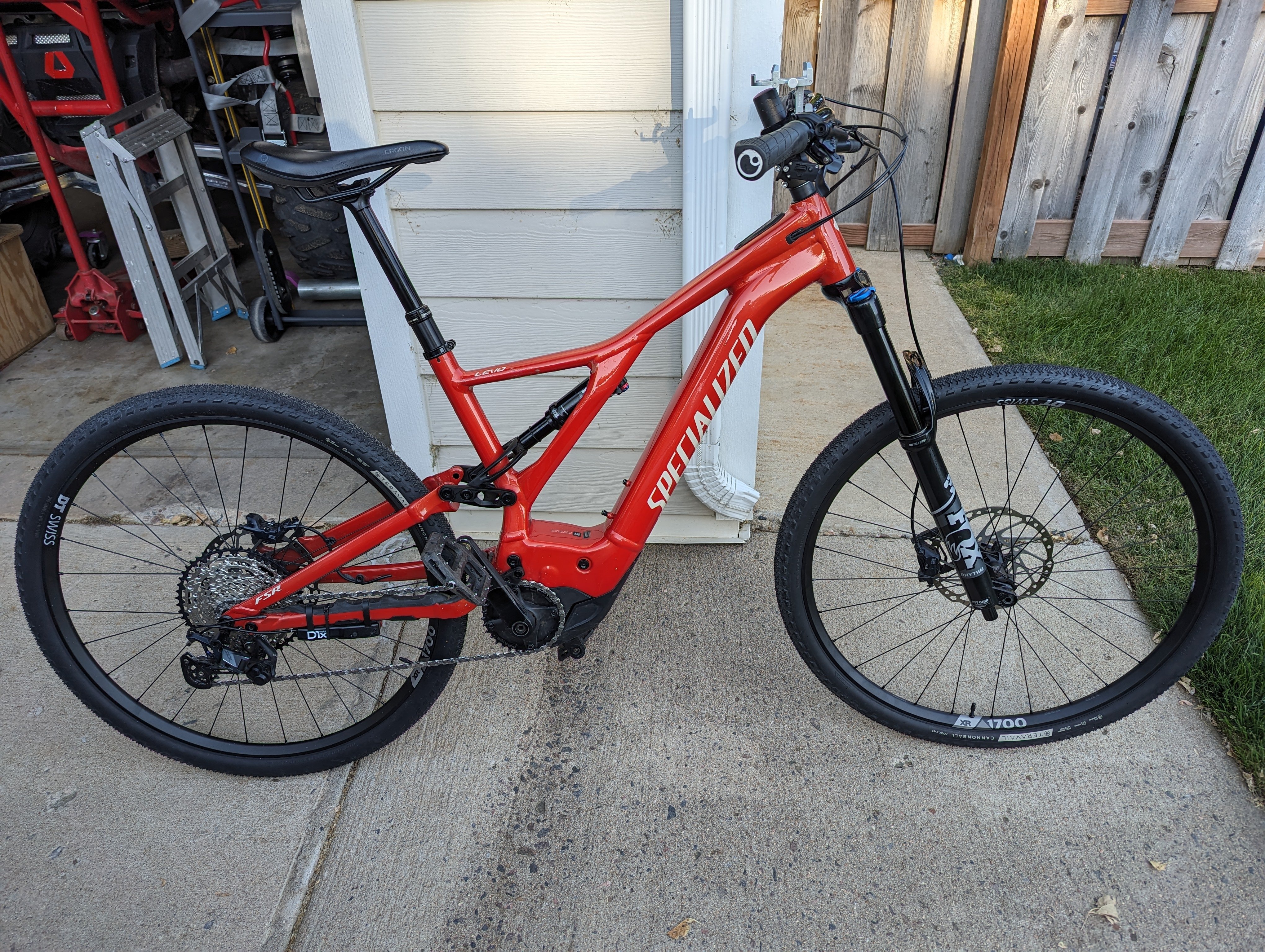

The final product:

I suppose if ever someone comes along with a question similar to the one I posted in starting this thread, that I should summarize my findings at least for them. Is the bike too slow to ride with roadies? That depends upon how fast your roadie friends ride and what updates you are willing to make to your bike. My experience:
With the new wheels and the stock 32T chainring, I could ride for hours at 18-20 mph, limited by my legs inability to spin any faster--adequate for riding with many friends who have road bikes.
Upping the chainring to a 34T I could spin the bike up 2-3 more miles per hour into the 22-23 mph range. While I missed the 32T when mountain biking, it was not that big a problem. However, I don’t think I would want to adjust to a 36T (the max) on our type of mountain trails. As an aside, while a Praxxis chainring will slip right over the spider, a Specialized requires removing the crank and spider, enough of a hassle one probably wouldn’t want to swap chainrings (along with the wheels) just to go for a road ride.
Finally, with a Levociraptor I have e-assist above 20 mph, making it a breeze to sustain the 22-24 mph speeds, plus I can easily sprint above those—I’m good to ride with the strongest of my roadie friends.
One final note, whatever changes you make or don't make, you will be back in the lead after the first couple of hills.:cool:
Hope that helps someone,
Jay
