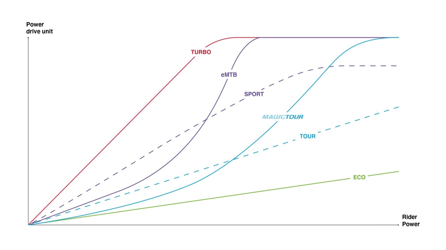

Have you got the new Tour+ mode? Its very similar (probably identical) power curve to the 'Magic Tour" mode below. I find it natural but also has full power on tap when you pedal hard.

That’s a good graph Rob , also called emtb light in the more recent trek bikes .
Rob Rides EMTB
Administrator
Staff member
Jan 14, 2018
6,258
13,693
Surrey, UK
Cheers 👍
EMTB Lite is different again! It doesn’t peak as high as Turbo / EMTB or Tour+ and maxxes out at 240% assistance. The former modes peak at 340%.
And to further confuse things, on the latest 2022 Treks, they no longer use EMTB lite and have the new Tour+ instead!
Would be great if Bosch supplied updated graphs with them all on!
For what it’s worth, on the new Bosch Smart, the Eco and Turbo modes can further be customised by the rider.
